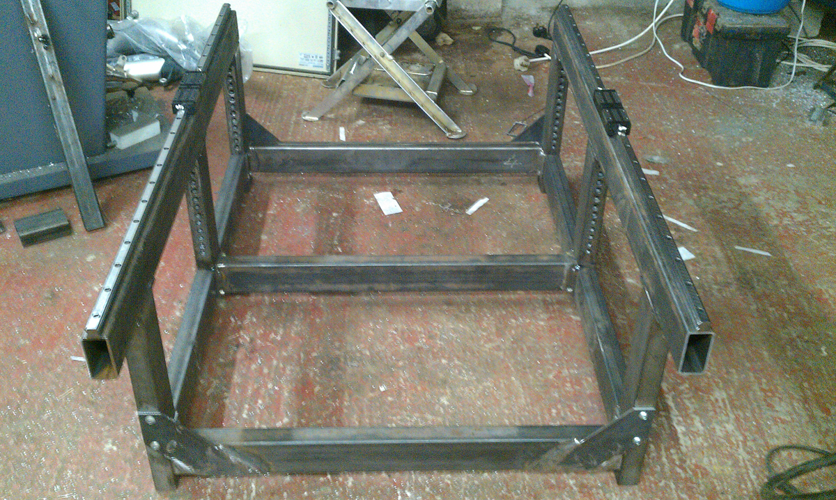

    You need to add some triangle plates to the corner uprights where they meet the cross brace, like the pic below. (Take no notice of rest of frame it's not complete here, still needs corner braces amongst other things)
    I can have mine going upwards because there's the adjustable bed which they don't come above but if your not having an adjustable bed then just flip them and take down towards bottom corners. They really stiffen the frame up and stop any sideways movement, they also make getting the sides square to the base very easy when initially setting up.
    Don't be put off with bolting, the frame in the picture is unbelievably strong but yet very easy to setup due to all it's adjustment.

    Junkie:
