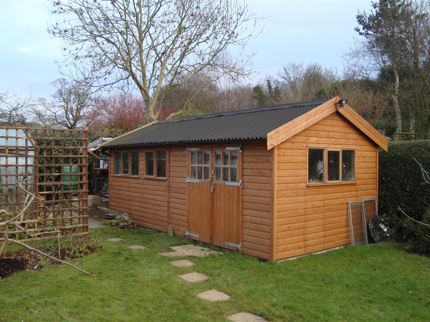

    This is the 20x10' shed / 'workshop':
Name:	DSC03436 (Large).JPG
    My Mum was persuaded to buy it because apparently it doesn't look like a shed! My Dad put insulated plasterboard all round and put polycarbonate on the windows to insulate them. It keeps the heat in well. Not had the heater on today as there's been a bit of sun and it's 23C in here. I leave a heater on very very low to stop the temperature going below about 5C and have a de-humidifier to make sure nothing rusts.
