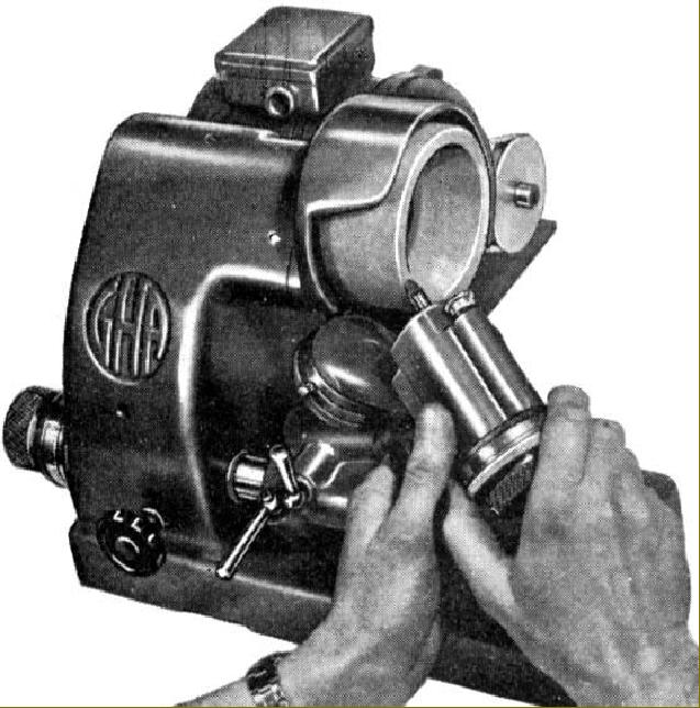

    Subject says it all really, I'm talking about these .
    http://www.ebay.co.uk/itm/10-Carbide...item1e5cf37e95
    after when a fragment has snapped of the tip...seems a shame to throw them away if they could be re-ground
    What type of wheel ....how can I get accuracy etc.
    Jig would not be hard. Use a keyless chuck mounted on a bearing. You could use a belt sander with one of the specialised grinding belts used for wood turning tools so that you would get a flat edge.

    These are ground on a Deckel or Alexandra single lip grinder, often called a Universal tool and Cutter grinder which they are NOT.
    Because the engraving cutters are made of micrograin carbide they have to be ground with a diamond wheel to get the finish needed.
    A simple jig could be made from a spin indexer and a small motor with a diamond wheel acting on a pivot so the wheel can pass the cutter as it swings at the correct angle.
    Sharpening these is a simple job once setup.
    I save mine and when i get about 5 or 6 chipped or blunt ones I do them all in one go, takes a couple of minutes per cutter tops.
    Because these are actually made from powder it stands to sense that the actual tip is very fragile and it pays to take a fine diamond file and take a swipe at the end to purposely put a flat on it before it chips it off.
    It's very, very easy to chip the tip on one of these, with a grinder it's very easy to grind them up or even grind a complete new one from round stock out of HSS, doesn't last as long as carbide as regards wear but is far more forgiving on fine work in soft materials.
