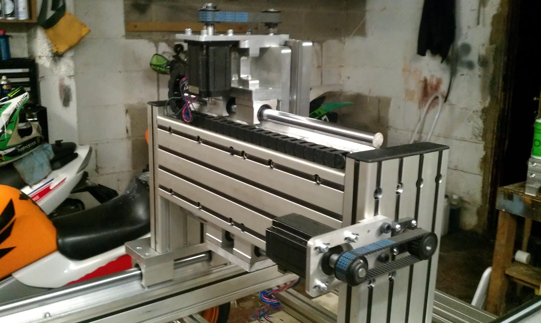

    If you want to push it a step further and increase it's versatilty thru gearing along with abilty to handle resonance better then think about using timing belts.? Thats how I build most of my Z axis.
    Here's a few pics of the one built for micheal marrino's machine, Micheal designed it mostly for his machine with slight guidance from me.

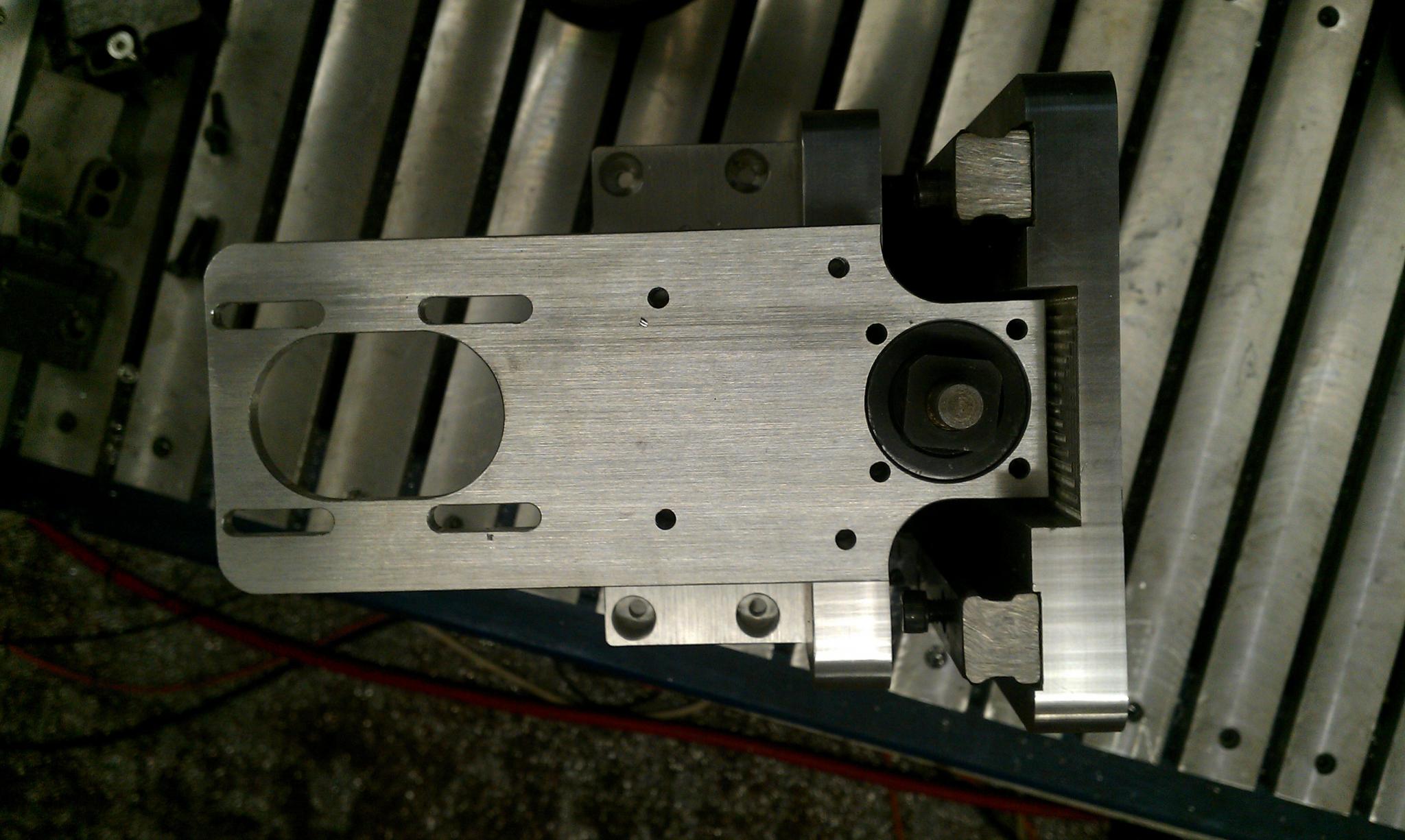

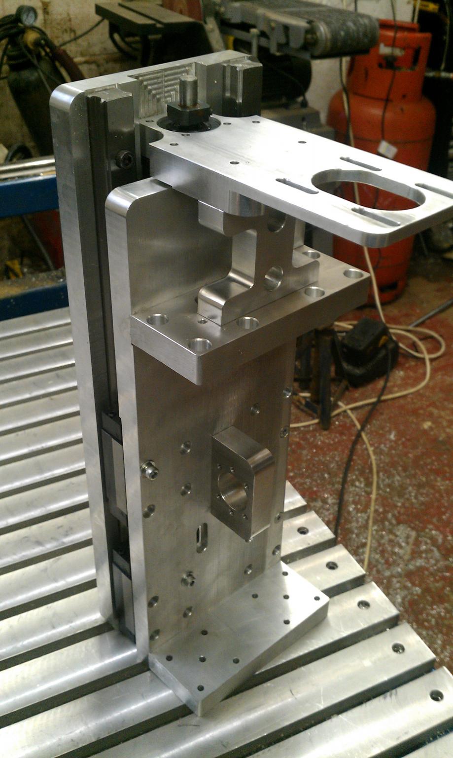

  5. Thanks again for your time and feedback.
    I now hope for this to be my last design.
    I am using 752 Drivers, 3Nm stepper motors, and TR16x4 Leadscrews.
    Best Regards.
    Well blow me down with a feather.
    I missed this the first time round (hence resurrecting the thread!) but that's almost exactly the X/Z setup I wanted to use (as in pulleys, orientation of steppers etc) though with profile rail and a fixed gantry..
    Was there a build thread on this? Any idea how it's been working out? Any design pitfalls to avoid?

    Hello Mad Professor, thankyou for your email, can you post the dimensions of your z-axis please, as I would like to build one like you have.
    With thanks
    jamie
