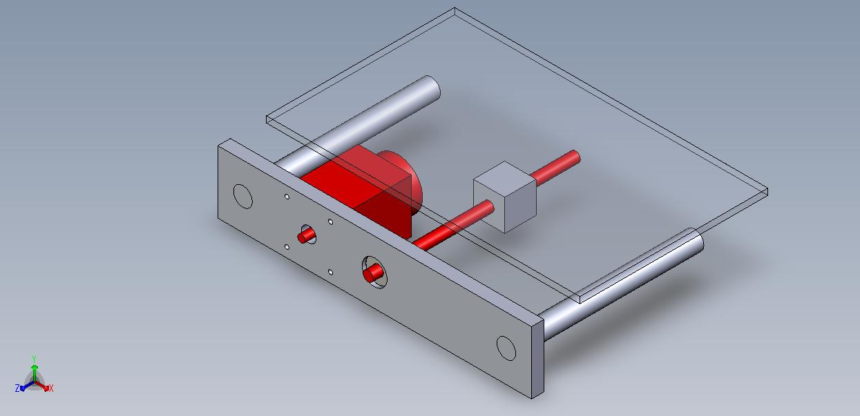

    Assuming there are no clearance issues with the table/nut, are there any disadvantages to mounting the motor under the table, parallel to the leadscrew?

    I'm hoping that a pulley system of some form would be suitable to belt-drive the leadscrew from that location.
    IMO I dont see any problems with mounting as drawn as long as the spindle protudes enough for a pully, and I think it keeps things tidy.
    Jim

    Quote Originally Posted by GTJim View Post
    You could mill a pocket in the shaft side of the aluminium to accommodate the pulley if there is not enough space.
    Pulleys are definitely good plan as they will let you change the ratio allowing the stepper motor to be put in the right region of the speed/torque curve. You can also swap them round to get more resolution if required.

    Jonathan: I think I'll be looking at some kind of pocket, but I still haven't started to research the pulley systems yet so I don't know what I will need in terms of size and clearance.
    AdCNC: Awesome build. This axis isn't fixed to the main structure though, it will be the X axis unit mounted on the Y axis.
    I used XL pulleys , but HTD 5mm pitch is better. I've found 1/2" wide best to be fine. It's best to use reasonably big pulleys to reduce belt wear. In general minimum 5 teeth engaged with belt.
    ADCNC: like the setup with the coolant etc...
  10. #8
    Fair enough, so until I settle on a firm number I'll pencil in 1 1/2" clearance from the surface of the mounting block for the pulleys. I suppose judiciously placed idlers would also help with increasing the engagement with the belt.
    Is belt something that can be shortened easily, or will I be confined to designing around what is available?
  11. #9
    Idlers shouldn't be necessary. I made the mount with the holes for the stepper motor slotted to allow tensioning the belt and different size belts and pulleys.
    You can't change the lengths of timing belts - the only way is to buy a different length. You can work out the length with something like this:
    http://www.sdp-si.com/cd/default.htm
    Also:
    http://bearingstation.co.uk/products/Belts
  12. #10
    Just to prove how slowly my brain works... by 1/2 wide do you mean I need to accomodate a diameter of 1/2", or it will protrude 1/2"(+bit sticking out for setscrew) from the mount?
