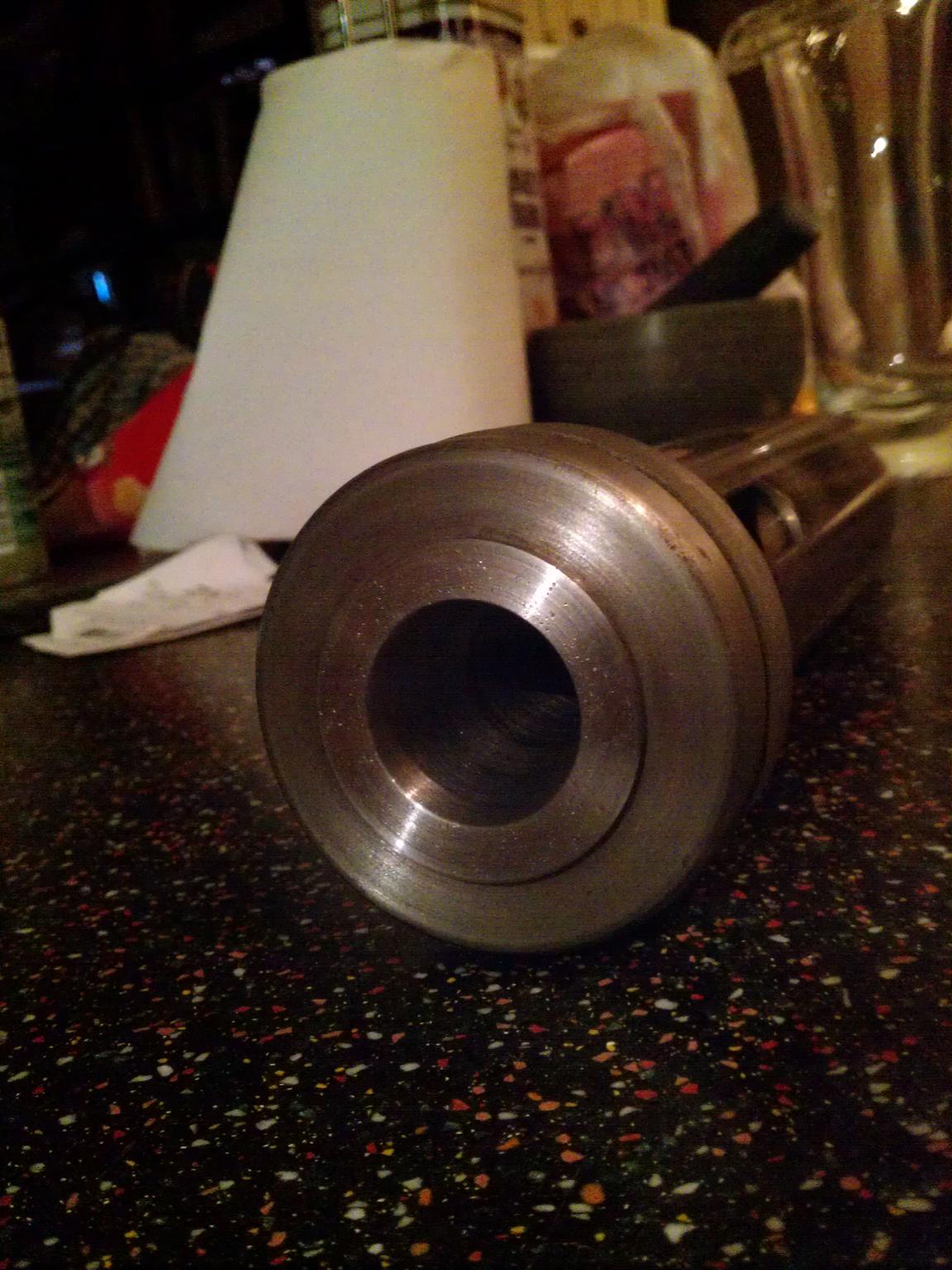

    Monday i had a chance to cast some Ali blanks for the pulleys. Got one machined up yesterday evening and the other tonight. The one on the left i will have to make again. Stupid me let go of the cross slide whilst plunging the pipe threading tool in for the ribs and it pulled itself in (tool slightly too low). This in turn locked and flung the pulley out of the chuck damaging it. I will use it for now so i can mock things up.
    Made these to fit 'J' section 5 rib belts, size 559mm long or 22" in old money. Belt will be here next week.
    looks good, shame about the slip, why is it always the last operation that goes wrong?
    when will it be working then?
    Good question? Time is very finite that i can use so it really is a question of slowly but surely at the moment. Need to do some casting which i will do over the weekend hopefully. I can then build the motor supports and remake the left pulley. Now i have these bits i can start laying the motor out and fix the top plate, work out how i'm going to fix the spindle in place as well as make a bush to lower it in the head slightly.
