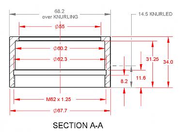

    Just got the Arboga u2508 mill and I am missing the spindle nut.
    Got an m62x1.5 nut from a supplier in order to fabricate the collar but the m62x1.5 isn’t correct.
    Can anyone confirm the thread pitch ?
    Or better still has anyone got a spindle nut for sale or know where I can source one or have one made.
    Thanks in advance.
    Jon
  3. #33
    Hello
    it is correct the m62x1.5 isn’t correct, the name is M62 but the thread is SAE 20, wierd i know
    i bought a nut from suplier here in sweden for about 1 week ago and they told me this, and i have also checked this for about 5 minuts ago..=), i will come back with e-mail and what company you can buy the nut, one moment..=)
    but it is bastards out there so to be sure, buy i thread checker tool and try the SAE 20 on the spindel threads.
    the SAE 20 is very similar to 1.25 metric threads, so i think that will work to, but it is SAE 20

  9. #37
    I payed 95 Euro, but if you go to a macine shop with the drawins i added the can easy make a nut for you

    Thanks buddy.
    I actually turned a spindle nut and cut the threads myself on my lathe. Knurled the upper portion to make it easy to fix/remove.
    Turned the washer/collar too.
    Actually an easy job and it works a treat.
    Many thanks for the drawings and if anyone is stuck I’ll turn and thread a nut for you.
    I’m also Well through with building a 240v to 415v phase converter to run it, an interesting project on its own.
