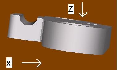

    Ok. I can mill 2D objects no probs.
    I wanted to mill a simple semi circle slot along the horizontal plain of the material. The circular slot is to be 120mm long / 11.113mm deep

    This picture is just an example I made so you can see what I am trying to do. I have milled the object all apart from the slot on the left.
    What is the simplest way to do this ?. I have today tried to create a 3D version in FreeCAD software, but when imported to Cambam, I have no Idea what to do with it. Especialy as I only want the slot. Maybe there is a way in Cambam, that lets me do this without getting into 3D ?

  2. whats the radius of the slot? or is it a true semicircle so diameter = 22.226mm (spurious level of accuracy aside), or 7/8". Maybe you can find a 7/8" ball nose cutter.

    Hi irving,
    The Dia is 7/8" . I have 6mm ball nose cutters. I can't fathom out how to cut a semi circle slot. Cambam just creates a rectangular pocket. Obviously I am missing a vital bit of info. My DOC is only 1.5mm in aluminium

  5. Edited my post, but not quickly enough.. got my radii and diameters confused (its the heat). Don't think cambam can do that. If you can find a 7/8 cutter and get it in your spindle the doc isn't an issue, just go round and round.

    Hhhmm chinese spindle. I dont know if the speed will cope too low with such a large endmill . If Cambam wont do it, what software will ?
    Or maybe something inside Mach3 ??

  7. #6
    But you aren't trying to cut a semi-circular slot, you are trying to cut a semi-circular slot with something at the ends so the software knows what to do when it gets there. The tool needs to know where it can overhang.
    Given half a chance any self respecting software will not view this as a pocket sinking exercise. That way it can cut the outline when it reaches the end. Simples.
    The easiest way is to write a quick program that spits out a G code, that way you can be sure you get a finishing cut that increments to the face rather than the depth.

    OK thx.
    I just tryed the trial version of Meshcam. It was simple to do (on the pc)
    Pitty I cant get Cambam to do it though.
    I would draw the slot as a line longer than you need draw a semi-circle to the size you want and extrude the semi C along the line, create your tool path using a bull-nosed cutter, using center line of where you want to put slot across the part, use this as XYZ = 0 set your cutter & g-code to run from there, it should cut a semi-circle across the part.
    Phill
    This is the bit, Im not sure how to do ?
