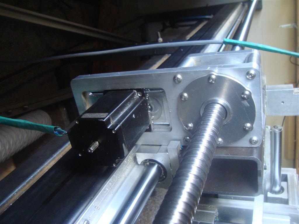

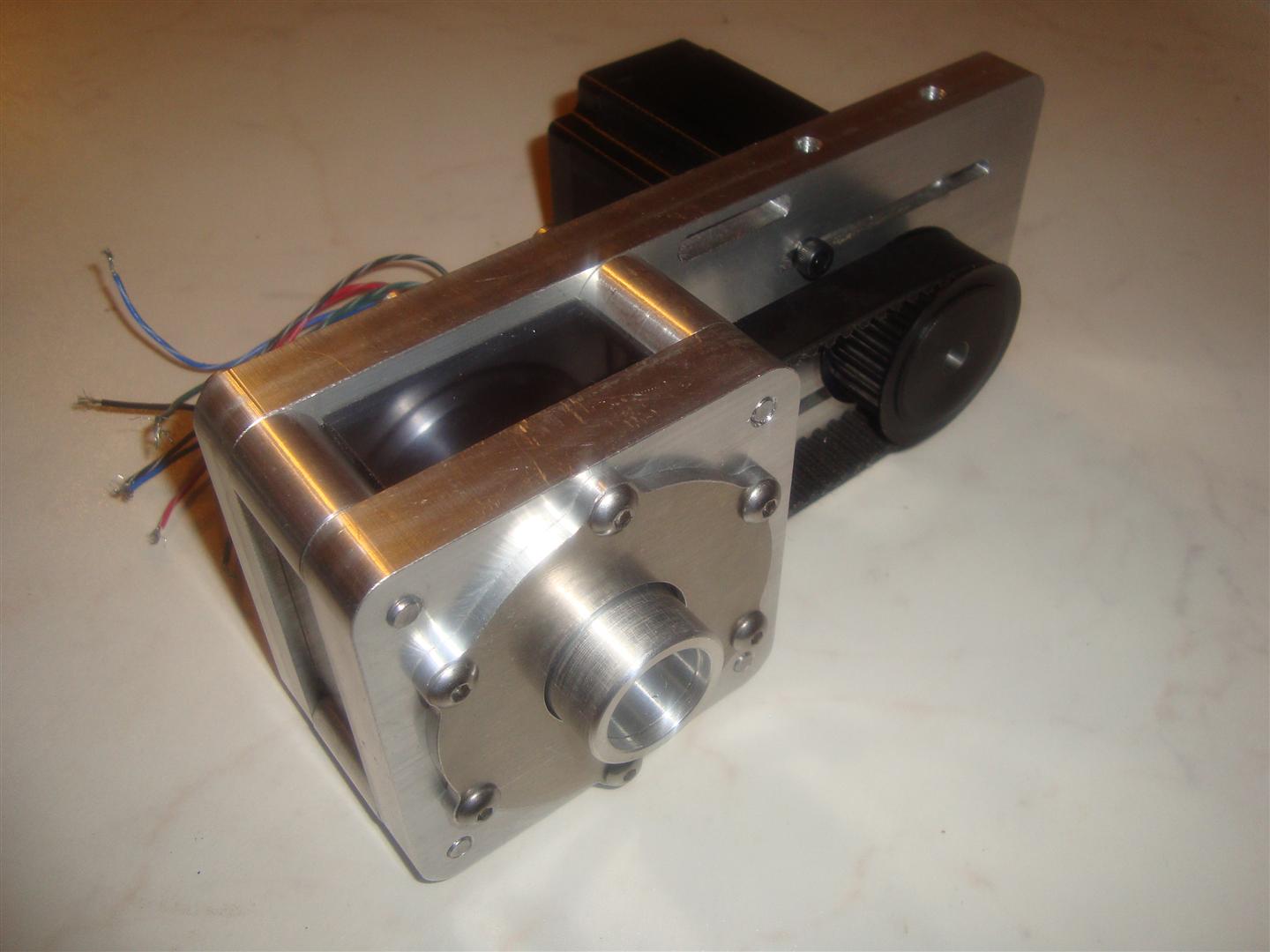

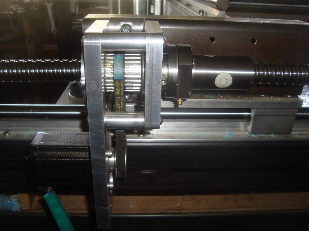

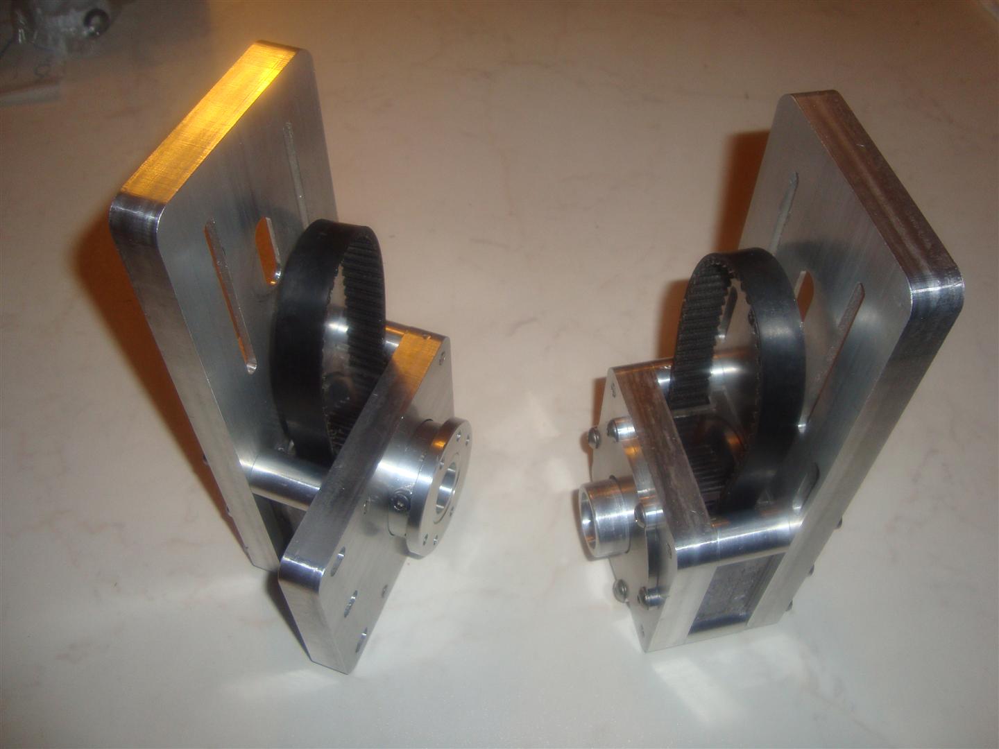

    Quote Originally Posted by Tenson View Post
    I can get 2510 ballscrew from Zapp, so can you make a rotating ballnut assembly for that Jonathan?
    Yep I can do any size, that's what I'm using:
Name:	DSC08517 (Medium).JPG
ID:	5559Click image for larger version.
Name:	DSC08519 (Medium).JPG
    If you want 2510, although I think you'll be fine with 1610, you'd be much better off getting it from linearmotionbearings2008 on eBay. He sells 1605,1610,2005,2505 and 2510.
    This is the version I did which is suitable for 16mm or 20mm screws:
