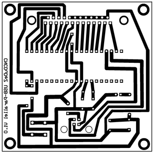

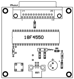

    Please find below the PCB layout.
    Size of PCB is 75MM * 75MM
    Click here to download the Hi Resolution images: usb-par-hi-respcb600dpi.zip
    These are 600DPI JPG and need to be viewed and printed in Adobe Photoshop for an exact scale.
    Also included are postscript files as well.

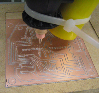

    We are also releasing the PCB Layout in Gcode for people wanting to mill their own.
    Milling PCB below with 0.2mm engraving bit.

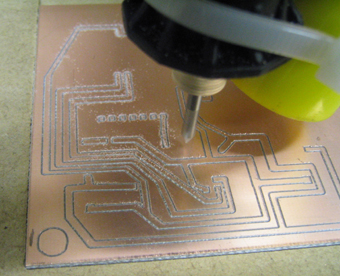

    Drilling PCB below with 0.8MM drill bit.
    Click here to download the Gcodes: usb-par-gcodev1.zip
    Inside this file are two Gcodes, one for the Milling and the other for the drilling.
    Components:
    1 * 25pin socket
    1 * 18F4550 Chip
    1 * 40 pin Dip Socket.
    1 * USB Socket
    1 * 20mhz Xtal (the Pic internally clocks this upto 48mhz)
    2 * 22pf ceramics
    1 * 4k7 resistor
    1 * 1k resistor
    1 * LED
    1 * 0.1uf ceramic decoupling cap.
    1 * 0.1uf electrolytic capacitor
    1 * 22uf electrolytic capacitor
    1 * little tactile push switch for resetting Pic, not really needed.
    And a PCB about 75mm * 75MM

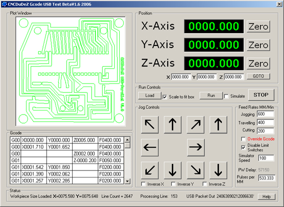

    Application:
    Please Check the USB-Software link to download our Beta Application: cncdudezusb17.zip
    Setting up and testing:
    After you have assembled your new Interface, simply plug in a USB lead and Windows XP will automatically detect the Interface as a USB Hid Device.
    You can confirm this by checking in device manager of your machine.
    Now connect your Printer Port cable from the Interface to your controller box and you are ready to go.
    Run up the software, set up the pulses per MM parameter and try out the Jog.
    Please make sure you read the HELP File first.

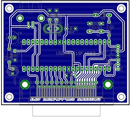

    I've done a (very) quick hash at a schematic - with a few revisions:
    1. The PIC to be programmed in-circuit with a PICkit2 or PICkit3. You'll need to make sure your CNC device is unplugged when you do this (since it pings a couple of the pins), and also don't press the switch when you do it!
    2. The >400nF capacitor has been included
    3. The component numbering has been altered
    The new layout is smaller, and doesn't have any wire jumpers. However, it is designed primarily for photo-etching (the .zip file contains the PDFs for the schematic, layout and PCB itself, at a 1:1 scale - I use the latter for my photo-etching of boards).
    If you want to remain faithful to the original design (i.e. you don't need the ICSP header), then you can replace D1 with a wire, and remove PL1.
    If this treads on anyone's toes, please let me know.

    I did not see any connection of 5V and ground connection into the pcb design..
    But in the schematic there is 5V and ground connection,
    Any one please help me...
  7. Quote Originally Posted by lkanta View Post
    see here: bottom two connections on right hand set of connectors.
