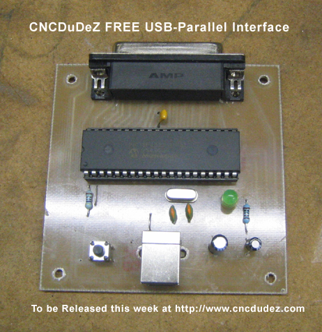

    Do you drive your Motor Controller usually via the Printer Port?
    Well now you can convert it to USB with this very simple Circuit below. We supply the PCB design FREE, the Firmware FREE and the Windows Application FREE
    You just build it, use it and let us know of any improvements we can make.
    To compliment our new FREE Beta USB Application (Shown Below) along with new Firmware, we are going to release a very simple circuit that people can build themselves that will let you control any parallel port stepper motor controller via USB.
    With this simple circuit and our Firmware you will be able to simply plug it into your existing Controller box and using our software, run your Gcode via the USB Port.
    The reason this will work with any existing Controller box that uses the parallel port to control the Clock and Signal lines is because we will release standard Firmware that will cover different pin configurations as needed.
    Find below the first picture of version 1.0
    As you can see, this is not going to cost you a lot of money to make!!!!!!!!!

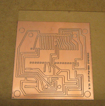

    Please find below the PCB layout.
    Size of PCB is 75MM * 75MM

    We are also releasing the PCB Layout in Gcode for people wanting to mill their own.

    Milling PCB below with 0.2mm engraving bit.

    Components:
    1 * 25pin socket
    1 * 18F4550 Chip
    1 * 40 pin Dip Socket.
    1 * USB Socket
    1 * 20mhz Xtal (the Pic internally clocks this upto 48mhz)
    2 * 22pf ceramics
    1 * 4k7 resistor
    1 * 1k resistor
    1 * LED
    1 * 0.1uf ceramic decoupling cap.
    1 * 0.1uf electrolytic capacitor
    1 * 22uf electrolytic capacitor
    1 * little tactile push switch for resetting Pic, not really needed.
    And a PCB about 75mm * 75MM

    small portion of the device descriptor.
    3. USB Reset: Reset the device again.
    4. Set Address: The host assigns an address to the
    device. >> this is where the de dum sound occurs
    5. Get Device Descriptor: The host retrieves the
    device descriptor, gathering info such as
    manufacturer, type of device, maximum control
    packet size.
    6. Get configuration descriptors.
    7. Get any other descriptors. >>during 5,6,7 Windows refines its understanding of the device, this is where you'll see 'Found generic HID' followed by 'Found <some device class>'
    8. Set a configuration. >>this is where windows tries to load the required software
    Since the ProductID is expensive the specifics are often in the later configurators, using a generic ProductID at the top level.
    If you are unable to get Windows to recognise the USB device, you could try downloading a USB diagnostic tool. Does the device appear in Device Manager as an 'Unknown device' with a yellow question mark? If so then Windows is not recognising the descriptor as one of the generic classes. If it doesnt appear at all then the USB controller isnt able to do the initial reset/enumeration (steps 1 - 3 above) and Windows will never know the device exists. If this is the case then the problem is in your hardware or software (including the Microchip USB libraries) and without a full scale debugger and source code and the knowledge to use it there is little anyone can do to help.
  12. The Following User Says Thank You to irving2008 For This Useful Post:
  13. #9
    I just had a quick look on www.usb.org and it seems you can now get vendor ID numbers for a mere $2k.
    Not as bad as I remembered it but they've now added a clause to say you can't sell numbers on. Too late guys :naughty:
  14. The Following User Says Thank You to Robin Hewitt For This Useful Post:
  15. #10
    If you're using a Microchip product (which this is), then you can apply for a PID and use their VID - although if usb.org has changed their rules, then I don't know if it's still applicable (I did download their application form a week ago though, so it's not been removed - but then I did find a direct link to it off another website, and they may have not removed it; only their links to it).
