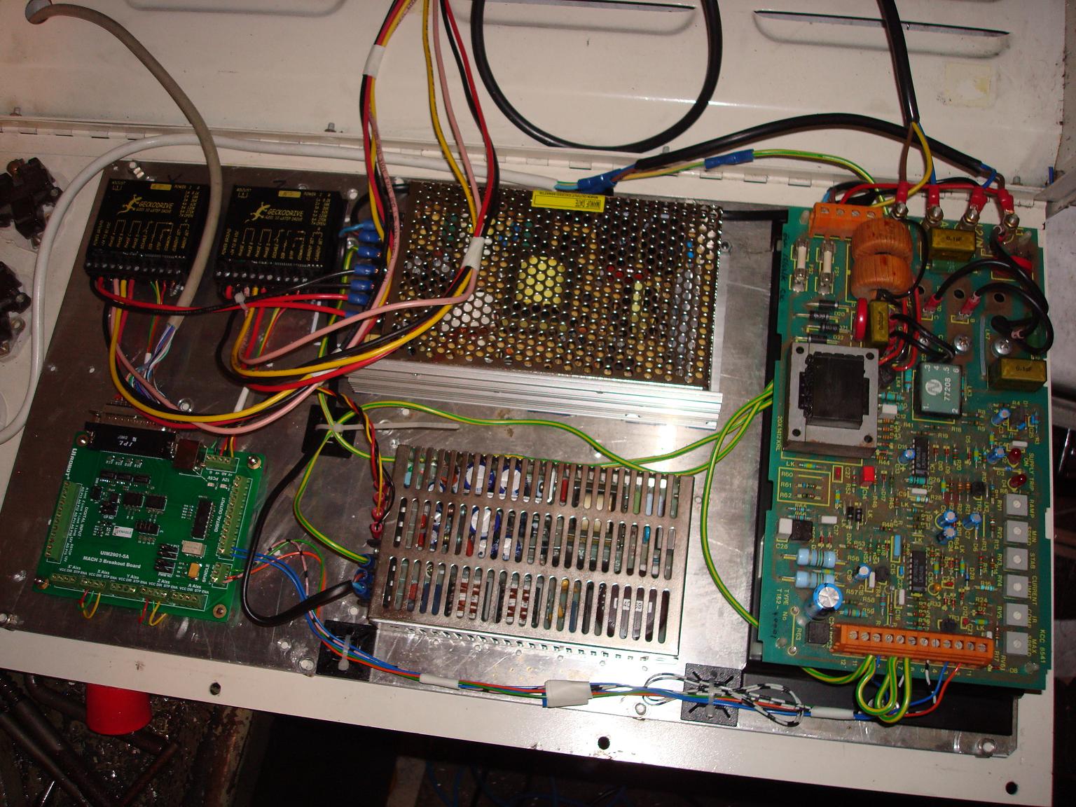

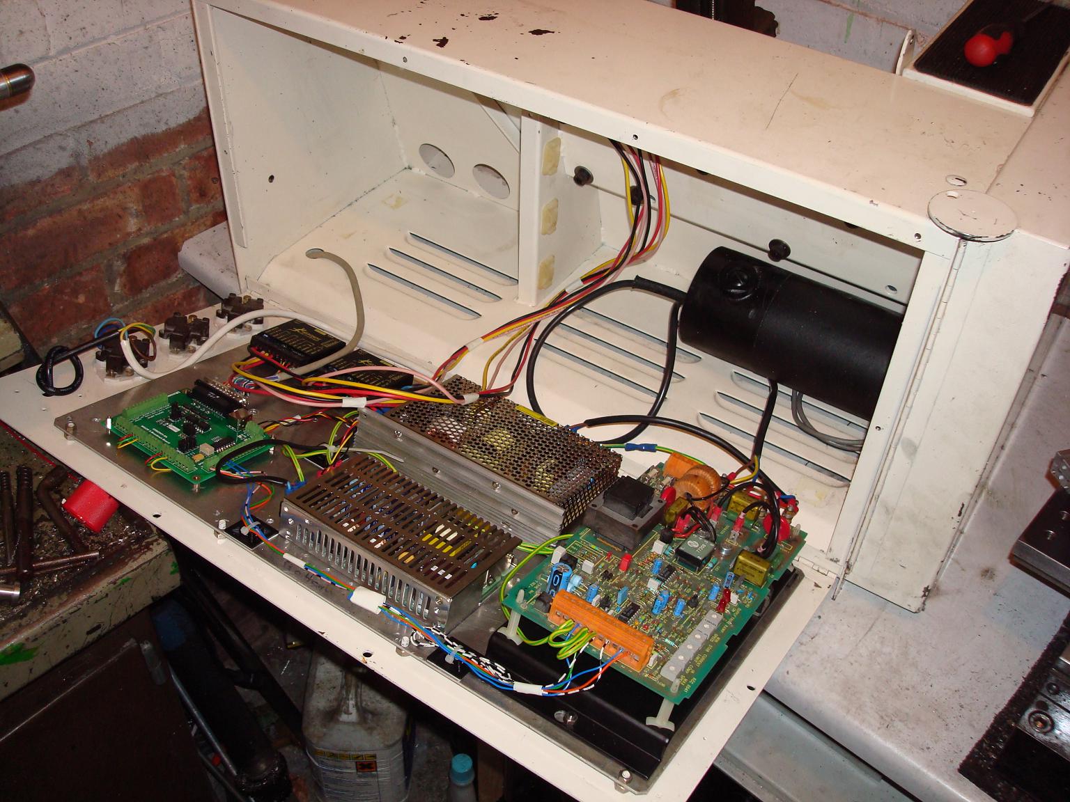

    Yo! Cooliced!
    I completely re-wired. Wiring was not good enough for me... found a few shorts here and there...
    I also replaced the BOB and the spindle board. I could not get it to control the spindle under Mach3. Now the speed of the spindle is fully controlled by Mach3.
    Also replaced the parallel cable, it is now properly solder to a connector. And replace the PC power supply with a proper one.
    I'll post some pics as soon as I got time to flit it round and open the back... ;-)

    Here are some pics of the electronic... Gecko drives!
ID:	6203Click image for larger version.
    As you can see, the door is resting on the bed of my AUD....
