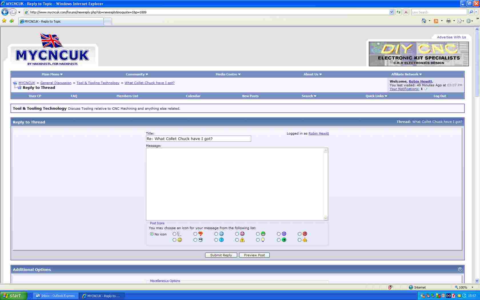

    Use the "Post Reply" button or the "Go Advanced" button, the box below the thread is a quick reply system. :)
    Pressed post reply, still no smilies GLUM
