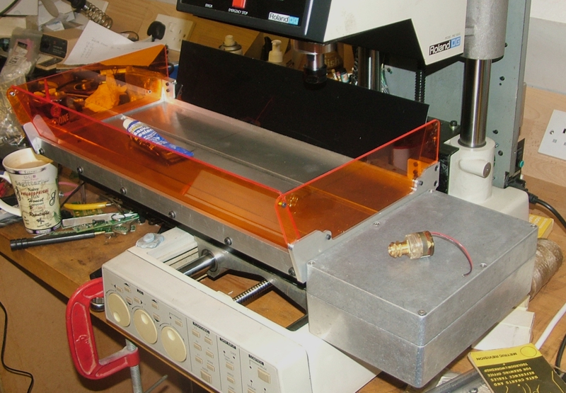

Robin, a sudden thought. Would it be viable to make 3axes cuts and having made a frame for the item being machined, flip it through 90degrees so as to cut each face, having prepared suitable new drawings for each face's cutting pathway. Lastly where have all the CAMM 3's vanished to?

Thanks for suggesting Cut3D from Vectric, it looks like the sort of program that would work for me. I have also taken a look at Mach3, and I have to admit that I haven't a clue where it starts from. Do you have any idea what sort of interface will work with Cut3D? Do the ex educational machines such as Denford Novamills, Boxford 190's, or the Conect series have the brains to talk to a modern program, or is it only the much later models that will speak to the modern programs?
I had a long look at a Roland MDX-40 which was being employed to cut wax patterns for jewellery, the finished items were very good, but the machine is not minded to cut any sort of metals.

Taking it from the beginning you need CAD, then CAM, then a controller for a CNC machine.
Cad you know about, CAM is a program like Cut3D which turns the drawing into G code which is just a text file containing way points, go to xx go to yy etc.
The controller in 95% of home shop cases, Mach 3, then reads this and tells the machine where to move. Very simple explanation.
The Denfords, Boxfords, Connect series will talk to Mach once the electronics on board have been upgraded.
Can't really advise you on the models as that's not my field but I would have thought a wheel rim would be better turned to shape and then the spoke placements punched in using a small lever punch and a couple of dies in relation to a 4th axis or dividing head for the indexing.

Your average CNC mill cuts what we call 2.5D. It's a bit like 3D except you can't cut below an overhang. If you only need a tiny bed, have you considered CNC'ing your lathe with a vertical slide?
The CAMM-3 is distinctly weird, not recommended, I only bought one on a nostalgia trip.
