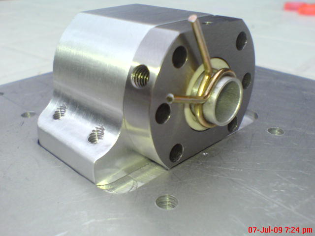

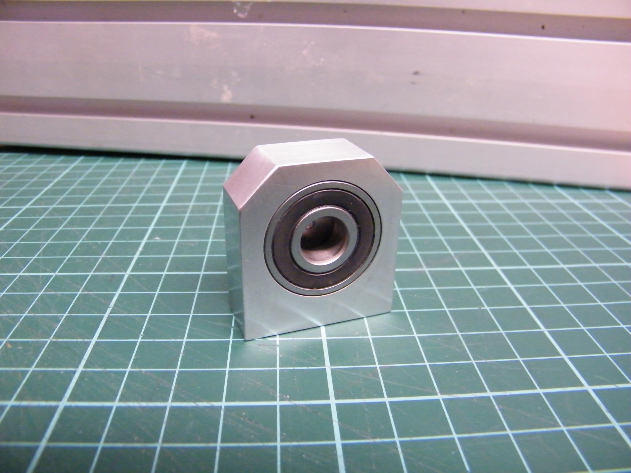

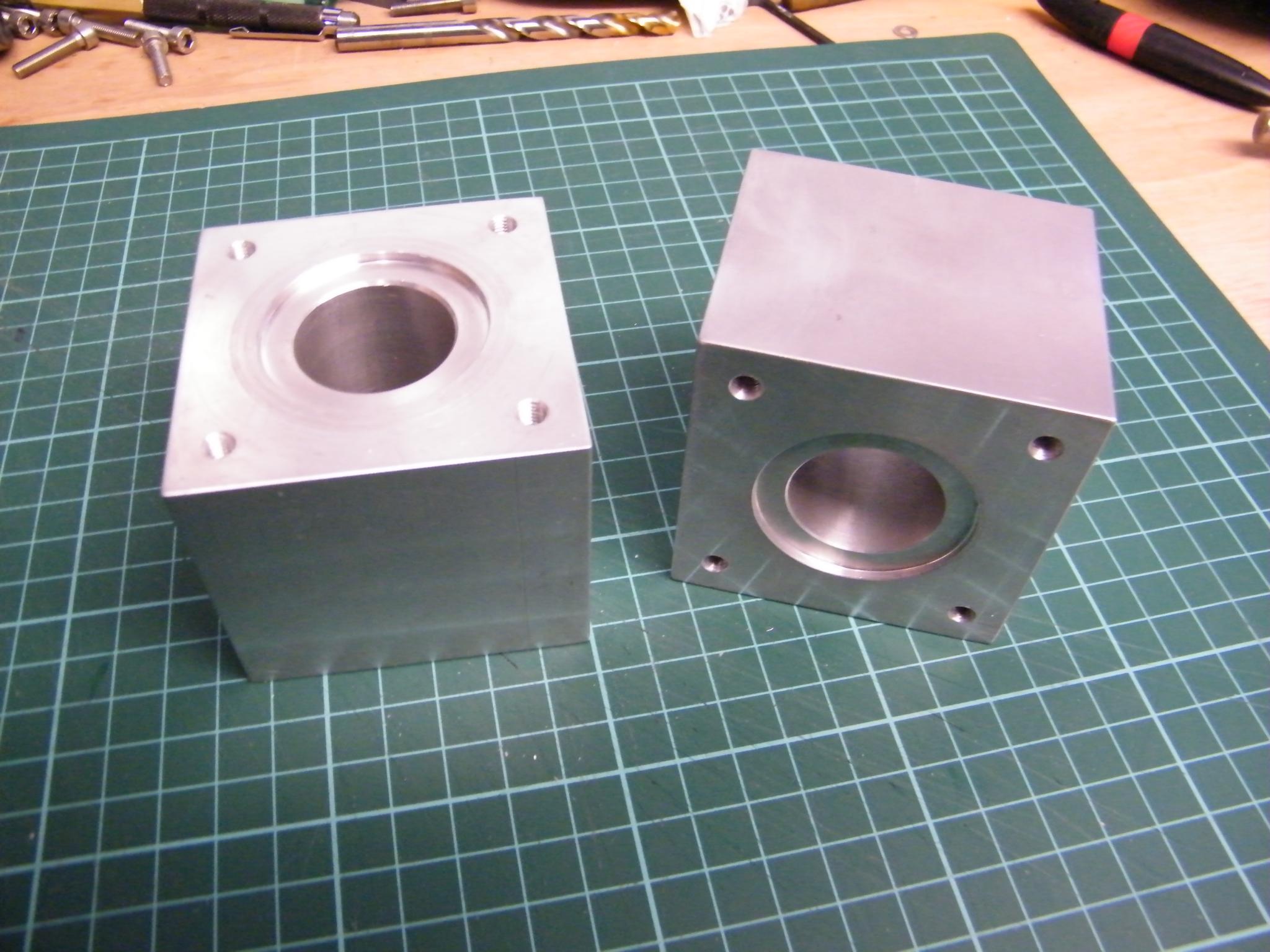

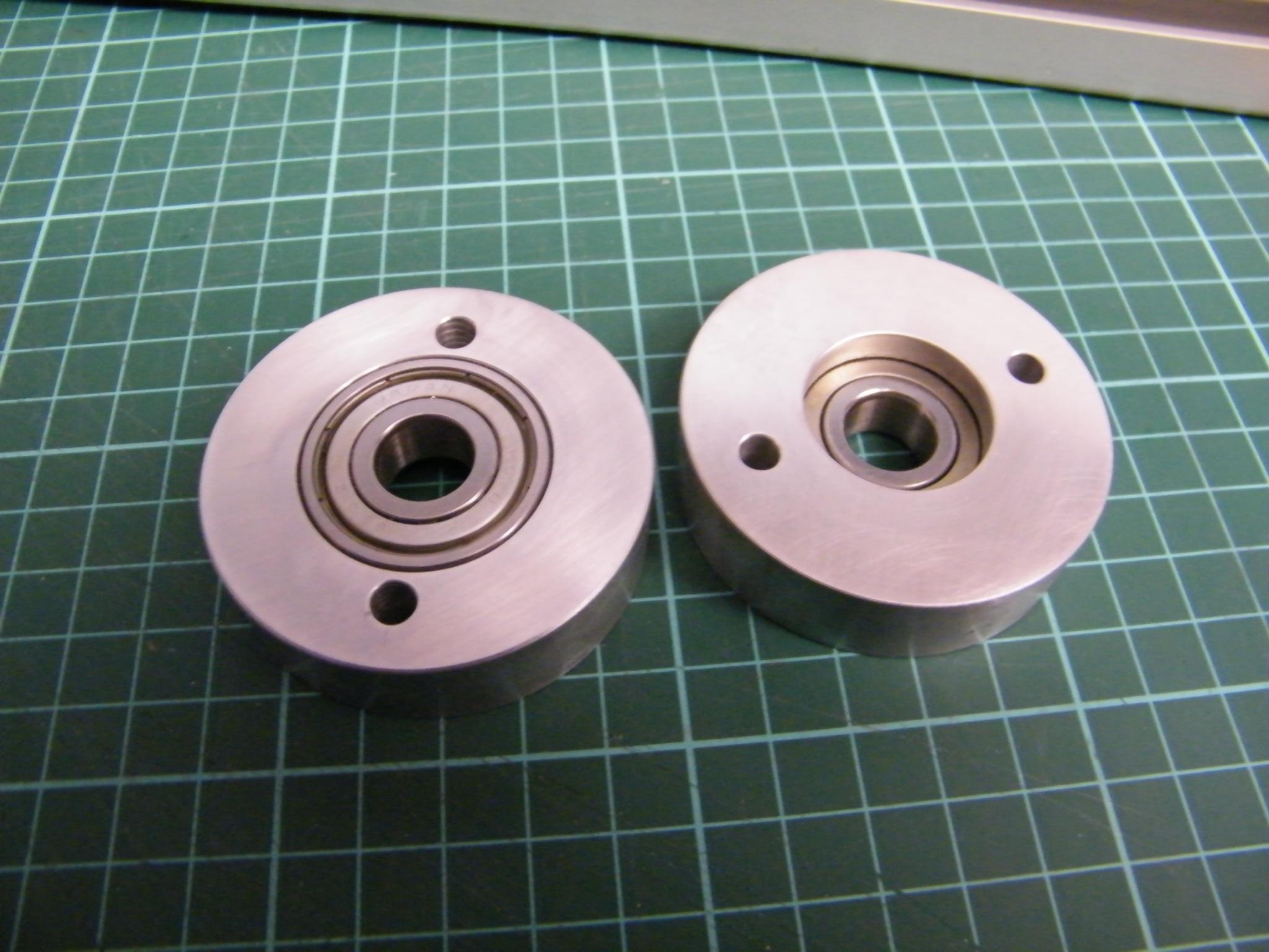

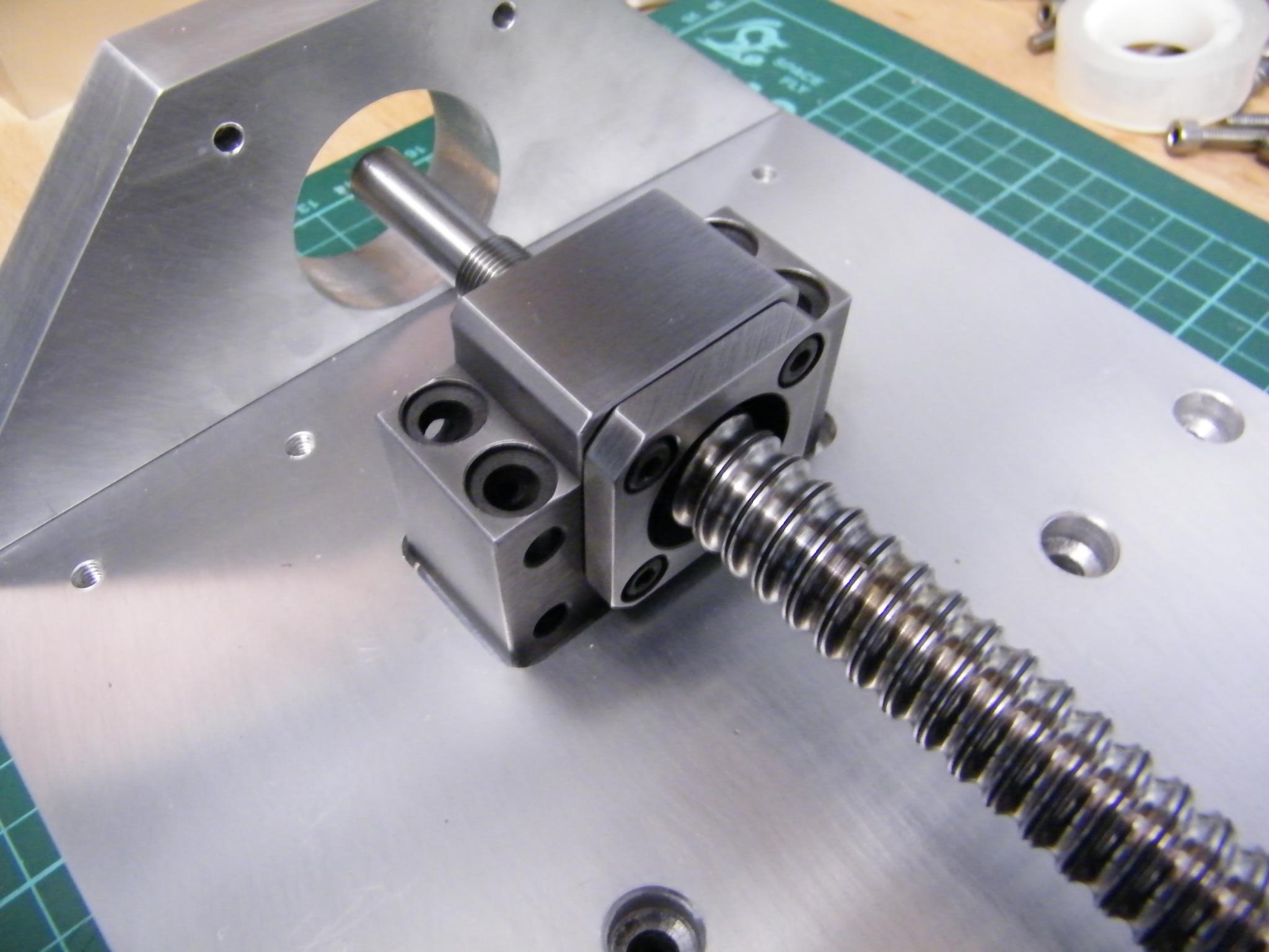

    Here is a few pics to give you some ideas of what you could do.
