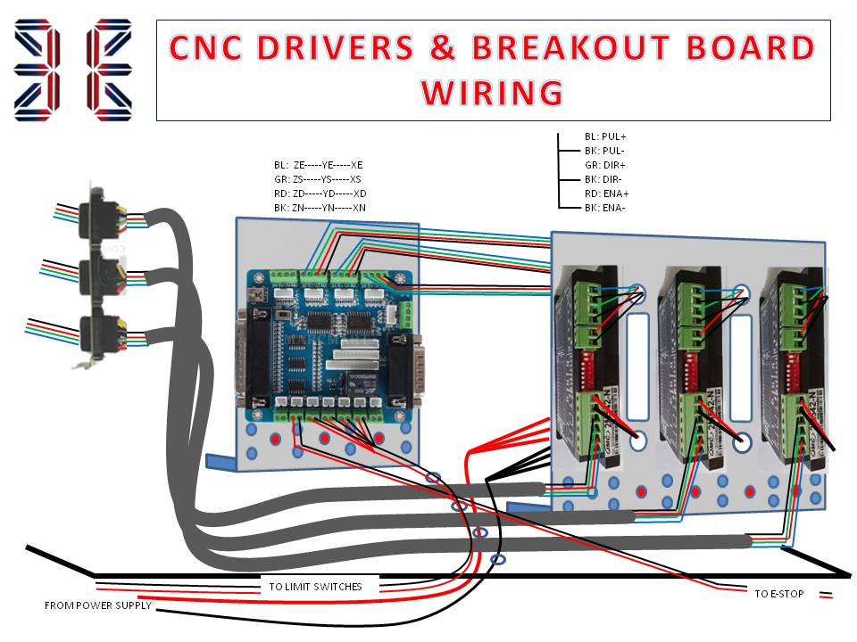

    had 3 of the TB6560 blue boards and kept blowin lumps out of the chips so decided to upgrade bought ZP5A-INT breakout board (5 axis)and 4 M542 stepper drivers of ebay
    all wired up to a new nema23, NO GO
    tried a nema 34 still NO go
    my power supply is a 24V 12a
    any ideas
    i no i should of just got a new kit from ZAPP automation
    Read the ZP5A setup instructions, they use for wierd pin layouts, not 23 for one axis, 45 for another.

Name:	MISCELLANEOUS EKF CNC PROJECT SLIDES.jpg
ID:	5697I have the same board and drives. This picture shows how I'm making the connections. Perhaps this will help. Take care
