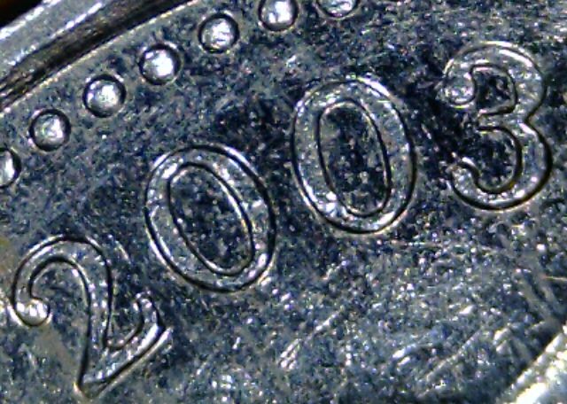

    I have one of those cheap digital microscopes, the one with the focus ring. It has a very positive clip mount which I could put on as a permanent attachment.
    It will superimpose a 640x480 24 bit colour windows bitmap but I'm having trouble making the background transparent. Cross hairs aren't a lot of good if you can't make the background transparent
    The image pops up in a seperate window which would work fine positioning with the pendant.
    This is the date off a 5p coin taken from a safe distance...

    That's a very crisp image Robin, never thought of using one of those microsopes:o
    Mach superimposes the crosshairs on your video, you can also superimpose the tool diameter you will use too so you can calculate the offset. It's quite a clever system and would benefit from automating like the touch probe edge/centre-finder.
