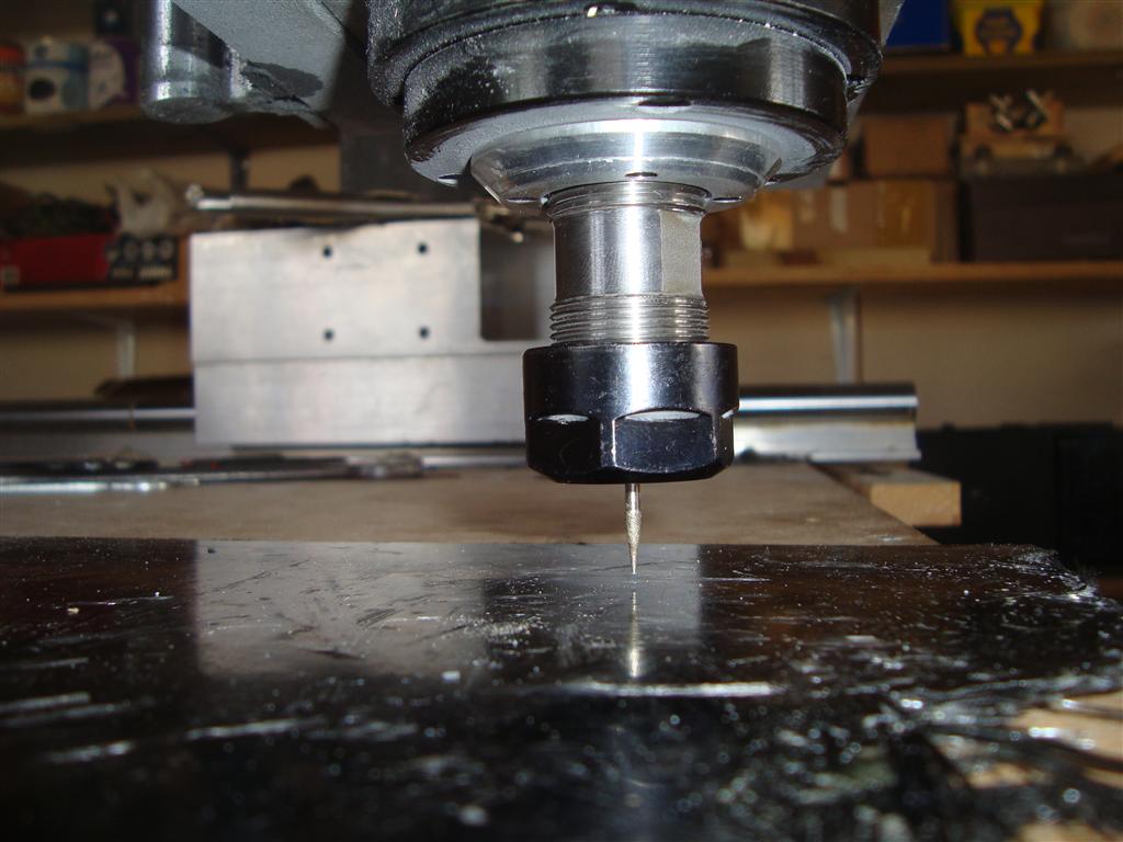

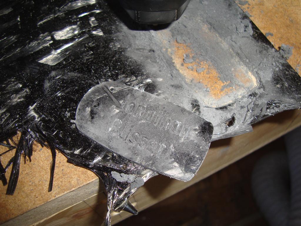

    I've cut carbon fibre sheet lots of times. By far the best cutter I found is those cylindrical diamond coated cutters you find in rotary tool kits:

    It's a bit slow (300mm/min @24000rpm if I recall correctly), but the cutters last a long time and since it's effectively a grinding process the finish is excellent.
