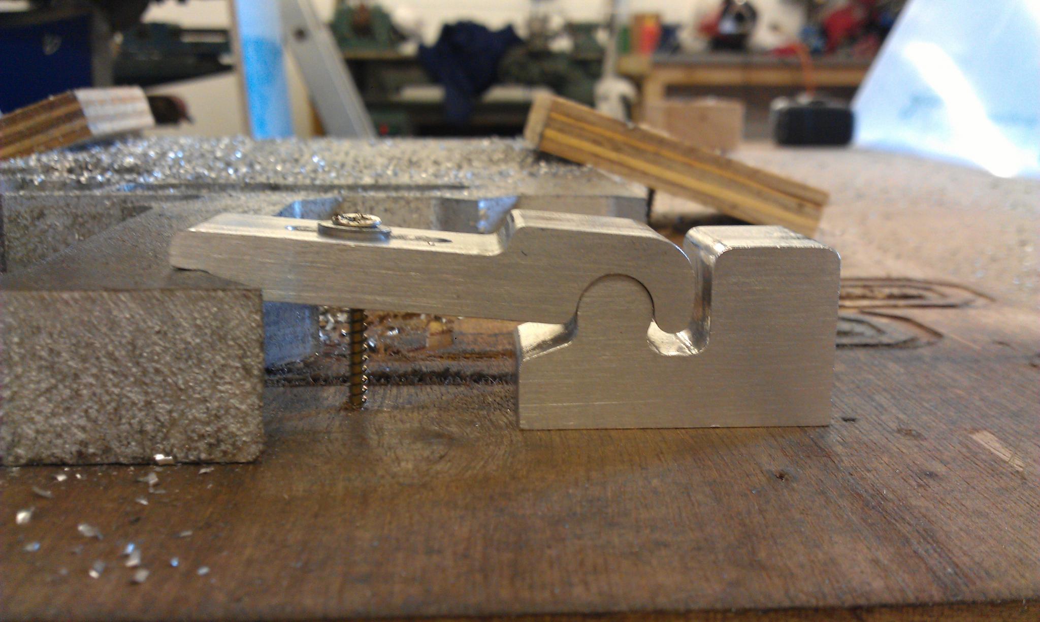

    the beauty about a long clamp is that you don't need a lot of force to hold down the board, which means less warp upwards in the middle of the board.
    it's very simply, but if you mill pcbs often, it's definitely the way to go

    Tenson,
    hopefully this pic will give you a better idea of how it works. This is 25mm thick plate its clamping. At the moment I have a wooden bed so Im using a wood screw but once my ali bed is in place I can use a 6mm bolt.

    Quote Originally Posted by HankMcSpank View Post
    Hence I just use double sided tape for PCBs. No distortion as well, no force really...

    Tenson,
    Ian
    Thanks for the picture, I imagined it the other way around with the flat part pushing down on the material. I might just copy some of these :)
