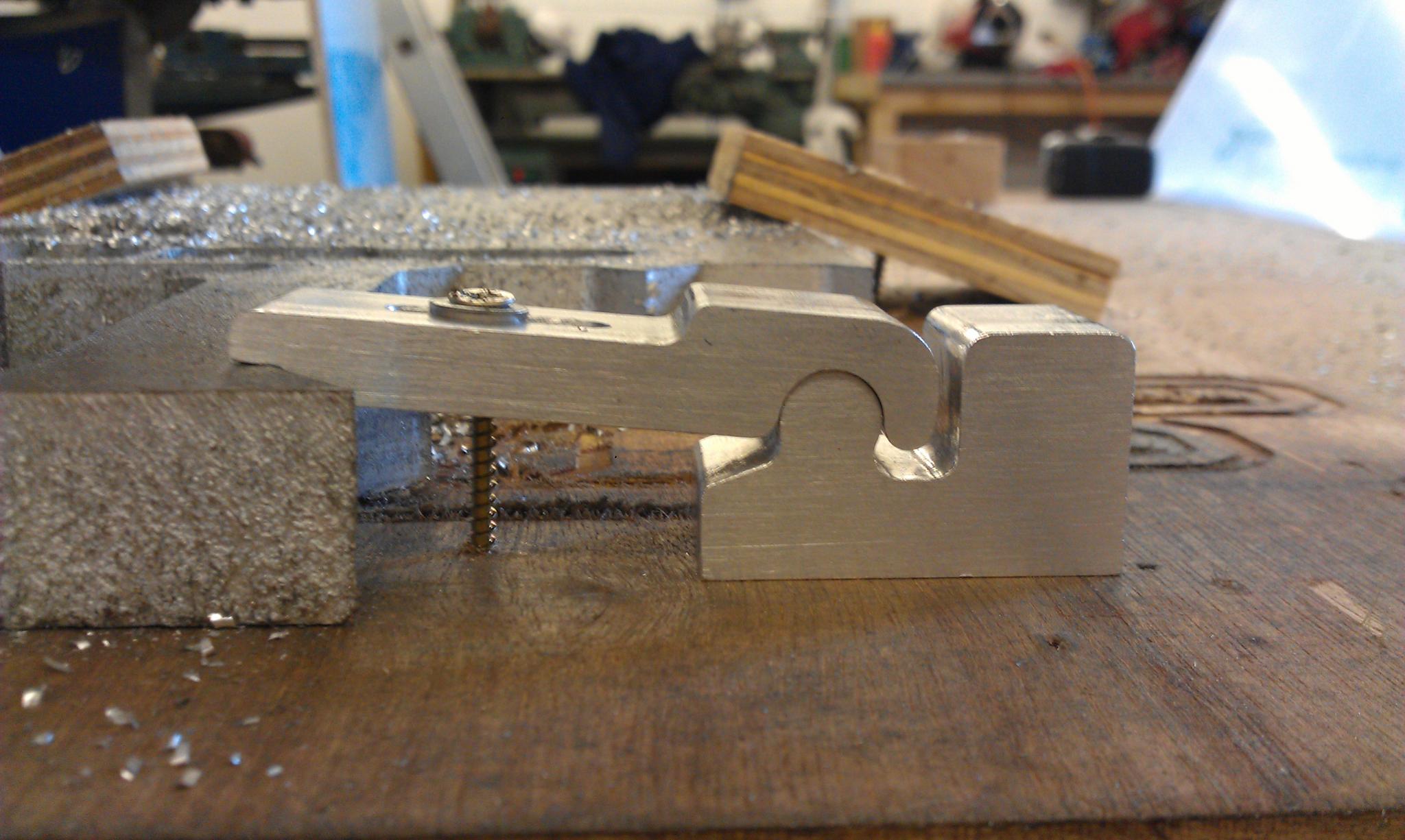

Tenson,
hopefully this pic will give you a better idea of how it works. This is 25mm thick plate its clamping. At the moment I have a wooden bed so Im using a wood screw but once my ali bed is in place I can use a 6mm bolt.
