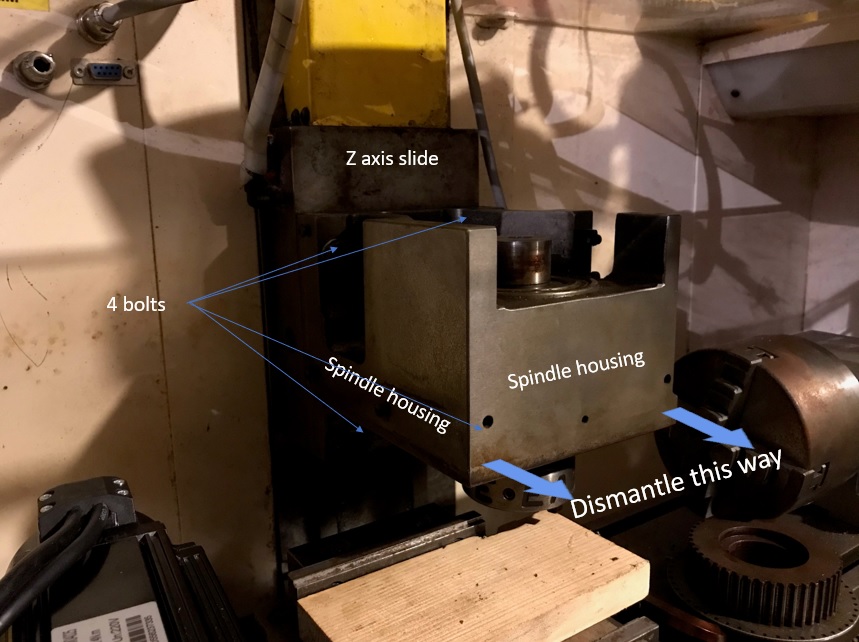

    Hi Laurent,
    I'm also rebuilding a VMC260, and I was wondering if you can remember if there is a way to remove the "rotating" spindle head from the Z axis slide? There appears to be a pivot in the centre of the spindle casting that allows it to rotate once you take out the 4 large bolts, but I don't seem to be able to separate the two from the central pivot? Do I need to remove the whole assembly including the slide to get to it, or is there some other way to remove it?
    Any suggestions would be very gratefully appreciated!

  6. #36
    Hi Laurent,
    Many thanks for your reply. Sorry - I didn't describe it very well.. I hope that this picture helps... What I'm trying to do is separate the spindle housing casting from the Z axis slide (I need to replace the spindle bearings). I undo the 4 bolts around in the corners of the spindle housing casting, but there is still a pivot in the middle which allows the casting to rotate into a horizontal position. I can't see a way to remove the casting from that central pivot (if possible without having to remove the Z axis slide)?

  7. #37
    Hi Ben,
    I think the only way to do that is to get the entire assembly off the machine.
    There are screws behind the head.
    Bring the head all the way up.
    Look at my pictures on the first page of this thread you 'll see the cuts /groove in the column that show you the way to remove it is up. 😊
