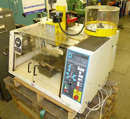

    I bought a Boxford vmc260 last year, used it with the Boxford software but found it very slow and limited so I'm going to upgrade to mach3 control.
    My machine has Parker stepper drivers and a get Gemini speed controller, does anyone have any information on converting this machine using these original parts and preferably a smoothstepper board?

    Im in the process of converting (well towards the latter part now) of converting my 260 VMC machine. i went down the new BOB and stepper driver route and am using the original spindle controller.
    Its working well, except i have just dismantled mine to replace balls in the Y axis as its a bit slack.
    I have the version with the auto tool changer (now not used) and air mist coolant and auto lube pump.

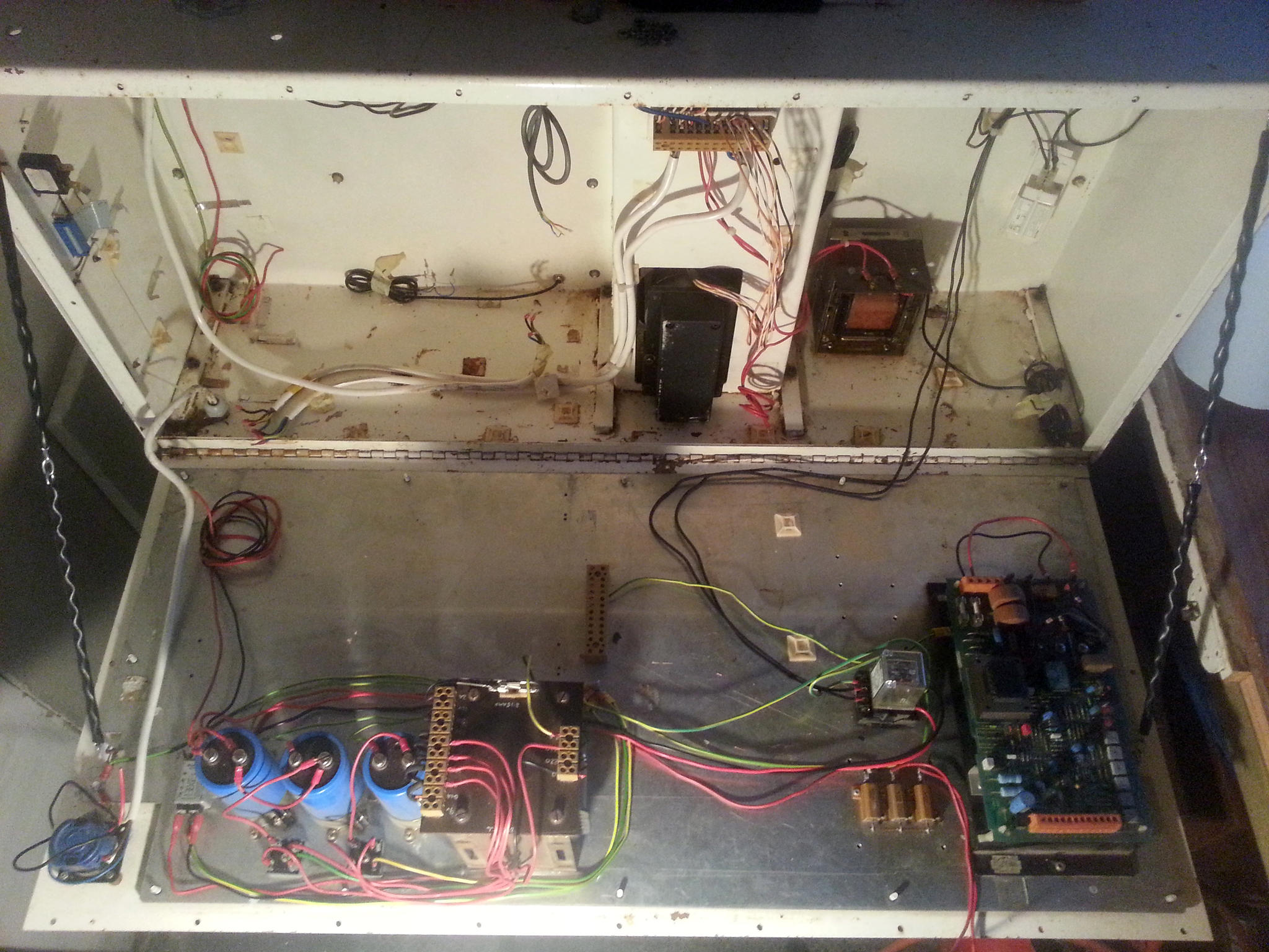

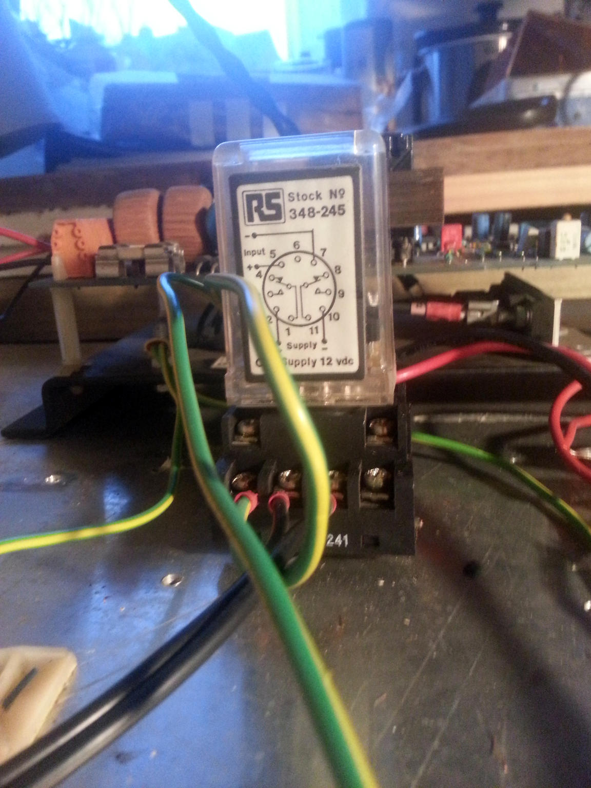

    I tidied up the wiring in the back of the cabinet, I removed the Yasaka contactors as I don't need the CCW spindle functionality.

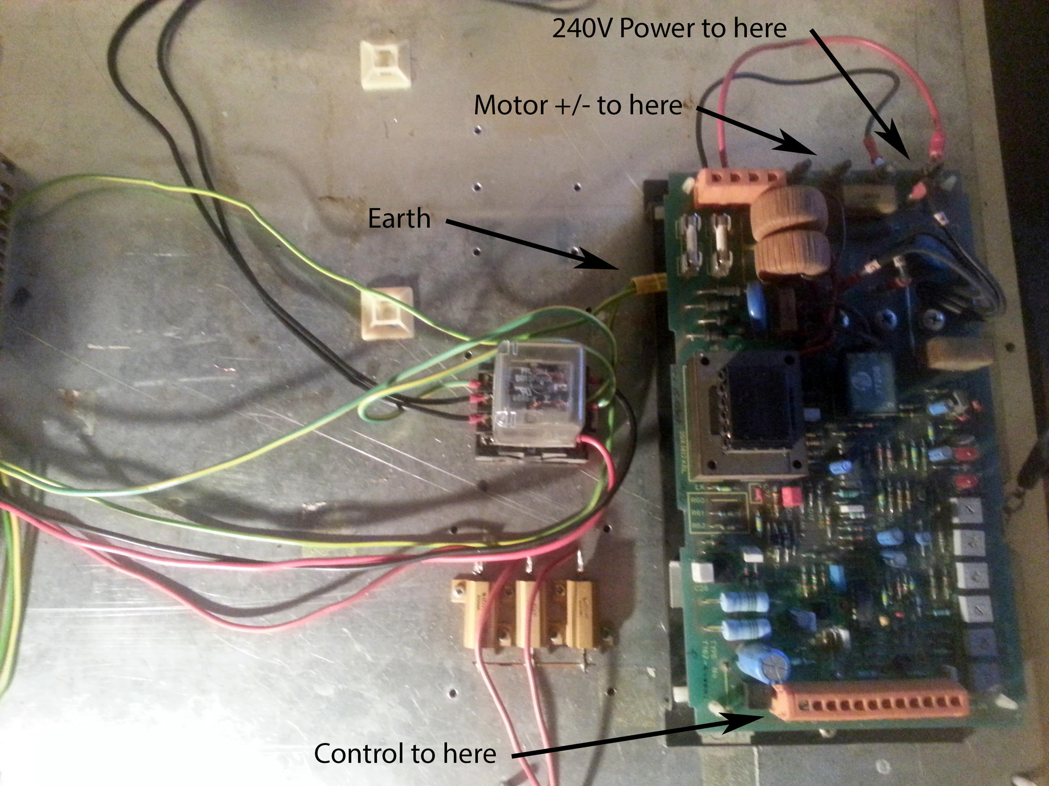

    Here are some close ups of the Power supply and Spindle Controller

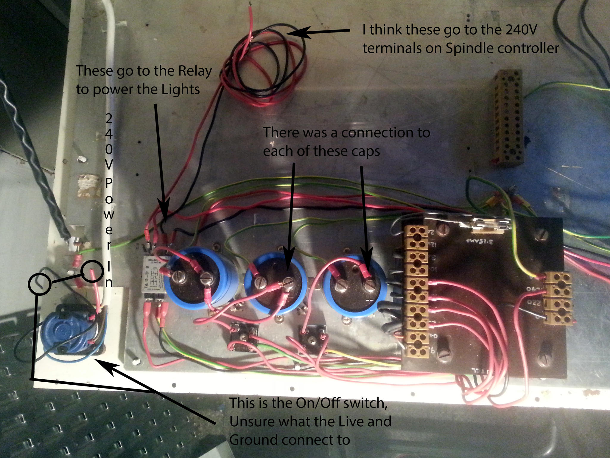

    I am guessing that I can remove this relay as it would have been for the lights switch on the main front panel.

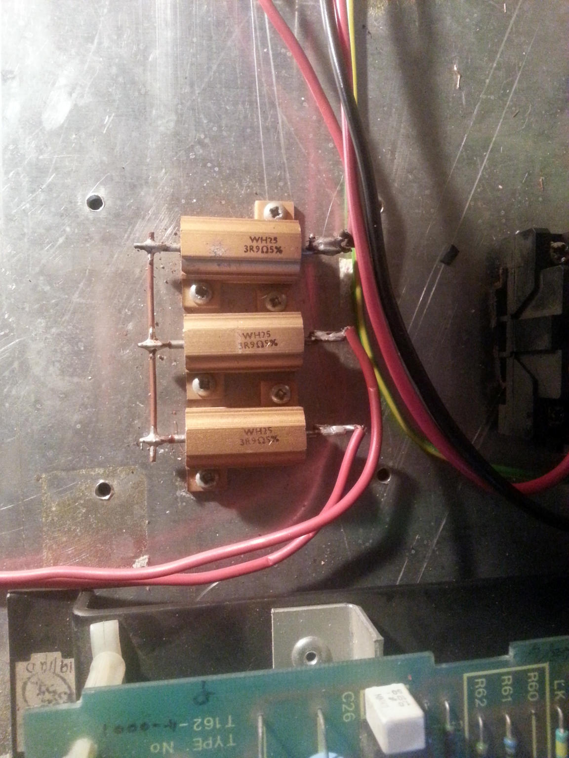

    Not sure what these resistors(?) are connected to...

Name:	Gemini Spindle Controller.jpg

Name:	Lights Relay.jpg
ID:	14922   Click image for larger version.

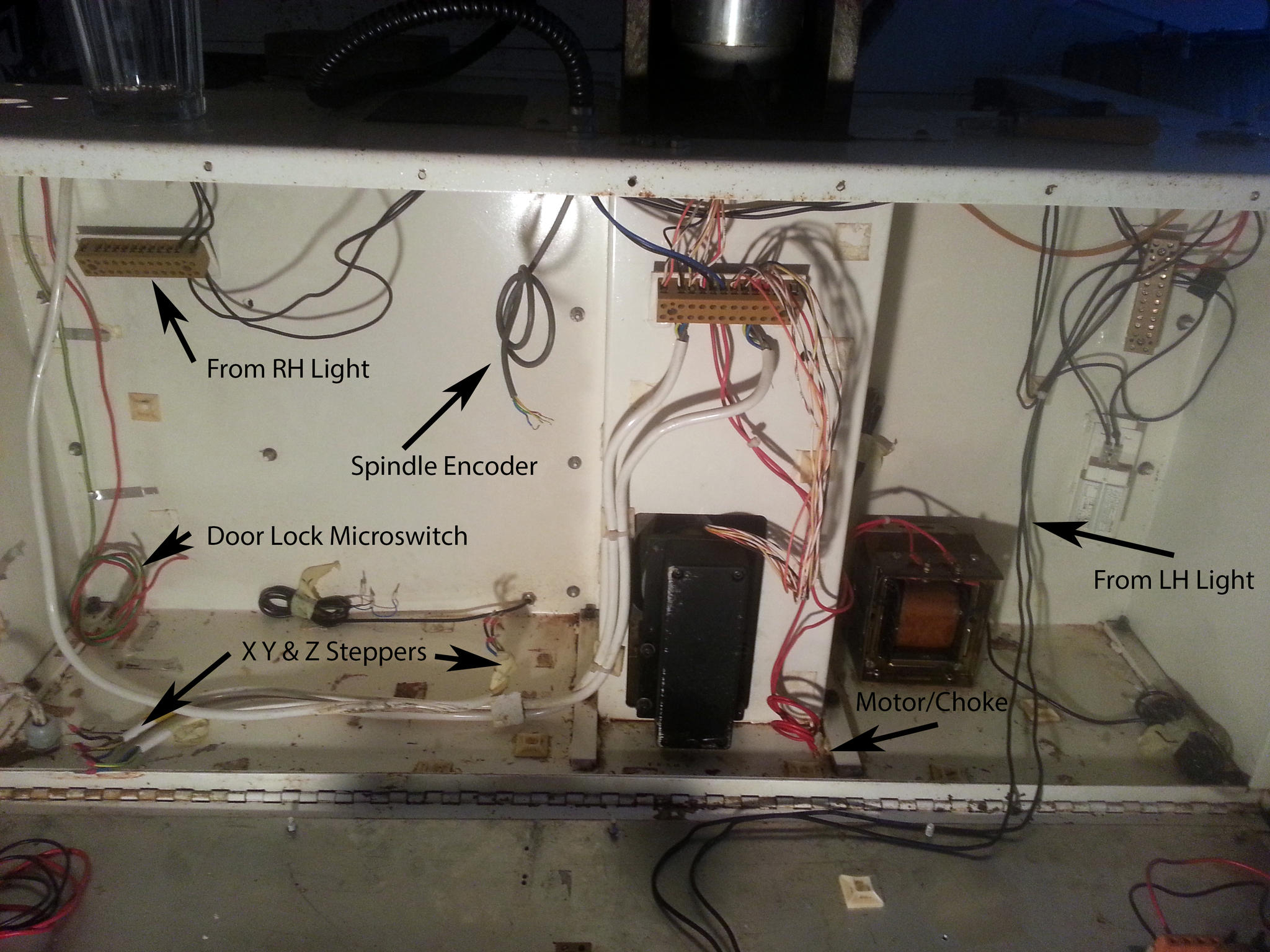

    Hi Nat, I found the original Boxford control/boards and wiring very confusing so have stripped down the machine to just the bits I will be keeping,
    I have found some information on the door interlock...

    It seems most people wire a connection across pins 3 and 9 on the speed controller to bypass the killswitch, I would guess that you could wire your E-Stop and door microswitch in series between these two pins depending on if they are NO or NC.
    Sorry cant help with the resistors, does your machine work without them wired up to anything?

    the dspindle lead 3 to 9 is for the door lock, but as I have wired it currently, it only stops the spindle and the machine still currently runs in axis so sure way to break tool bits! I have it going 3 to front control panel chocblock where it is wired into the door interlocks, then returns to pin 9. I'm sure there is some link to emergency stop I should put in but I need to investigate this.
    the 3 resistors I believe reduced the current going into the power into the relays to stop them burning out when in operation.
    the mains filter feeds supply to the spindle controller and the lights so your correct there.
    2 big blue caps are wired together and provide 18v dc, the other is 28v dc, you can get rid of one of the 18v dc caps and just use 1.
    the relay is for the lights. handy to keep hold of it to fit later on, as provides good lighting to the unit. However prob easier to fit lights on when machine is on and bypass relay, or to fit 24v Led lights and run off 18v? Again to run continuously.
    the spindle sensor is an optical unit, and unless you have some custom electronics to display spindle speed, or wire it into your controller, it's not necessary.
    on the spindle controller, the are 2 rotary dials which adjust the lowest speed, and highest speed. I set mine up when it was running, but be careful, as its mains! Looks like your cover isn't with the machine, the orange plastic cover.
    ground from the mains is earthed to machine the big aluminium plate. Live goes from the input, to the key switch, then back to the reset fuse the green and red button thing on the side, then back down to filter and spindle. I have my complete wiring diagrams at work, so will add them to my Flickr pool for you to see.
