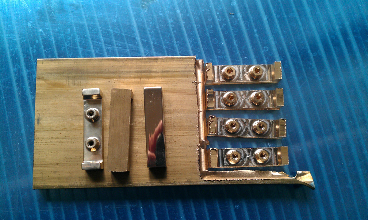

    I didn't have problems when cutting 5mm thick copper on my CNC router, but maybe I just got lucky.

    The outer profile and 2mm wide slot were on my CNC router and the 0.5mm slots were cut with a slitting saw on the milling machine. To be honest I can't remember which cutters I used. Probably these:
    http://www.ebay.co.uk/itm/5x-6mm-Car...item20b95dbb6d
    The same seller has plenty of smaller ones too...
