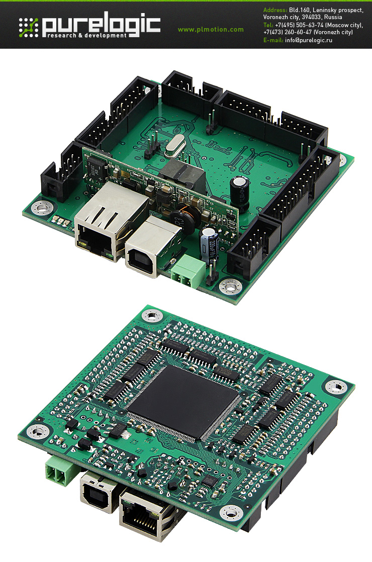

  1. USB and Ethernet Mach3 motion controller PLCM-E3
    Interface
    : STEP/DIR/ENABLE
    Max. freq: 100KHz
    Pins: 3 ports (same to standard LPT ports), 36 "out" and 15 "in". All ins and outs are buffered.
    Site: http://plmotion.com
    Main features:
    Ethernet(using TCP/IP) or USB Full-speed connection
    Up to 6 axes, 100kHz pulsing engine
    PWM spindle control
    Probing
    Torch Height Control
    Slave Axis support
    Soft limits
    Easy firmware update
    DB25F connector to reproduce standard LPT connection
    DLL for direct access to controller could be provided
    Power supply 5Vdc or USB
    Power-over-Ethernet(optionally)

  3. Hi,
    No, HQ based in Russia, but we can ship our devices to UK
    At the current moment you can buy device E3p with PoE at promotional price 125USD(shipping fee add 40USD)
    Here is manuals for the controllers: http://purelogic.ru/doc/PDF/Controll...sh/plcm-e3.zip

  5. We've not examined ESS(have anyone got such experience?) but we sold a hundreds of Plcm series ethernet devices in Russia before ESS even was announced. In one word, plcm are stable, all known bugs are fixed(last bug wasregistered and fixed in march). Plcm-e3 have STABLE USB, while afair SS use FTDI chip and drivers, it hangs up after even a little interference, f.e. when you powers up a spindle.
    There are some difference in pulsing engine - PLCM provide 100khz, but it's enough for most purposes. And you can't do threading on plcm, bur I'm not sure that SS supports this function.

  8. At the current moment, during the spring promotion, you can send us an email to avv at purelogic.ru or address you can find on our website, with qty and model (E3 or E3p-with PoE) of devices you want, shipping address, name, contact phone and email address for PayPal invoice. Device will be shipped in 3-4 busines day after payment
    I'm a bit confused, although that's not hard
    It says " Controller can be connected to any BOB or CNC driver box (destined for LPT-port) via DB-25 connector."
    If you are using the parallel port they why the ethernet and USB connections ?
    Can you use this on just USB or ethanet and forget the BOB and parallel port ?
    John S -
    I assumed that meant the output of the controller can be connected to a parallel port connector on your control box. Some sort of simple cable to convert the connectors on the PCB to a DB-25 connector.
