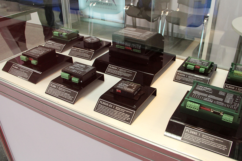

  3. Purelogic RnD participated in the "Metalloobrabotka-2012" exhibition(Moscow)
    Introduced new products:
    CNC pendant PLCM-R1 with Ethernet support for Mach3.
    New breakout board PLC4x-G2
    New milling machine PLRA1-RG
    all milling machines on this fair was controlled by plcm-e3
  4. Engraving and milling with PLCM-E3.
    All machines are connected to PC by Ethernet
