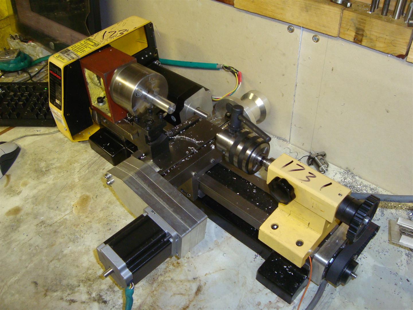

    I've not had chance to do anything with the lathe for a couple of weeks, so I've left it like this:
Name:	DSC09461 (Medium).JPG
    I will soon add plates to the Z-motor mount to seal the belt, similar to Z.
