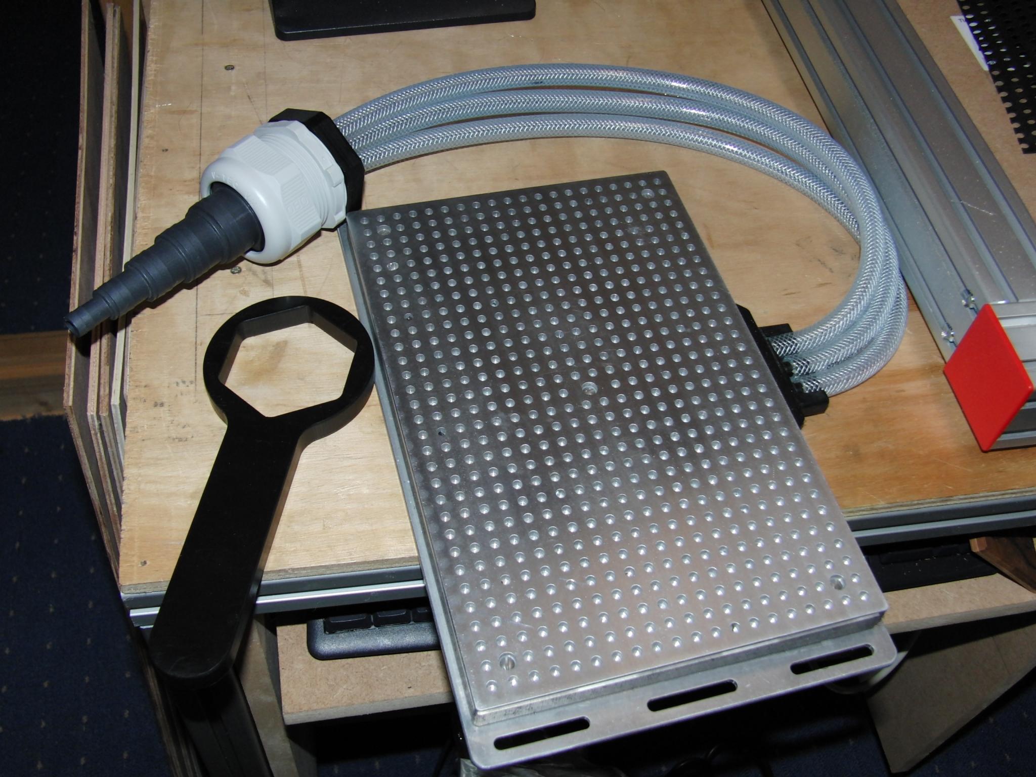

    chris, did you see this nice one in CIMBIAN's thread?

    Quote Originally Posted by mocha View Post

    I did but I didn't want to pile in on his sales thread with loads of questions.
