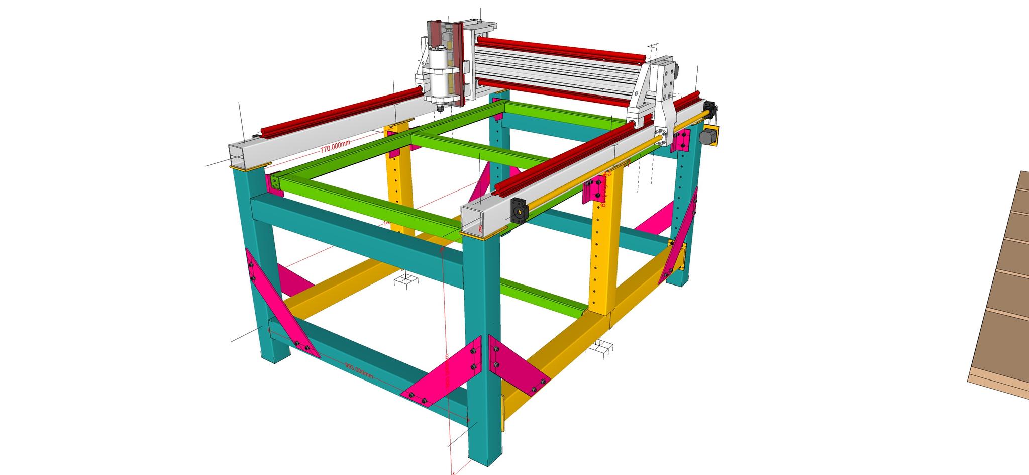

  5. Click image for larger version.
Name:	Revised 80x80x3 frame.jpg
    Revised 80x80x3 SHS frame - brings the cost down quite a bit. 6mm plate and/or welded connections...
  6. Just been going through the whole of your thread, its given me some good info for my design/build....where are you at with it now?
  7. I have have had a set of cutting/drilling/tapping drawings done for the frame for ages but for one reason or another have not started building the frame yet. I have the mighty Rage 2 now so will be ordering the steel in the next week or so. I've also been collecting some of the other tools I'm going to need, got a precision 1m rule, couple of engineers squares, caliper etc etc
    Really want to get on with it!
