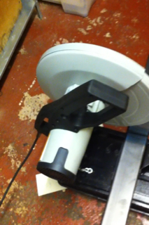

    Had a look @ that model, are you cutting steel with the TCT blade or using an abrasive disc ?
    I've actually got the 255mm Rage 3 - just using the stock multipurpose blade that came with it.
    I use that blade for most rough jobs & have a decent quality wood blade for more important diy jobs.
    I've used it to cut wood, plastic, aluminium & steel - does a decent job on all of them.
    There's a video on youtube of a guy in the USA demoing it cutting through loads of different materials & comments on cutting finish & material temperatures etc Its worth a look if you're considering getting one.

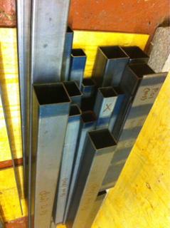

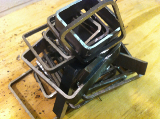

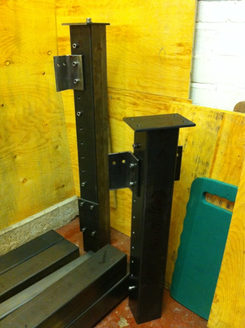

    Slow but steady progress - grabbing an hour here and there...

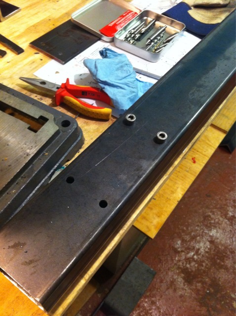

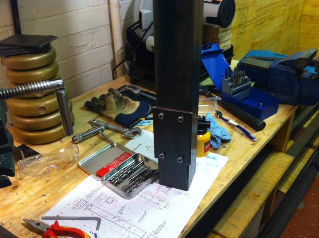

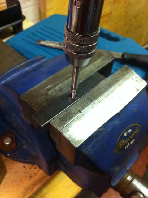

    First parts drilled, tapped (and fit!) decided to weld plates to the inside of the box sections to increase thickness for tapping... Thanks Jazz for the idea
  5. A word of advice to anyone buying a tap wrench - don't buy a cheap eBay jobby like I did - they are crap. Just ordered the real deal from starrett... :) same applies with centre punches - buy a starrett you won't regret it!
