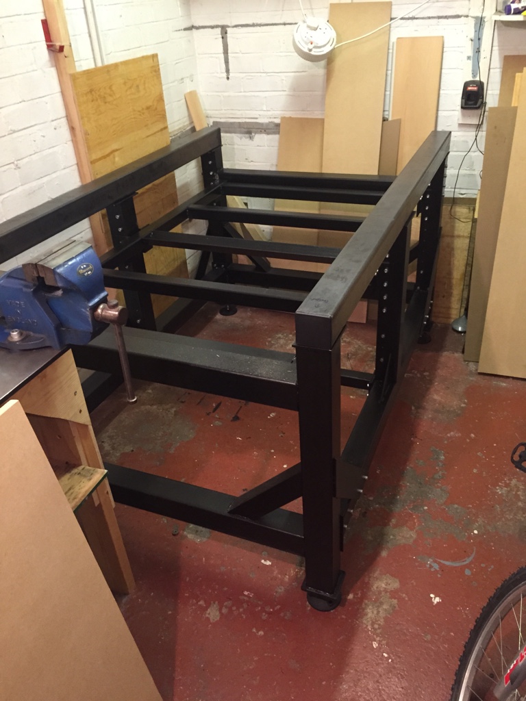

  3. Some stills from my updated model...
Name:	cnc view 3.jpg
ID:	15579   Click image for larger version.
Name:	cnc view 2.jpg
ID:	15578   Click image for larger version.
Name:	cnc view 1.jpg
  4. The Following 2 Users Say Thank You to JoeHarris For This Useful Post:
    Hi Joe,
    Coming together nicely now. Is there any reason on the gantry for putting the X axis bearings out the back and the spindle hanging out the front? Normally you would put a bearing near the spindle axis to give more support. Do you need to cut right over the edge of the machine?
    Not saying it won't work as drawn because it will, just that it could be a little better if there was no reason for the bearings positioning as drawn.

    I had decided to go with slaved motors but I really want to use a CSMIO/IP-M Motion Controller and they don't like slaved motors. Early on I had toyed with a belt drive and after reading posts on biketrialdave's build log I'm heading back that way I think. The belt will need to be made as it is over the size limit for standard belts but the cost of a custom one does not seem extortionate! The basic idea is as the image above... which would not require much modification from the existing setup. As usual, any comments are gratefully received!
