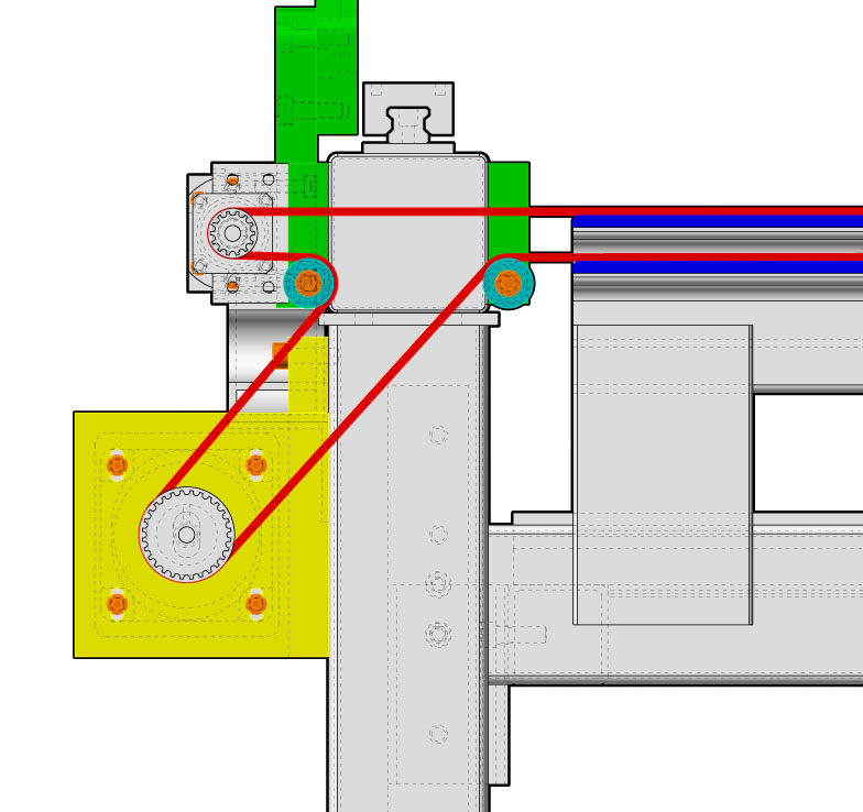

  1. I'm still getting the best part of 7 teeth engaged and 5 fully. According to Jonathan this should be sufficient. I'll have a think...🤔 as always - appreciate the critique even if it does mean more redrawing (again and again!!)

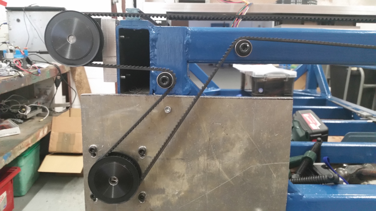

    That's how I've bodged mine in, at some stage I'll design a neat back plate and use the machine to cut it.....a bit Heath Robinson, but it works

ID:	17562If at first you don't succeed... be glad you modeled it first!

    That looks loads better Joe n1!
  9. #208
    That looks good Joe :)
    Neil...
    Build log...here
  10. The Following User Says Thank You to njhussey For This Useful Post:
  11. #209
    New you would get there in the end Joe its tons better now
  12. #210
    That's it Joe.
