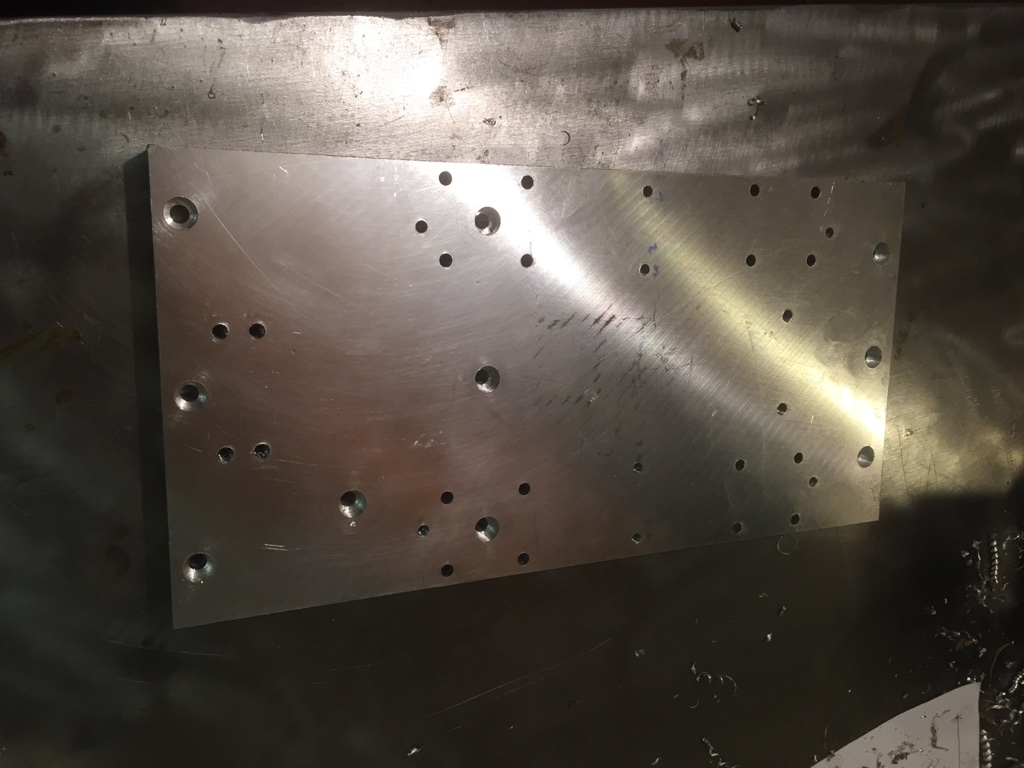

  5. Z axis progress pictures. Click image for larger version.

    Very nice as always Joe. Great idea on the spacer plates to save pocketing the ball screw BK mounts although it does push the spindle further out slightly.
