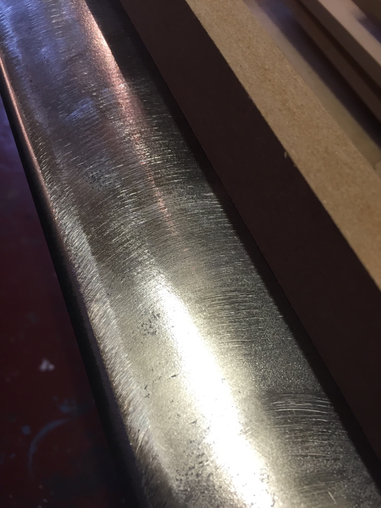

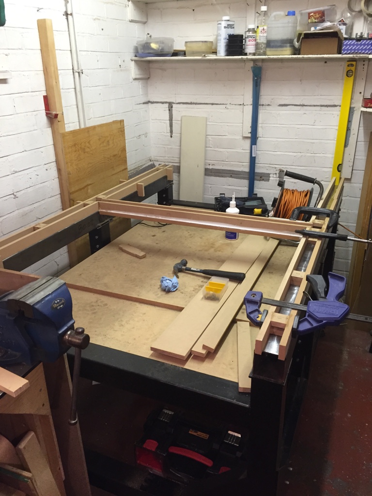

    Joe I did not have any shrink problems at the ends on mine but do put the effort in to stop any leaks you will be surprised how easy it is to get one, a small bead of silicone is the key
  3. The Following User Says Thank You to Clive S For This Useful Post:
  4. #223
    I sealed my moats by running a small amount of epoxy along the gap first. Small amount and it doesn't run through but will cure in the gap and stop it leaking when the full depth goes in a day or two later.
  5. The Following User Says Thank You to Neale For This Useful Post:

    Jo be careful you have enough epoxy because it's proper ball ache if you run short. However I know 1ltr should be enough for machine your size so shouldn't have any trouble.
    Really make sure you seal it well because it's amazing how epoxy finds leaks and they don't always appear instantly so keep checking and be ready to make repairs. Putty is handy stuff to seal quickly.
  11. Click image for larger version.
    Surface ground and scored with sandpaper. Dams almost complete... Click image for larger version.

  13. Quote Originally Posted by njhussey View Post
    Looking good Joe....looking forward to seeing the pour!
    Me too. Bought some silicone sealant and found an oil radiator donor! Nearly ready...
  14. #230
    Quote Originally Posted by JoeHarris View Post
    What's the oil radiator donating?
