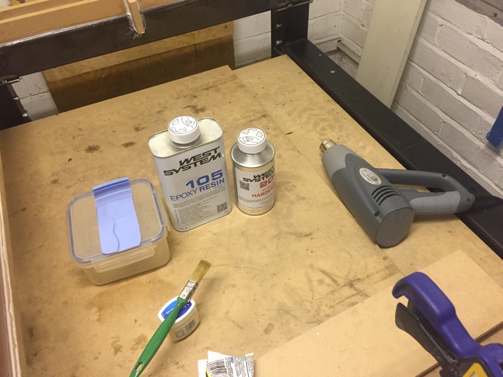

  1. To heat my workshop... Someone is lending me a couple of them. A minimum of 16 deg C as a constant temp is recommended and West System state: "As the temperature drops, epoxy becomes proportionally thicker, reducing its ability to flow out." They also state that air bubbles are more of an issue at lower temperatures.

    If you have a vacuum pump you could knock up a degassing pot, i use an old pressure cooker.
    Mike
  3. #233
    Hot air gun across surface would usually deal with any bubbles.

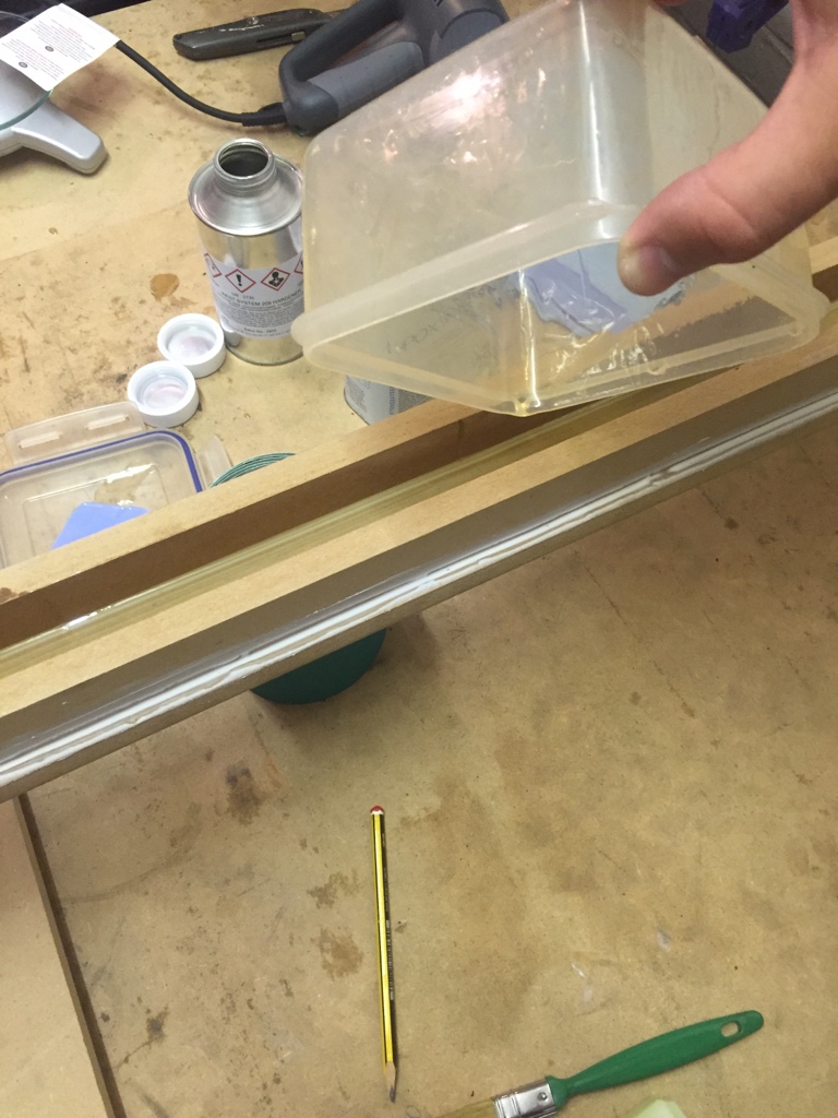

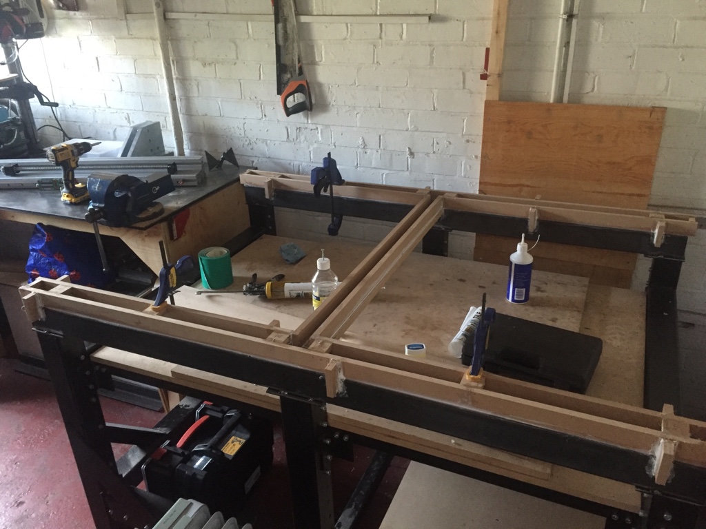

  4. Ready to pour! Click image for larger version.
ID:	18429 I made some little brackets to hold the mdf in place Click image for larger version.
ID:	18430 sealed both sides with silicone so hopefully no leaks! Click image for larger version.
ID:	18431 and heat gun and Vaseline at the ready! Click image for larger version.

  5. #235
    Best of luck, looks like you've got everything prepared though so I'm sure it'll go fine.
  6. #236
    careful with the heat gun joe you can easily cause hot spots which harden at different rate. Only a quick flash is needed and only if really needed. Few air pockets won't hurt anything.
    Not quite sure what the vasoline is for thou.?
  7. #237
    Vaselines for the same as heat gun apparently "Some like it Hot!"
  8. Quote Originally Posted by JAZZCNC View Post
    Cheers Dean, I will take it easy on the heat. The Vaseline was for the mdf sides to act as a release agent... I think Clive suggested it?

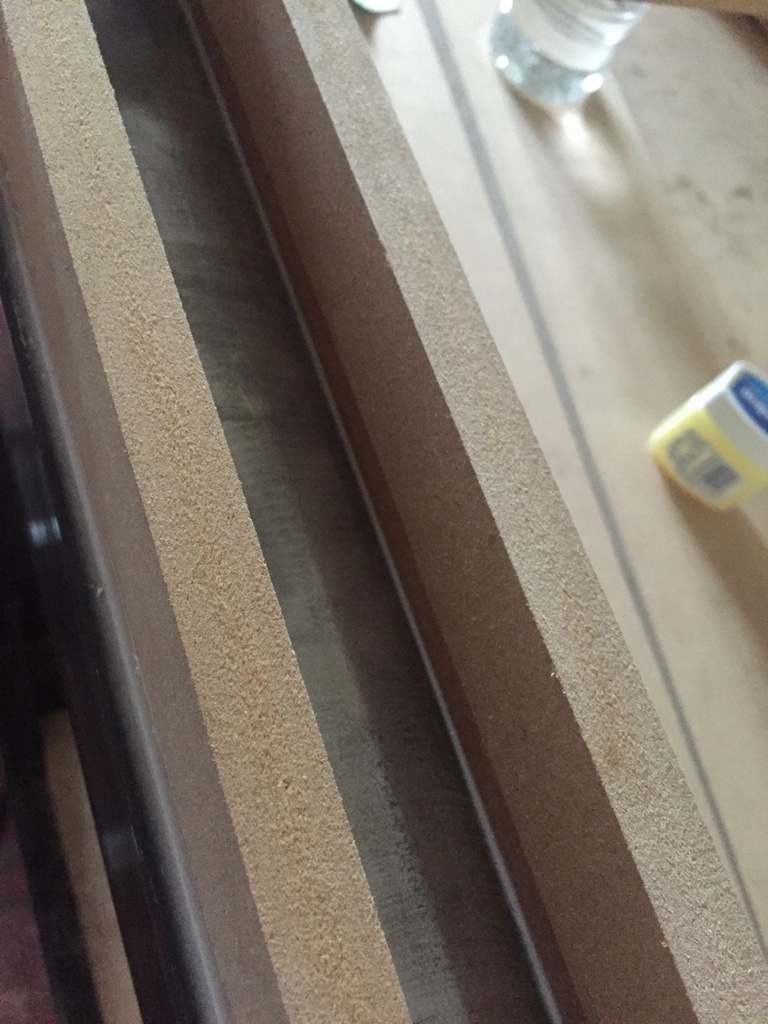

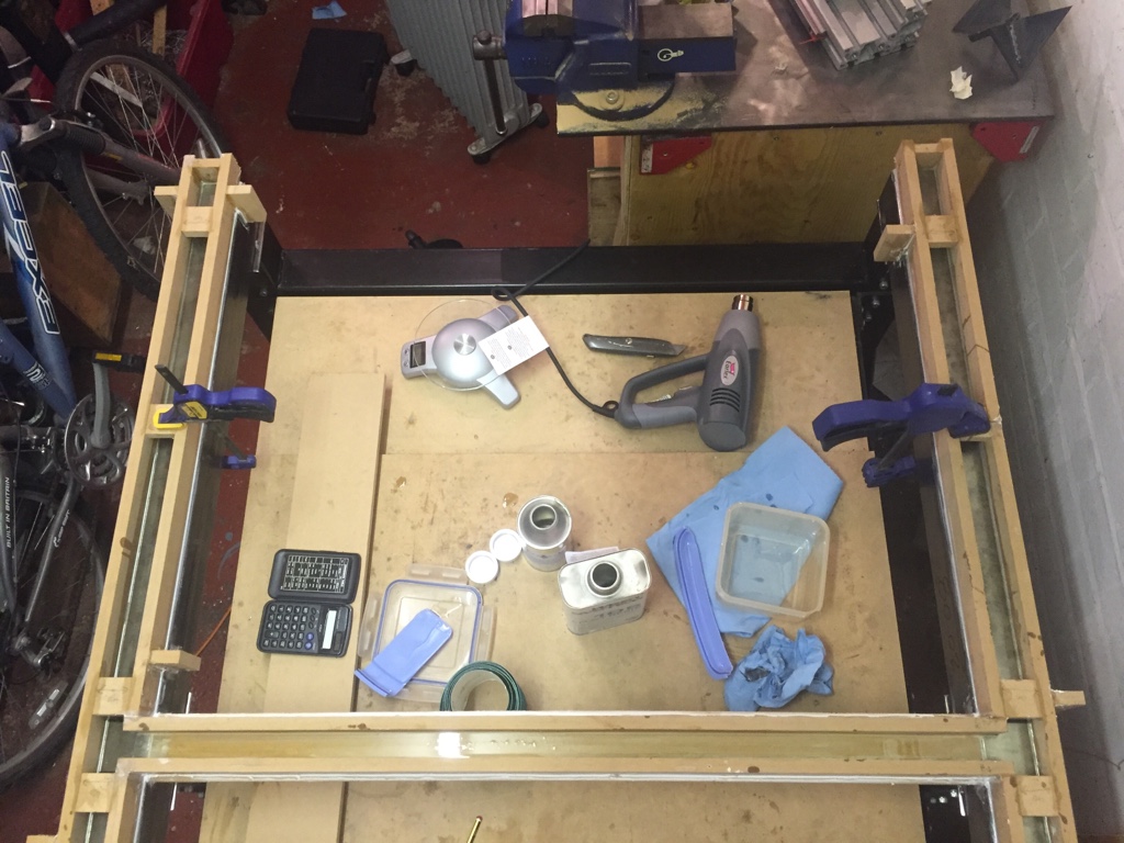

  9. This is why you want slow cure epoxy - this a time lapse- the movement is barely perceivable in real time. Click image for larger version.
ID:	18448 well it's done. Now we wait... Click image for larger version.
  10. The Following 2 Users Say Thank You to JoeHarris For This Useful Post:
  11. #240
    Great stuff especially the time lapse video. It might be worth keeping the bridge between the 2 rails in place during initial setting up if you need a datum to DTI off to align the gantry Y rails - depending on the gantry rail design you've decided on
