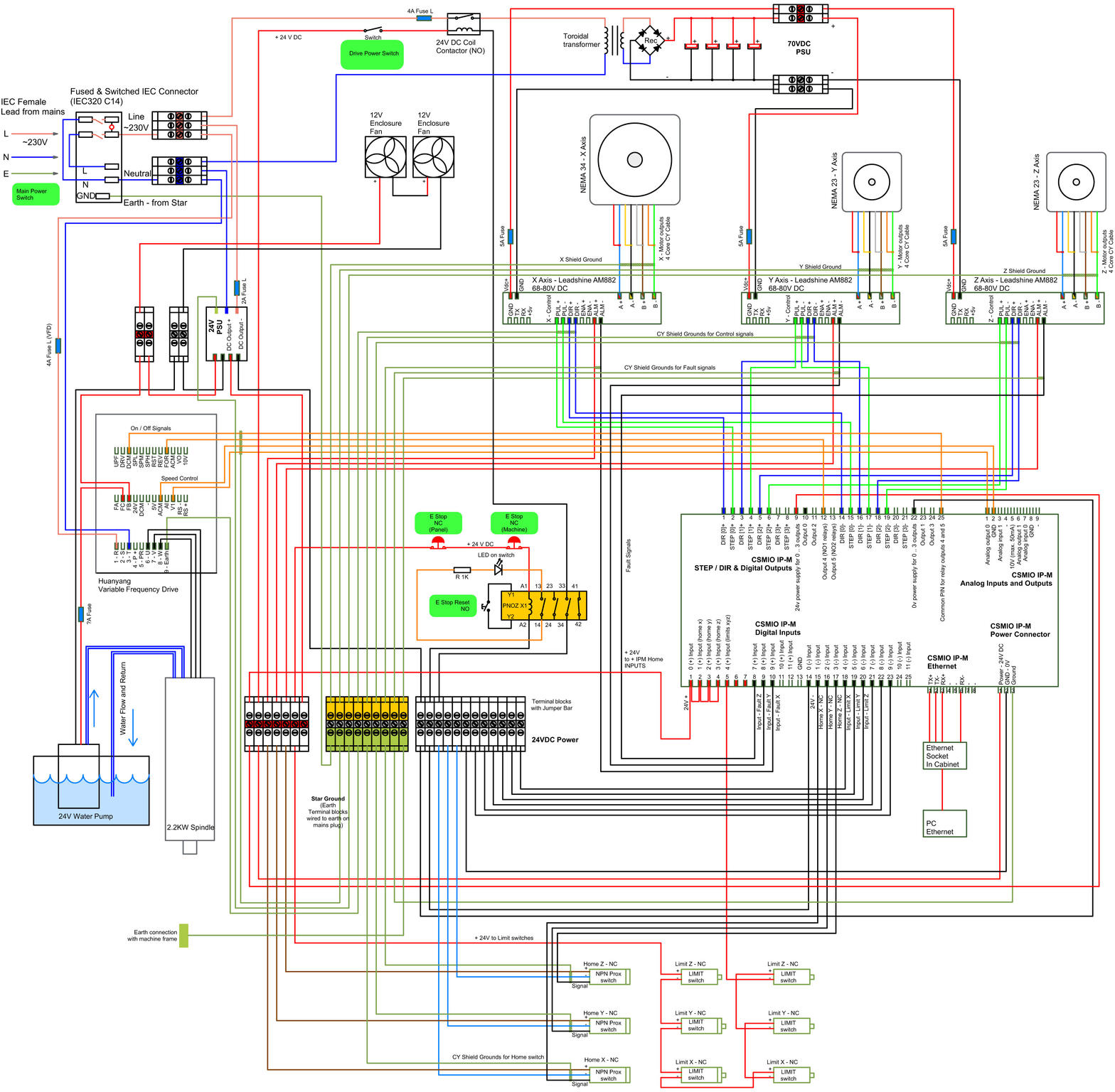

    It is hard to see from the pictures, but please check soldering of the capacitors.
    Sent from my LG-H850 using Tapatalk
    Hi Toomast, the terminals on the caps have been pushed through the wire stands and then soldered, I have also put some hot glue over the bare wire to help prevent shorts.
    Quote Originally Posted by JoeHarris View Post
    Good, maybe the glue makes it look odd on the picture. It can be tricky to get the thicker wires to heat up properly - risk of cold solder joint.

  8. Hi everyone, I've managed to get a working mockup of the e-stop circuit together... another little video:
    https://youtu.be/OUgjcH8JGMs
    As always any comments gratefully received!
  9. #8
    Very nice Vid Joe, If I might make a very small comment for the benefit and clarity of others. Re the switches and the schematic it would be nice to show that they have leds inside.
    I realise on the vid you can see that you mentioned them. But as drawn it looks wrong because the leds are not shown on the drawing.
    Having said that it is superb and will help a lot of people with the Estop and restart circuit.
  10. Quote Originally Posted by Clive S View Post
    Yes fair point! I realised I had also forgot to draw the contacts on the relay 'switches' too which would have aided clarity. Hope it helps people just to understand what some of these things do. I had never heard of a pilz or a contractor before starting this project so this was a bit of a curve for me. Basic info has been what I've craved from the start!
