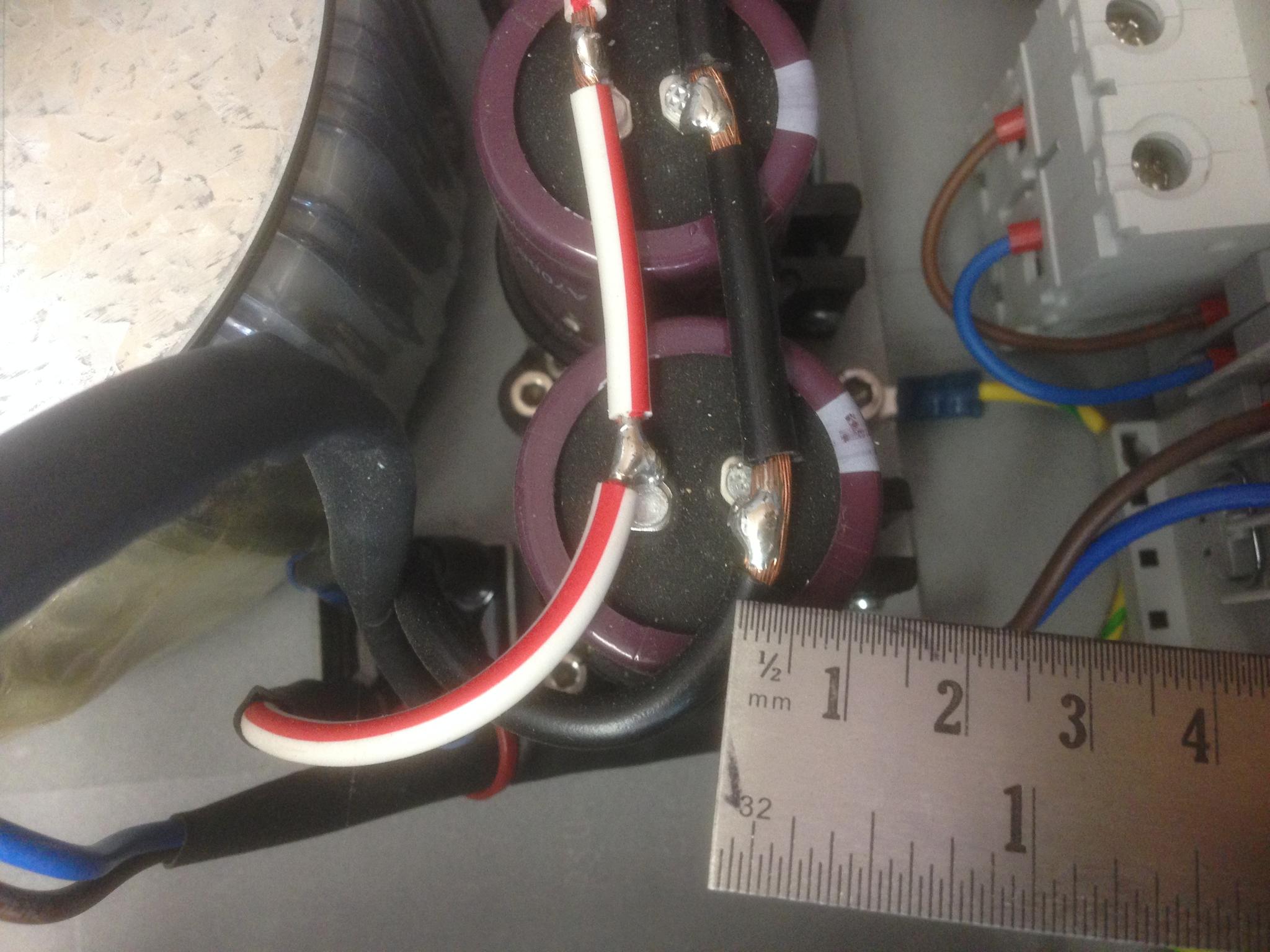

Joe be careful after connecting the Caps because they will be charged and will give nasty surprise if you short the wires.
Edit: To answer your Alarm wire question from below then no I don't.Last edited by JAZZCNC; 23-04-2017 at 09:50 AM.

Progress on the psu...
27-04-2017 #378
I think I've finished the power supply... haven't switched on yet as I want to look it over again with fresh eyes and make sure I haven't done anything dumb! Here she is:
Power in top right via the D curve mcb which will be din mounted and dc out from the lower terminal block. I have wired a 10k resistor between the dc terminals to drain the caps once powered. Any comments before I turn it on?!

Only comment (if you have a chance to make any small mods at this stage) is to add a few more sets of terminal contacts for the output, all wired in parallel. This allows you to run separate power feeds to each stepper driver, rather wiring them daisy-chain fashion, and it's easier than trying to stick three big wires in the same terminal. Not sure if it really make a difference in our class of machine but it is generally considered good practice not to share high-power connections between devices, and it's a lot easier if you have multiple terminals available. Might be able to put multiple spade terminals on each of your contacts, though?
