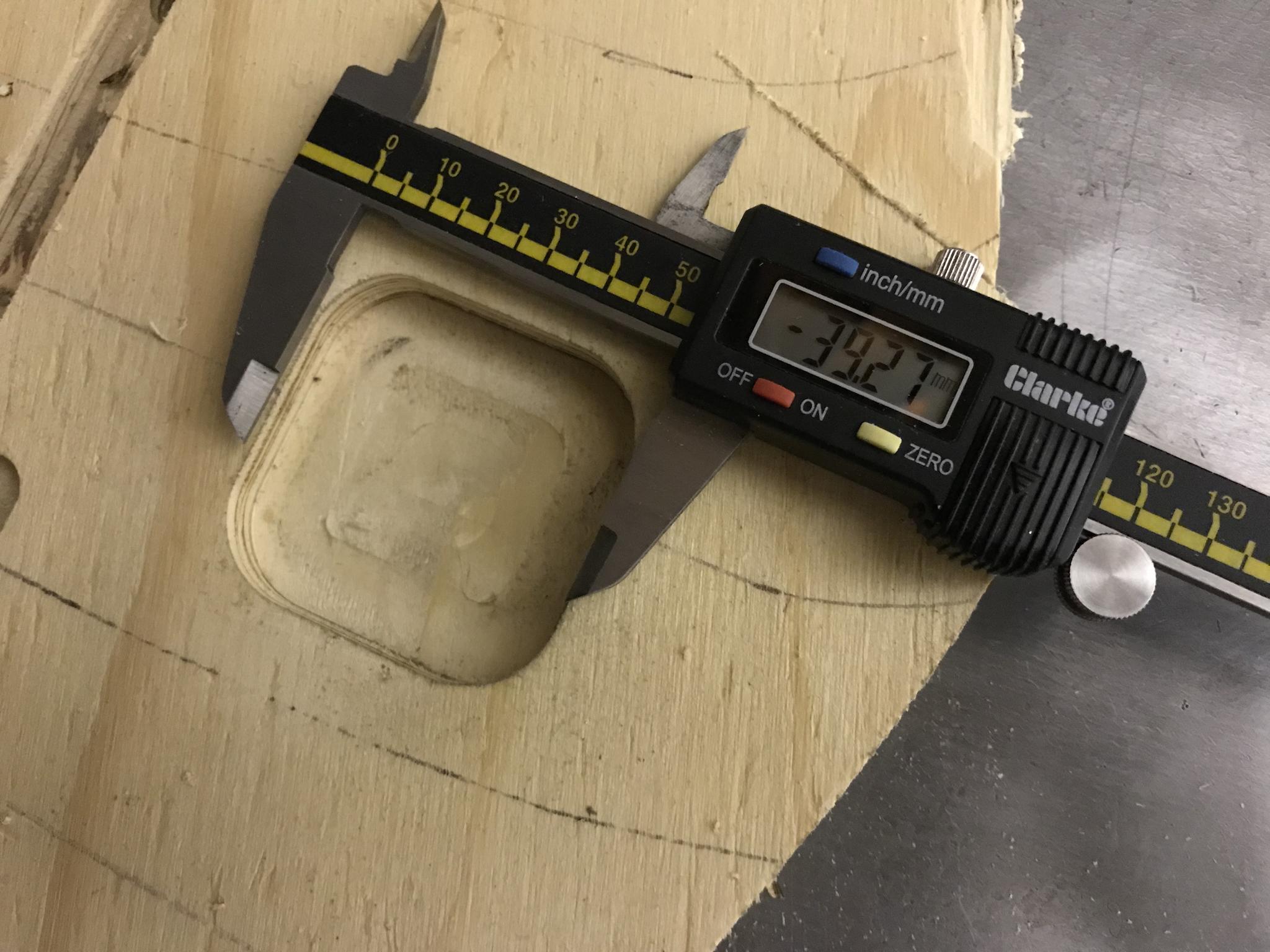

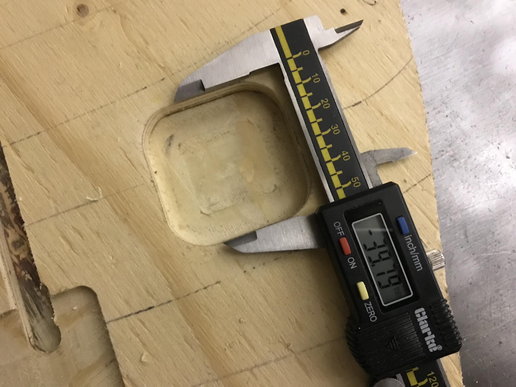

  6. I have been busily getting my head around fusion 360 in the background (very nice programme, can't believe they let the likes of me use it for nothing!) and sent my first programme to the machine this evening and of course things did not go quite to plan.
    The intention was to cut a small pocket 55x55mm with a 1/2" router bit (12.7mm)
    This was all set up correctly in fusion (I think) and it cut fine, albeit far too slow (I'll up the feed rate next time around), but the problem came when I measured the part - see pictures below... any ideas!?
    After all this time building, it is dawning on me that I have no idea how to use this new tool of mine :(
    Edit: Sorry - pictures make this look worse than it is as I forgot to zero the calipers! I'll take some new pictures...

  7. New pics after previous post - prob need to run the calibration wizard in the settings window of MACH3 again... but being out by 0.8mm in one direction and 1.4mm in the other does not seem a great starting point.

    Joe don't get despondent, this is normal when first getting the machine calibrated. Check it over a greater distance say 300mm in fresh air ie. in the midi type g1 f500 x300 and check to see if it has move exactly 300mm then do the same on Y ie type Y300 and check that. you might have to amend the steps per.
    Thanks Clive, it was nice to see it cutting at last and I’m sure I will get it all sorted but I have quite a few things to fix and finish and I’m getting very impatient!! I will have another go tomorrow...

    Like Clive said you run the calibration and Mach 3 asks if the axis you calibrate,each time,moved at the distance you want,you put the correct distance in the proper box and you see the machine do the correction!
