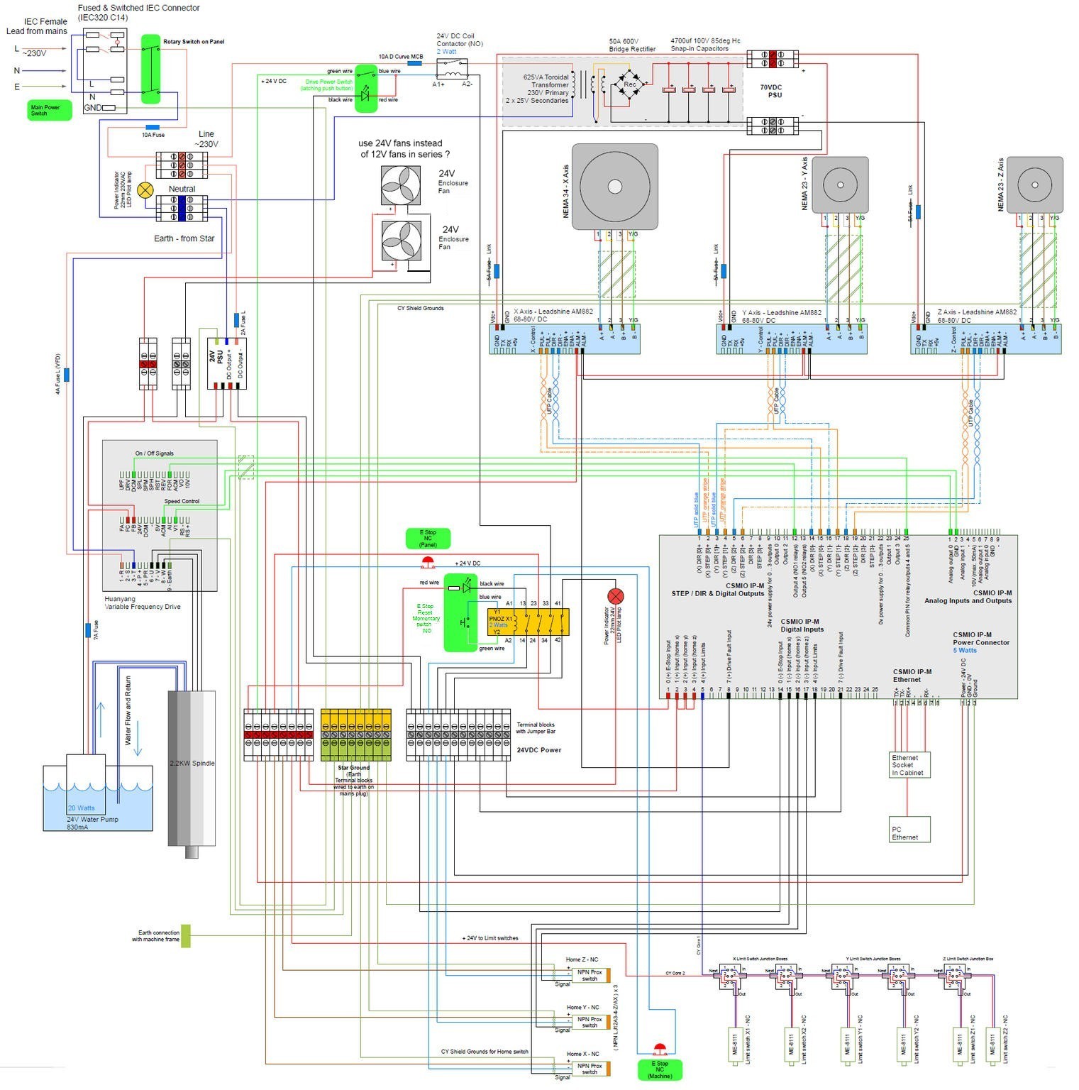

    So starting up again, I got the spindle control from Mach set up last night. All seems to work OK, apart from the RPM readout on Mach reads 0 regardless of the spindle speed. Is that normal? The one setting I was not sure about was mach's "spindle pulley" settings. The IP-M manual was not much help on that front. Does anyone know what this should be set to for a 2.2KW chinese water-cooled spindle?

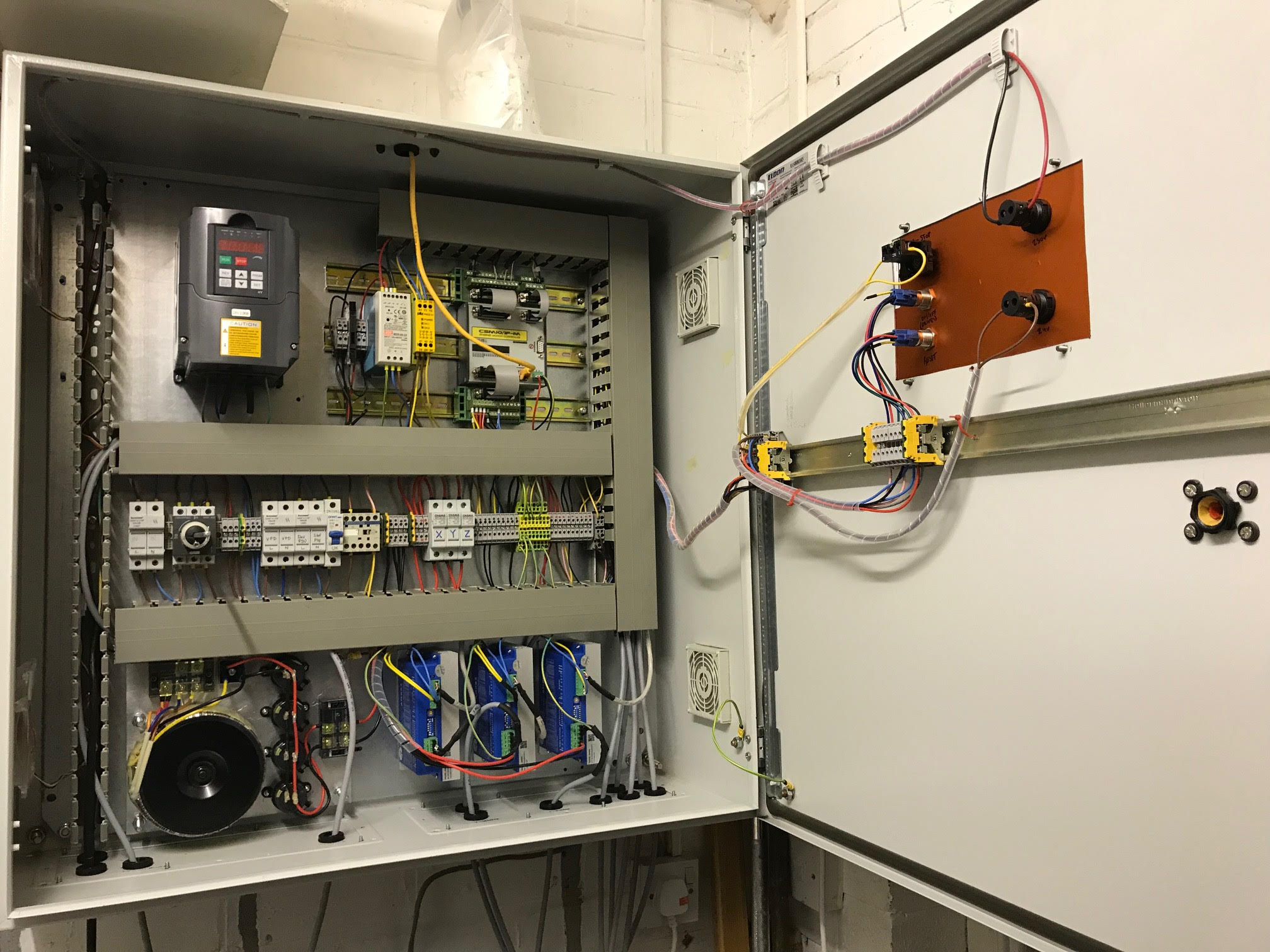

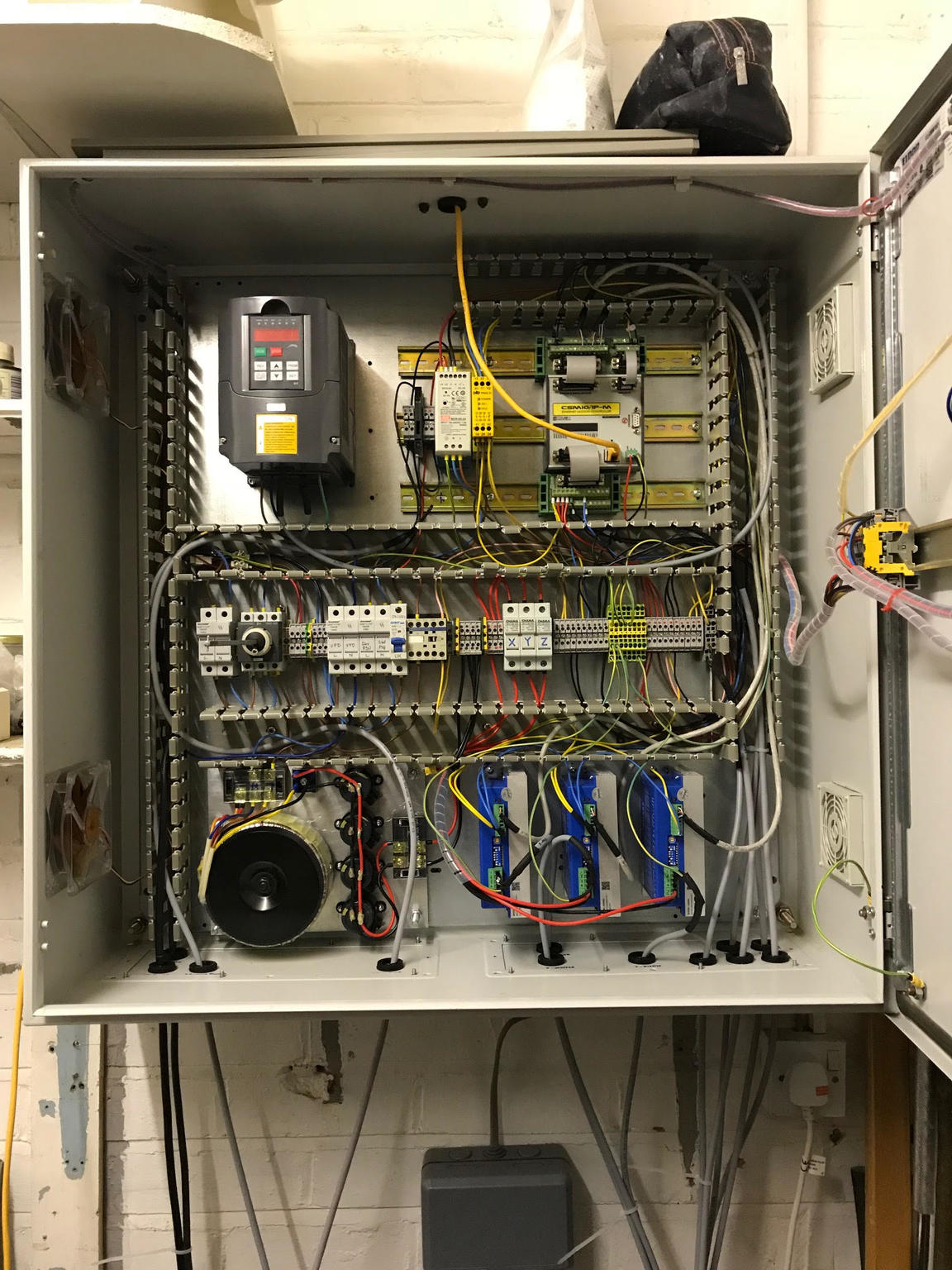

    Your electrical diagrams are awesome - can you point me towards the software you used?
    Your cabinet looks pretty decently sized for the layout - could you share the dimensions? Would you go bigger/smaller if you did it again?

    Hi Andy, I have an updated circuit diagram that I will upload as I had a few mistakes on the last one... take it with a pitch of salt though as I’m no expert!! I just used the cad software we use at work for the diagram, which is archicad. Not ideal but did the job ok!

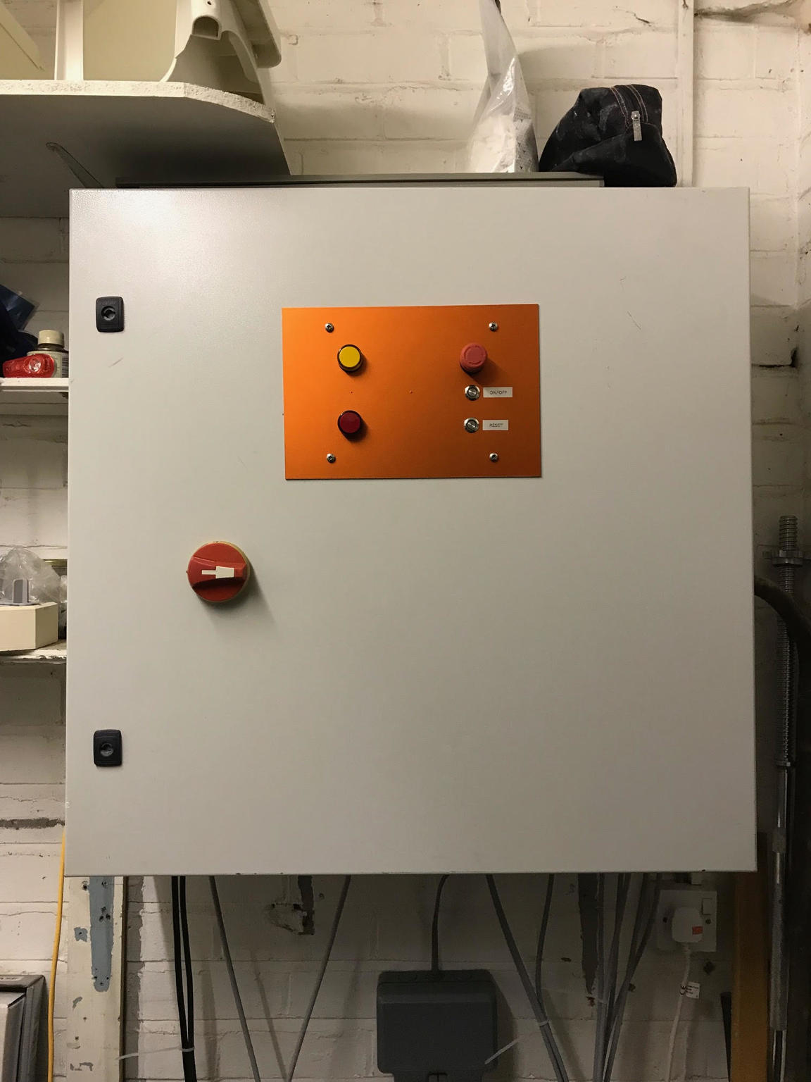

    The cabinet is a decent size, I got it second hand off eBay and it had a few bits in it and the rotary switch already installed. I’d defiantly go big if you have the space. I found mine to be about right. I’ll try and get some dims for you.

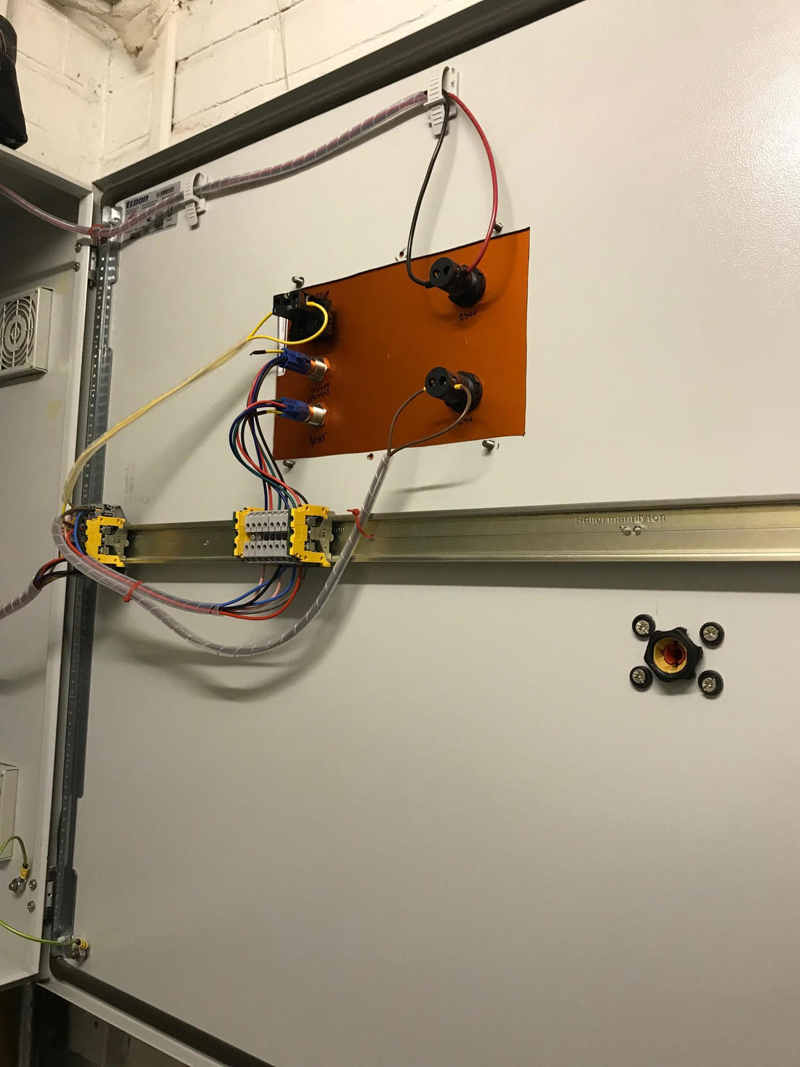

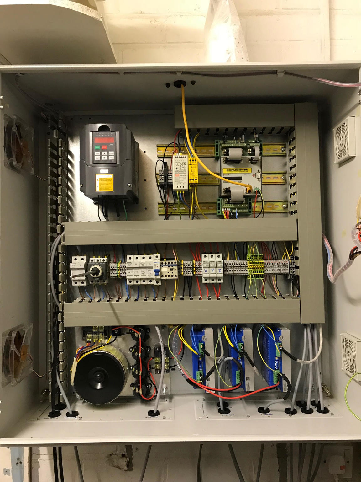

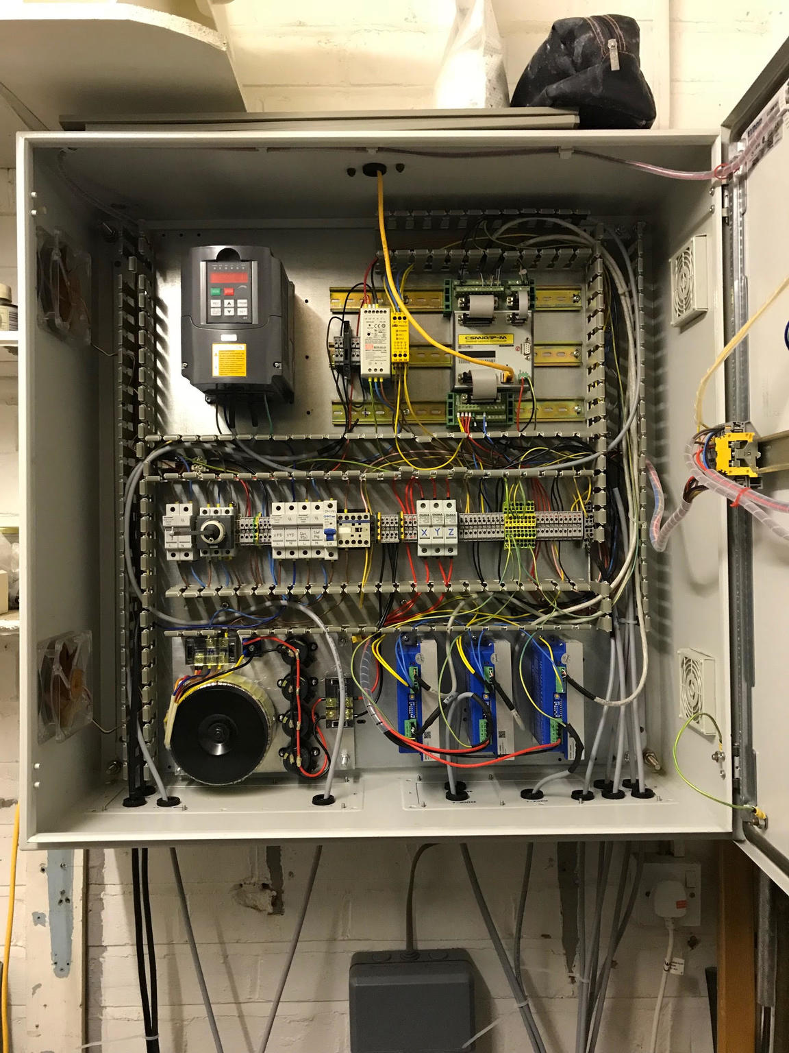

    Hi Andy,
    My cabinet is about 790 x 790 x 275 deep. As I said in previous posts, please take this circuit diagram as a guide as to how I have wired my machine - it is from research on here and other places and is not an expert guide and may not be best practice, correct or even safe!? It may also have mistakes in it. I found it useful looking at other peoples diagrams and that is why i'm uploading it, but please do your own and be sure in your own mind that everything is correct before you wire things up. I don't want to be blamed for that infamous magic smoke!!
    Joe
Name:	CNC Circuit Diagram.pdf

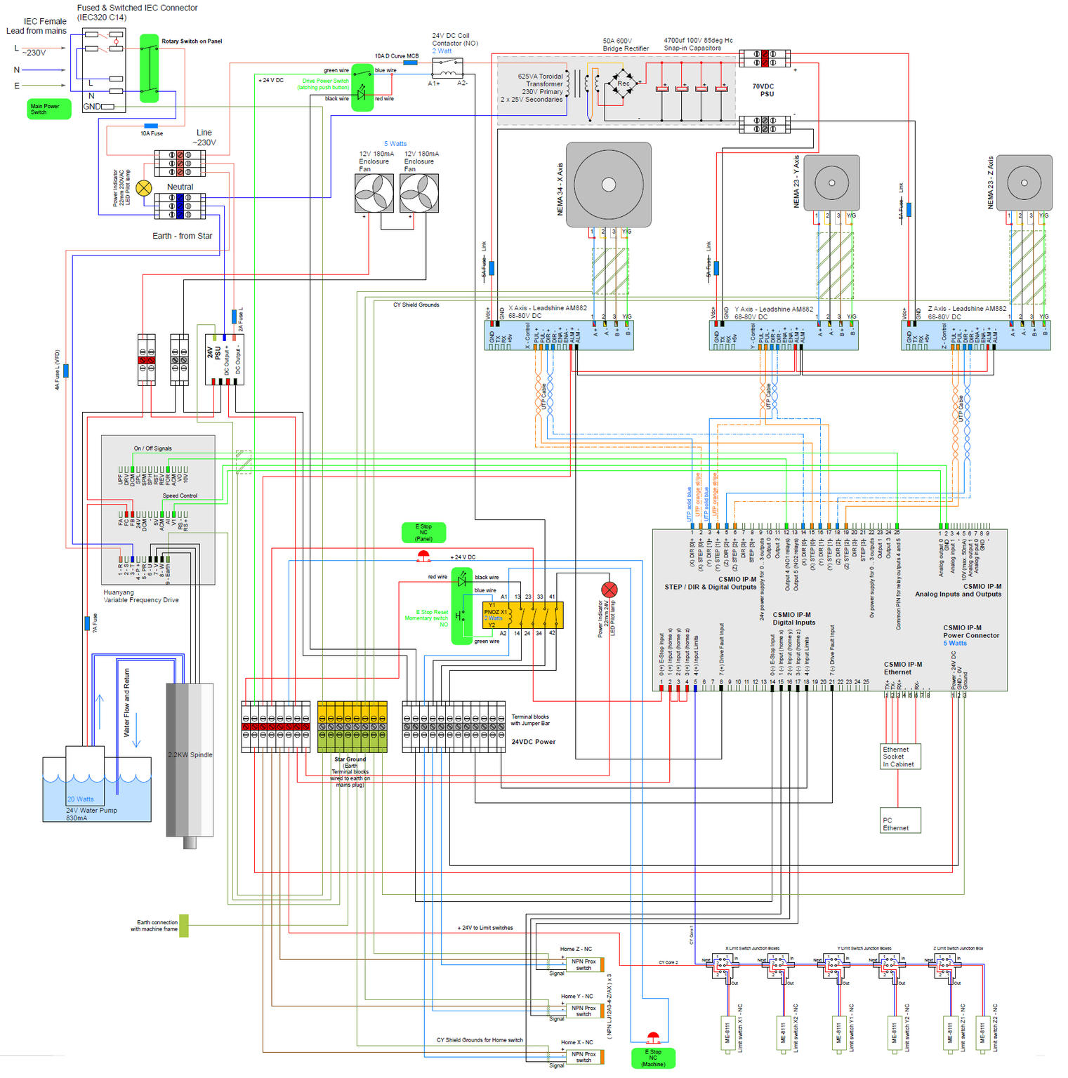

  9. #557
    after having a quick look at the wiring diagram
    I would consider wiring two 24V fans in parallel instead of having the two 12V fans in series
Name:	CNC Circuit Diagram 24v fan ver.jpg
    not sure about the long term reliability of running fans in series
    John

  10. Quote Originally Posted by john swift View Post
    John
    Fair comment John, I was just working with what I had already.

    Neat control box and design!

    Quote Originally Posted by JoeHarris View Post
    Hi Andy,
    Joe
    Thanks Joe, that's extremely helpful.
    Don't worry, I'll be sure to place a sticker on the inside of my cabinet that ensures any faults or issues are referred back to you! Any magic smoke captured will be posted directly to you - refunds are expected :)
    On a serious note though - you're very correct to point that out :) I'll be cross referencing every connection to the manual, and redrawing from scratch for a different breakout board and axis layout.
