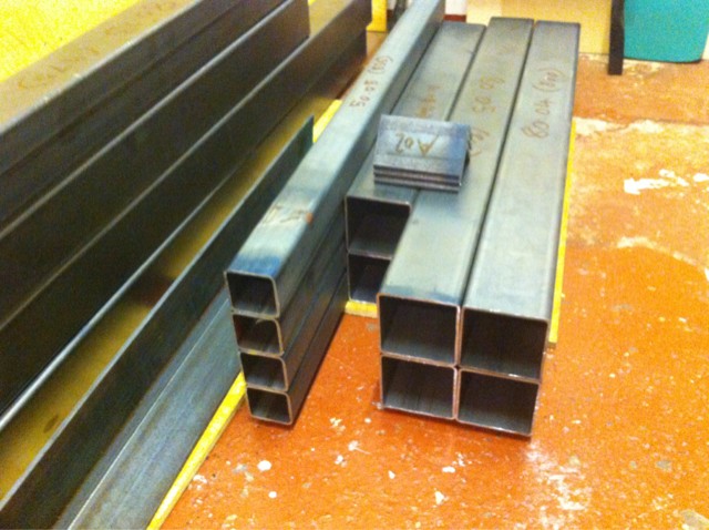

  3. Went and had a chat with chap at rotagrip (awesome collection of machines there) and seems my drill speed issue is only going to be solved by buying a better drill! Ah well.
    On happier note, feels like this is now becoming a build log rather than a drawing log - pics of progress so far (marking and cutting.)
    I am AMAZED by the rage2. 6mm plate and 80x80 box is child's play. Spend most of the evening sweeping up though!!

  4. Quote Originally Posted by JoeHarris View Post
    I know - i'm amazed by mine as well...i've been chomping through 10mm flat bar without any issues.
    What's even more surprising is the quality of cut. I got my steel yard to cut some of my steel to size for me on their large, fluid cooled automatic reciprocating saw thingummy...my cuts are smoother, more accurate & SQUARE in comparison to theirs...lesson learned :-p

    First parts drilled, tapped (and fit!) decided to weld plates to the inside of the box sections to increase thickness for tapping... Thanks Jazz for the idea
  10. A word of advice to anyone buying a tap wrench - don't buy a cheap eBay jobby like I did - they are crap. Just ordered the real deal from starrett... :) same applies with centre punches - buy a starrett you won't regret it!
