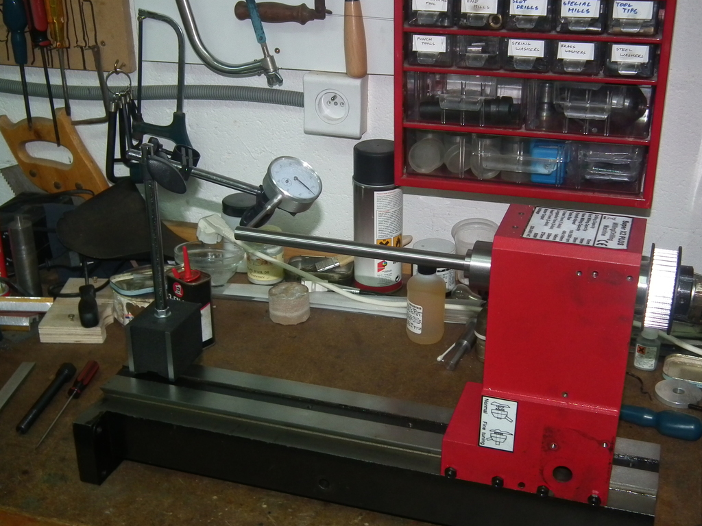

    Still making some progress if a bit slow. I've now fettled the column dovetails (they weren't too bad really) and made the same mod to the gib screws as for the X and Y. It all works smoothly now.

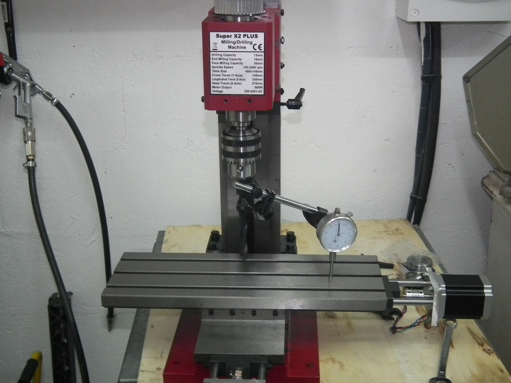

    Checked the alignment of the spindle to the column:
    .. found the spindle is parallel to thee column within 2 thou over 8 in. However the head is skewed giving 20 thou variation in 8 in when measured as above. I'll have to separate the two head castings and re-align.

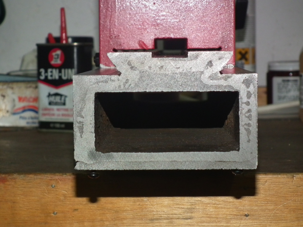

  2. #22
    Russell,
    That last picture, any chance of a shot of the column from the top looking down inside ?
    Mine has the original wet noodle tilting column, only a couple made this way before we designed the fixed column. Unfortunately my fixed column is in customs somewhere.
    Just wondering if the rack groove could be deepened ?
    John S -
  3. #23
    John,
    Picture from top of column:
    Yes the groove could be deepened by up to 10mm bringing the thickness to the same as the rest of the walls. This would enable the ballscrew to move back but the motor still won't clear the pulley on top unless a smaller one is used (I currently have 40T and 20T on the motor).
    BTW the column section on my file "z-axis plan.dxf", see my post about a week ago, is to scale.
    Hmm... it could just fit with a 30T pulley. Would there be any danger of the column distorting if that much is removed? I don't know how well the column has been stress relieved.
    Russell.

  6. #26
    Quote Originally Posted by ian823478 View Post
    Have you had a chance to address the misalignment yet? I have the same problem but am living with it at the moment. Any experience you can pass on will be gratefully received!
    Yes, not a real problem. I took the head off the column, loosened the four bolts that hold the two parts together but kept them tight enough so that the friction was enough for them not to slip in handling, then put it back on the column. Then tap the head with a hide hammer until the test bar showed no (or little) dial movement when moving the head along the column. It took half a dozen taps and tests to get it right. Took the head off, tightened the bolts and tested again. The misalignment is now just under 2 thou along 8 inches of Z movement.
    Russell.

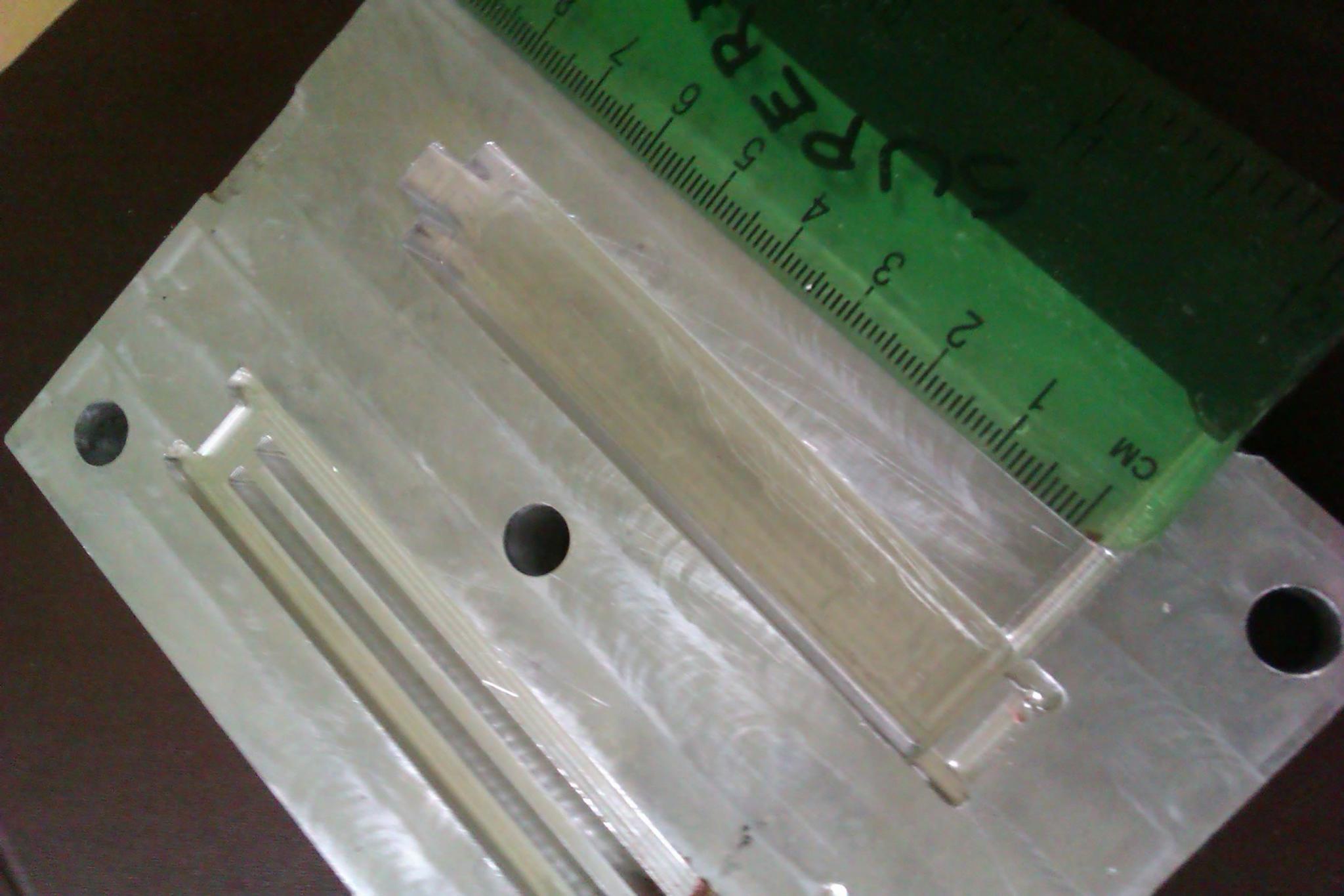

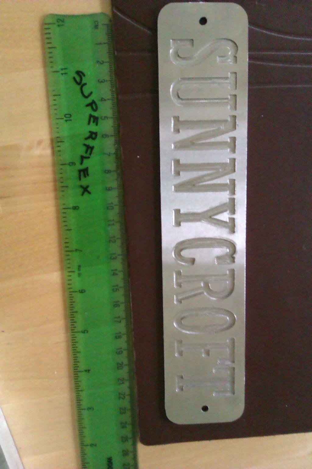

    Hi Russell. It seems to be accurate to at least 0.1mm as far as I can tell, probably nearer 0.05mm. I have a counterweight on the head and the gib reasonably tight.
    I mainly cut aluminium but had a play with some 304SS over the weekend. Here's a couple of pics (if I can work out how to upload them.......)
Name:	aluminium mould.jpg
ID:	6228Click image for larger version.
    Cutting the stainless was painfully slow (10mm/min 1mm DOC with a 2.5mm slot drill) but that was to prevent heat buildup (no coolant and just HSS bits). I've definitely got a lot to learn and loads of tools etc to save up for!

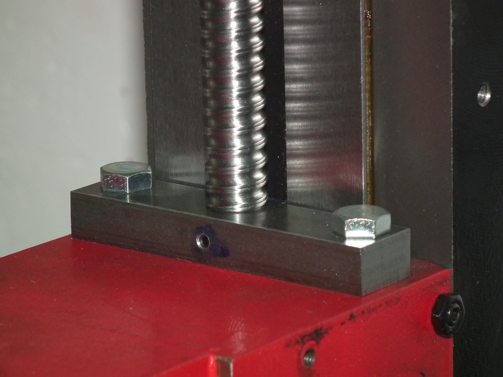

    I've drilled and tapped the column for the ballnut mounting and also at the back to lower the electronics enclosure to make room for the stepper motor.
    Bolted the column in place and fitted the head to check the alignment of the column:
    The side to side alignment was good at less than 1thou over 8 in. However the front to back alignment was out by 5 thou over the width of the table. I corrected this by fitting shims ( a few layers of kitchen foil) at the front edge of the column mount. OK., I know I should have filed and scraped the mounting pads but fitting shims was easier.

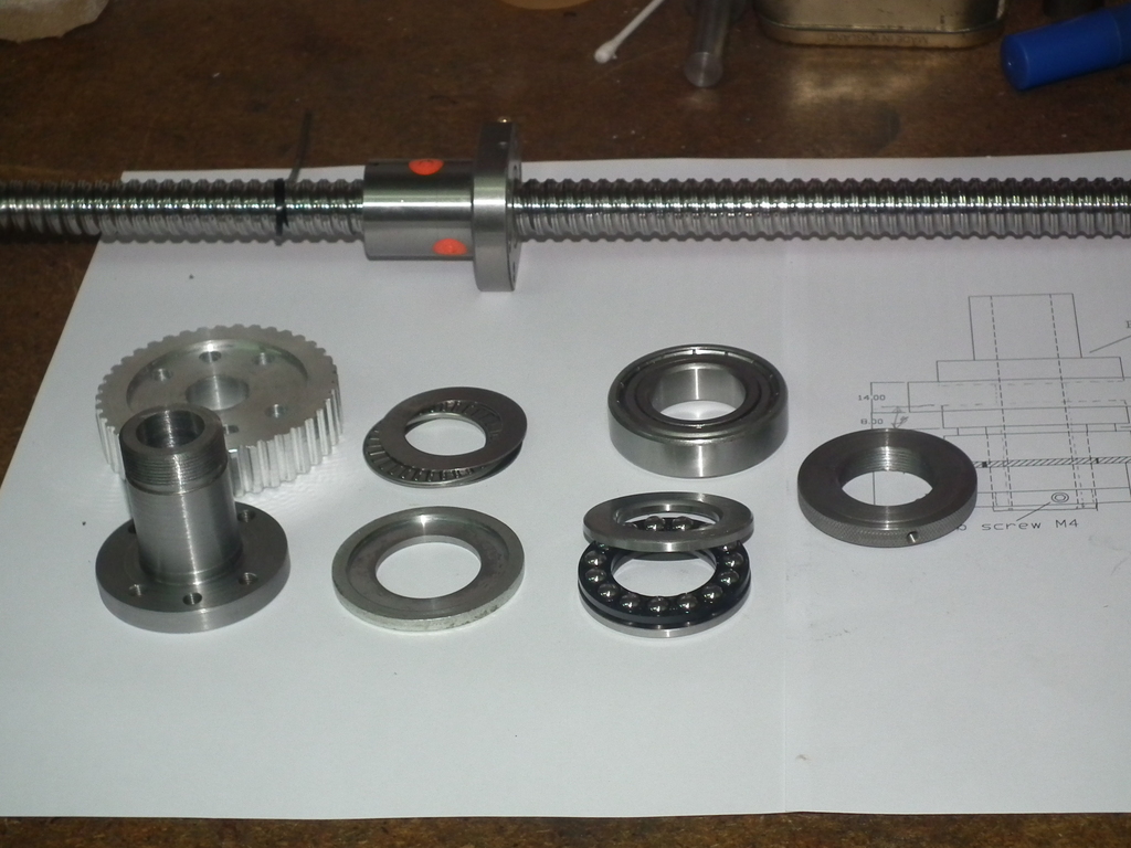

    I had originally intended to use an angular contact ball bearing in the ballnut assembly but couldn't find a suitable one so I used a normal bearing backed up with a needle roller thrust bearing like this:
    ballnut_assy.dfx The spacer is to ensure that the thrust from the thrust bearing is taken on the outer race of the ball bearing.
    Note also that I have threaded the end of the bush and made an adjusting collar (again with a grubscrew to lock it) to allow the preload on the thrust bearings to be adjusted. This isn't very well detailed on the drawing but can be seen in the picture of the parts:

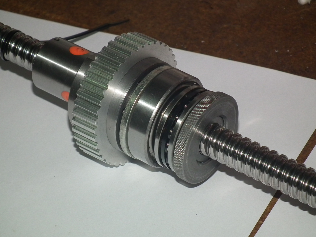

    Finally the parts assembled:
    Just have to make the support now.
