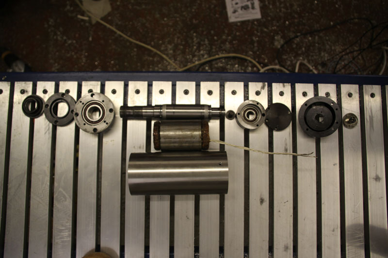

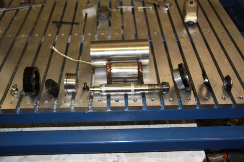

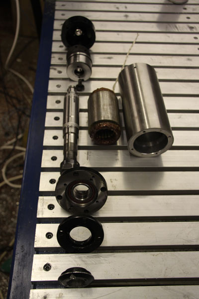

    Yes I have striped one and no they wont because of the way the rotor is part of the collet shaft.
    The different spindle KW and ER sizes etc make them completely different so therefore not interchangable.
    The ER shafts you link to are not replacenments but more extensions and adapters for drilling machines etc or building your own spindle. One of them is MT2 to ER adapter used on mills and lathes.
    Here's some pics of a 2.2KW I killed.!!

    I can confirm Jazzcnc statement. The chuck is integral with the main motor shaft. I have noth 0.8 kw and 2.2 kw and you just use whatever is on the end.

    My own silly fault, I'd had the spindle off a few times to check fit for some mounts I'd made for someone and didn't fasten the cable guide correctly, So over time the connector was bending and snapped wire inside main connector at the spindle causing dead short and great big blue flash.!!!!!. . . . . Killed both spindle and ABB350 VFD stone dead. .
