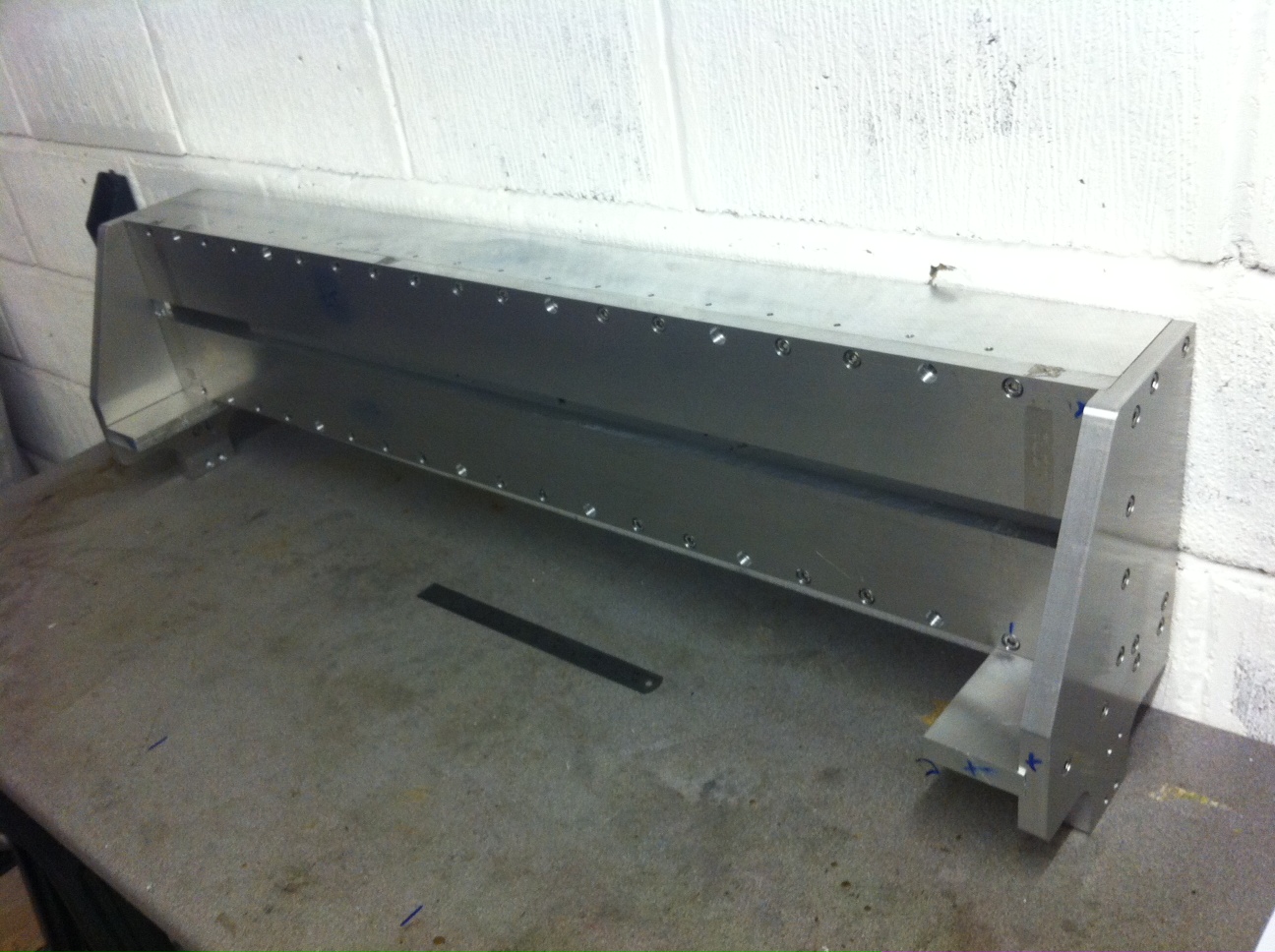

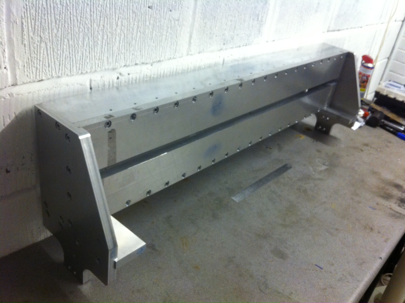

  5. #95
    So......
    A fair bit of work this weekend and the basic frame of the gantry is done. Lots of measuring 4 times and drilling once but its all worked out really well everything is nice and square and meets up well could not be more pleased.
    I have to say a big thank you to Jonathan for organising for the gantry sides to be cut so quickly, collected this morning and on the gantry by this eve.
    Now its started I dont think I will be out of the workshop for a while, good job the missus has gone to South Africa for two weeks!

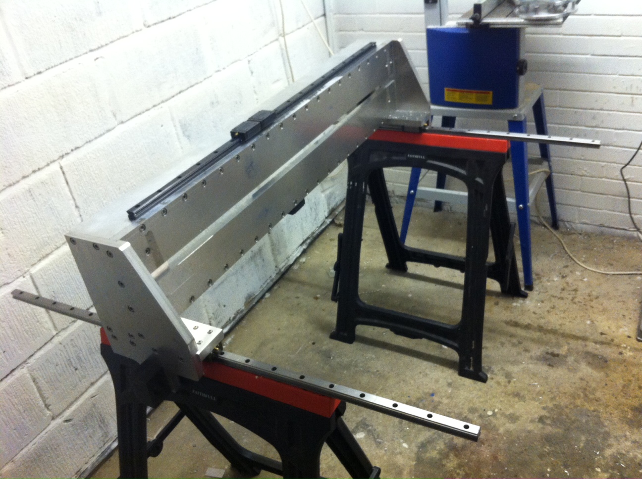

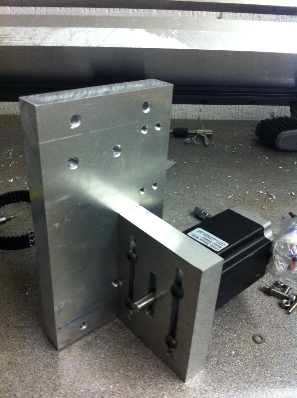

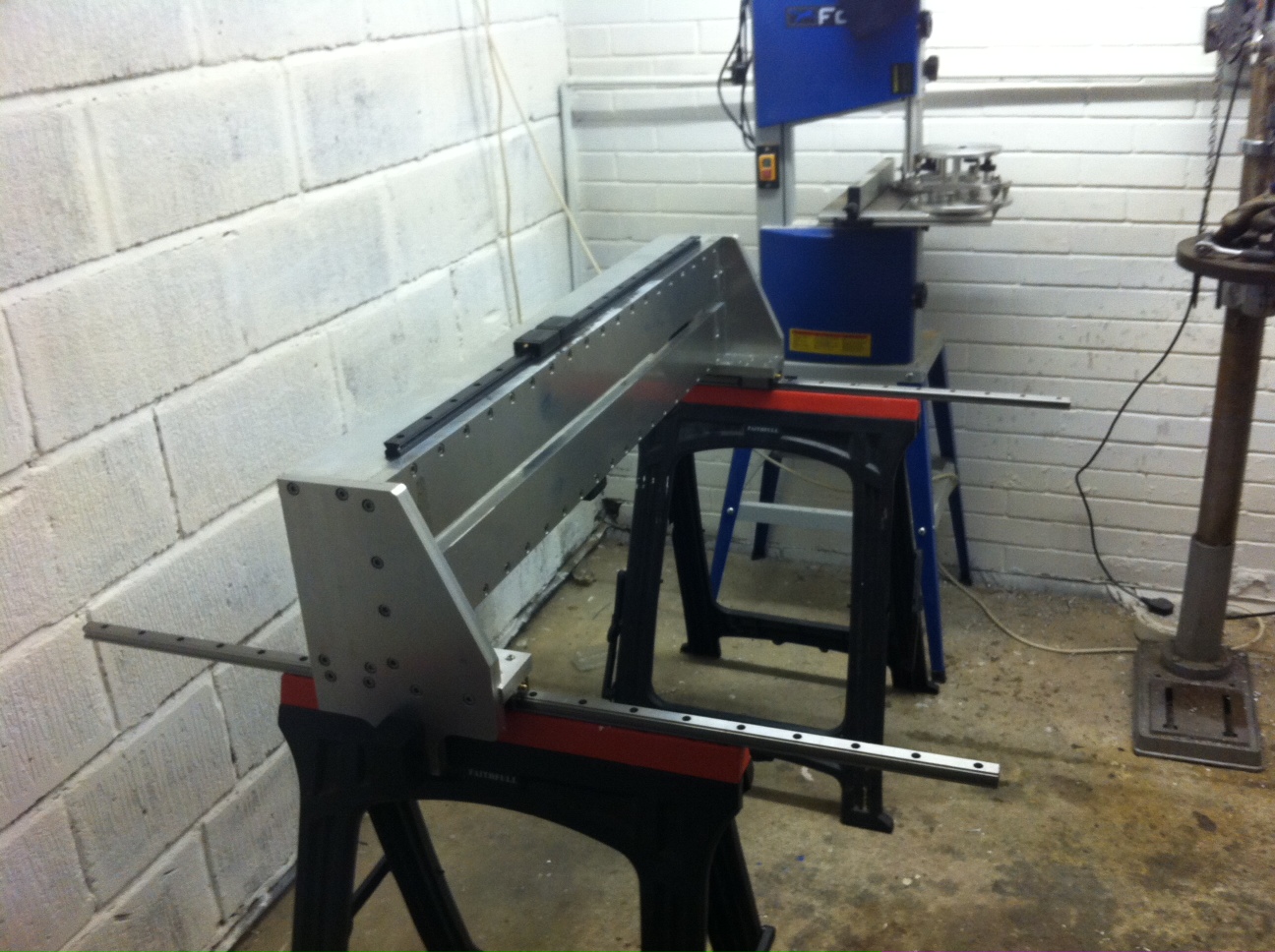

  6. #96
    Another weekend of work and the gantry is really coming together now.
    Got the y axis ball screw fitted, motor mount machined and fitted inside the gantry, x axis bearing plates milled and drilled and test fit on the rails on some trestles.
    Looks like I need to get some more material together for the z axis!
    btw, the x rails are screwed onto the trestles I was a bit concerned one side might just fall off!

  7. #97
    Did you really need to over build the base frame that much and how do you plan to attach the ballscrews and motors to the trestles.?. . . . Lol
    Looking Good Francis sorry I was too busy to help with machining but looks like it's coming along nicely, keep up the good work. .
  8. #98
    probably not but I can always have the parts out and pocket sections of the parts which dont need quite as much strength in the future.
    Thanks for all the init and I know your busy so its not a problem :) hopefully it keeps going as smoothly.
  9. #99
    That is one meaty and sturdy gantry and quite a good design.
  10. #100
    i cannot take credit for the design - well other than my version of...... it was a design jazz put up ages ago that I took the cues from
