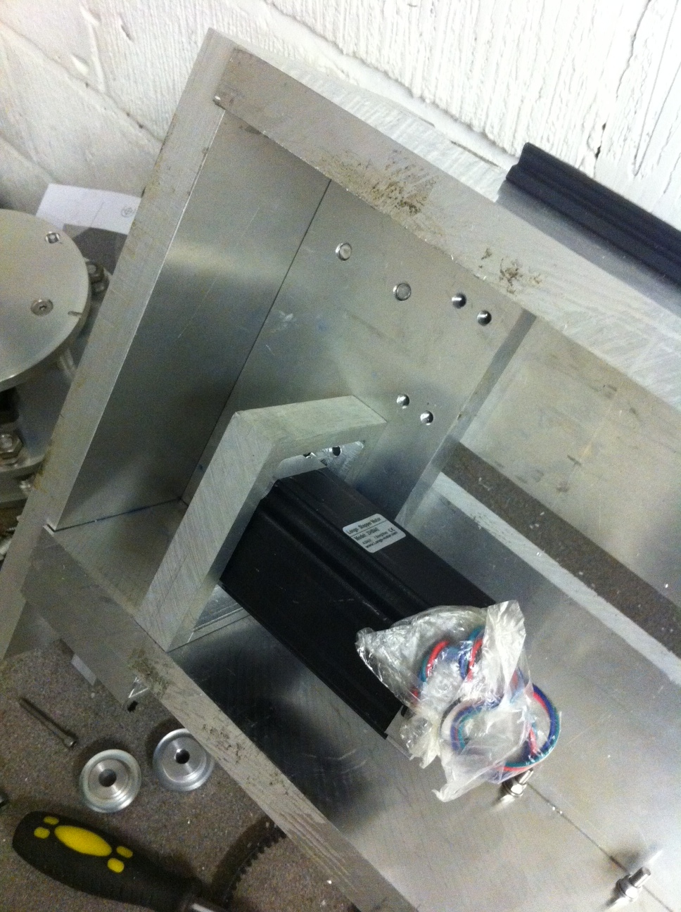

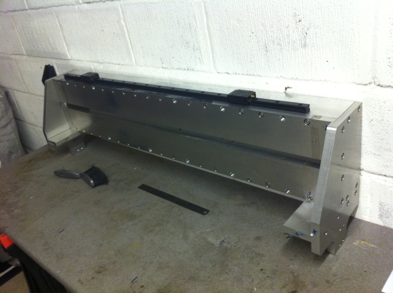

  6. #96
    Another weekend of work and the gantry is really coming together now.
    Got the y axis ball screw fitted, motor mount machined and fitted inside the gantry, x axis bearing plates milled and drilled and test fit on the rails on some trestles.
    Looks like I need to get some more material together for the z axis!
    btw, the x rails are screwed onto the trestles I was a bit concerned one side might just fall off!

  7. #97
    Did you really need to over build the base frame that much and how do you plan to attach the ballscrews and motors to the trestles.?. . . . Lol
    Looking Good Francis sorry I was too busy to help with machining but looks like it's coming along nicely, keep up the good work. .
  8. #98
    probably not but I can always have the parts out and pocket sections of the parts which dont need quite as much strength in the future.
    Thanks for all the init and I know your busy so its not a problem :) hopefully it keeps going as smoothly.
  9. #99
    That is one meaty and sturdy gantry and quite a good design.
  10. #100
    i cannot take credit for the design - well other than my version of...... it was a design jazz put up ages ago that I took the cues from
