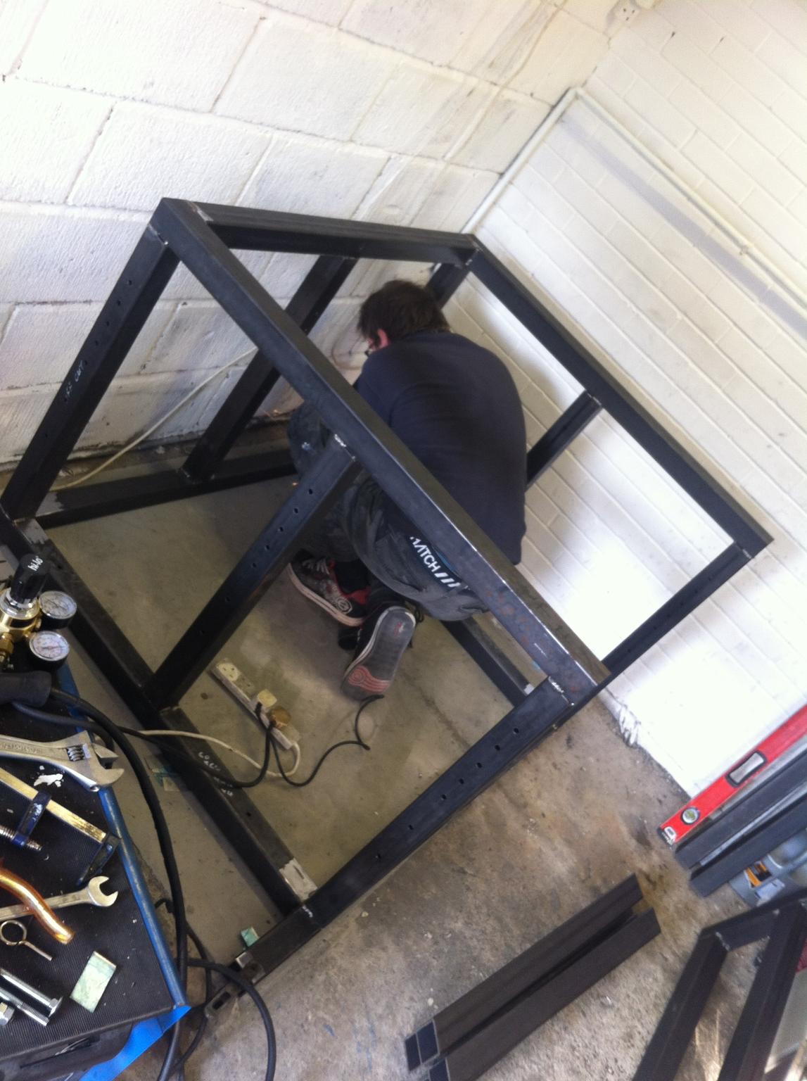

    Managed to get a bunch done today which was great!
    Earlier this week I had some deliveries in the form of a 3kw spindle and inverter, some west system epoxy and extra slow hardener, some more aluminium plate and a few more essentials to move this project along a bit more.
    I started out today machining up a mount for the x axis drive motor which is going to be driving 2 screws with one motor so needed a good mount and also space for a good tensioning system. The parts for the tensioners only arrived this afternoon so I have not had a chance to add those yet but they will be going on the taller part of the mount that the nema 34 motor is attached to.
    I have managed to get some heat into the workshop so on sunday I am going to get the epoxy resin poured. Any tips? I have read most of the builds using this and I am sure if I follow those steps everything will work out fine! (heres hoping)
    Finally I did not order enough aluminium for the spindle mount so mocked 2 plates up out of polycarbonate I had lying around and fitted that on to make sure I could get at everything for adjusting etc. So far so good all looking great, just need to spend saturday on the X axis mounting blocks and the timing pulleys and should be about there ready to pour the epoxy.
    One last thing do people recommend drilling the x axis rail mounting holes before or after pouring the epoxy?

  8. #7
    Quote Originally Posted by fvfdrums View Post
    Do it after the pour it drills easy and doesn't cause any problems.
    One word of warning with the epoxy and this cold weather.? I've just done a pour using 206 hardener which is faster curing and in a thermasticly heated workshop and after being left 5 days I still got a little sinkage after fastening rails. Nothing major but still enough to need a slight shim to avoid putting bind on the bearings.
    Using the 209 I wouldn't touch yours for at least 10days. If you have any spare epoxy pour a little into something to simulate the width and depth your doing and then wait until it's gone hard so snaps when trying to bend. If it bends and doesn't break it's not ready. The surface will feel hard to touch but it won't be cured all way thru.
