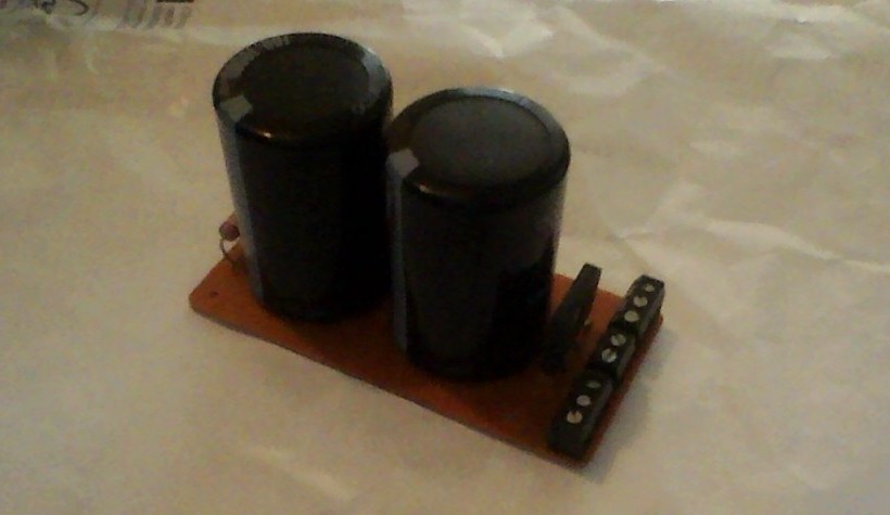

You might find it cheaper to get multiple smaller caps, I got 4 x 4700uF ones for a few pounds each, just means more connections to make...

Aliexpress is your friend for cheap capacitors, and just about anything really:
http://www.aliexpress.com/wholesale?...t=10000uf+100v
You need to be wary of fakes - I got these as they were the cheapest at the time and they're fine. On the lower end of the tolerance but that's not a big deal for what we're doing.
