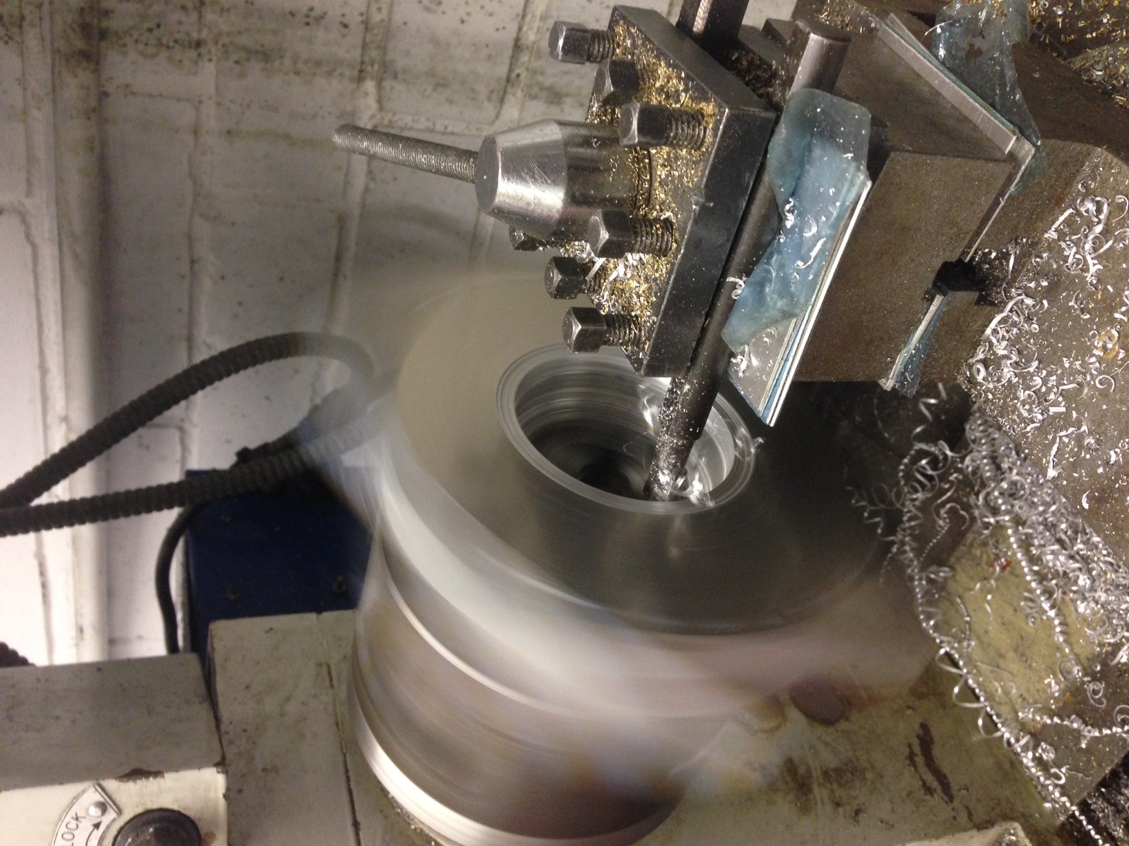

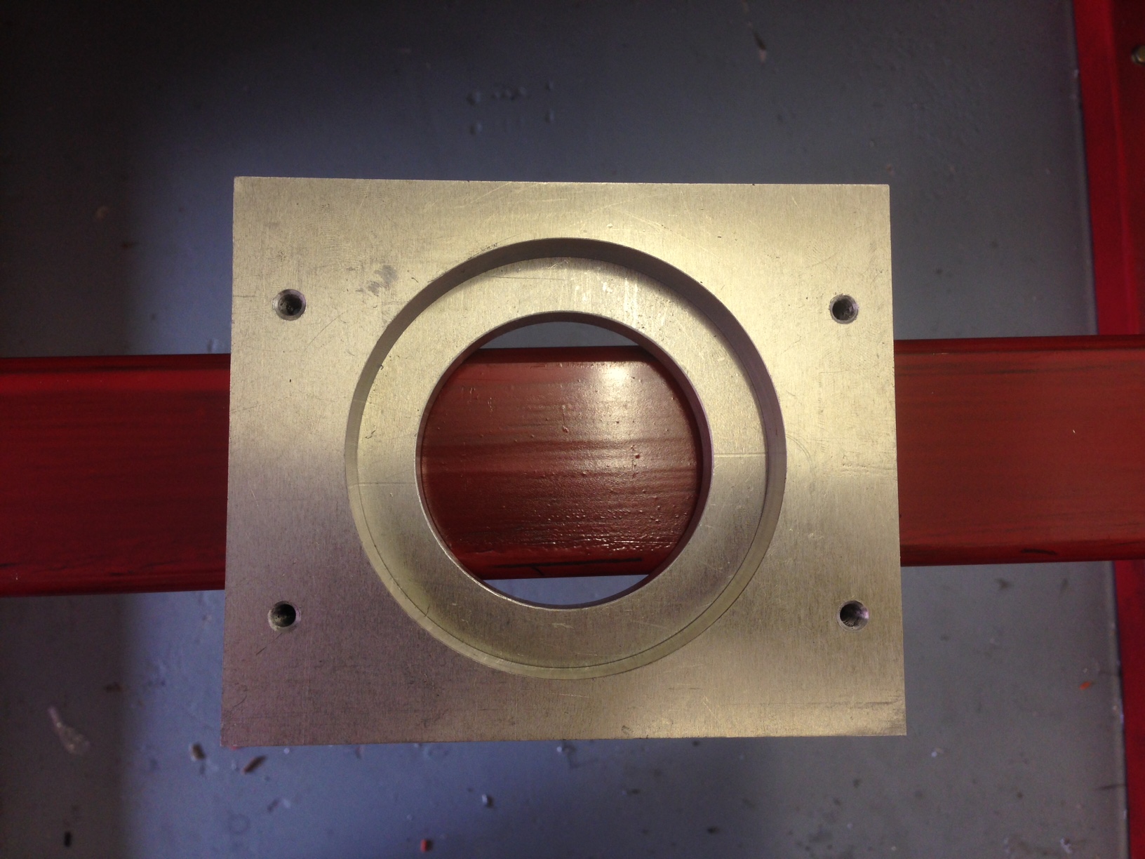

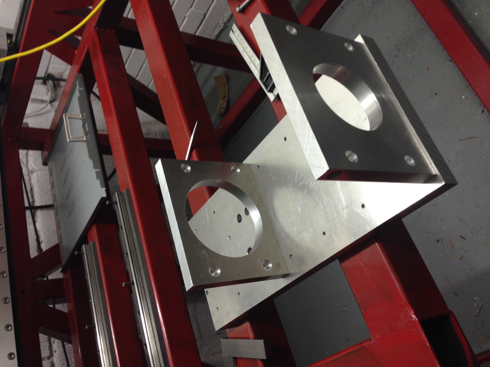

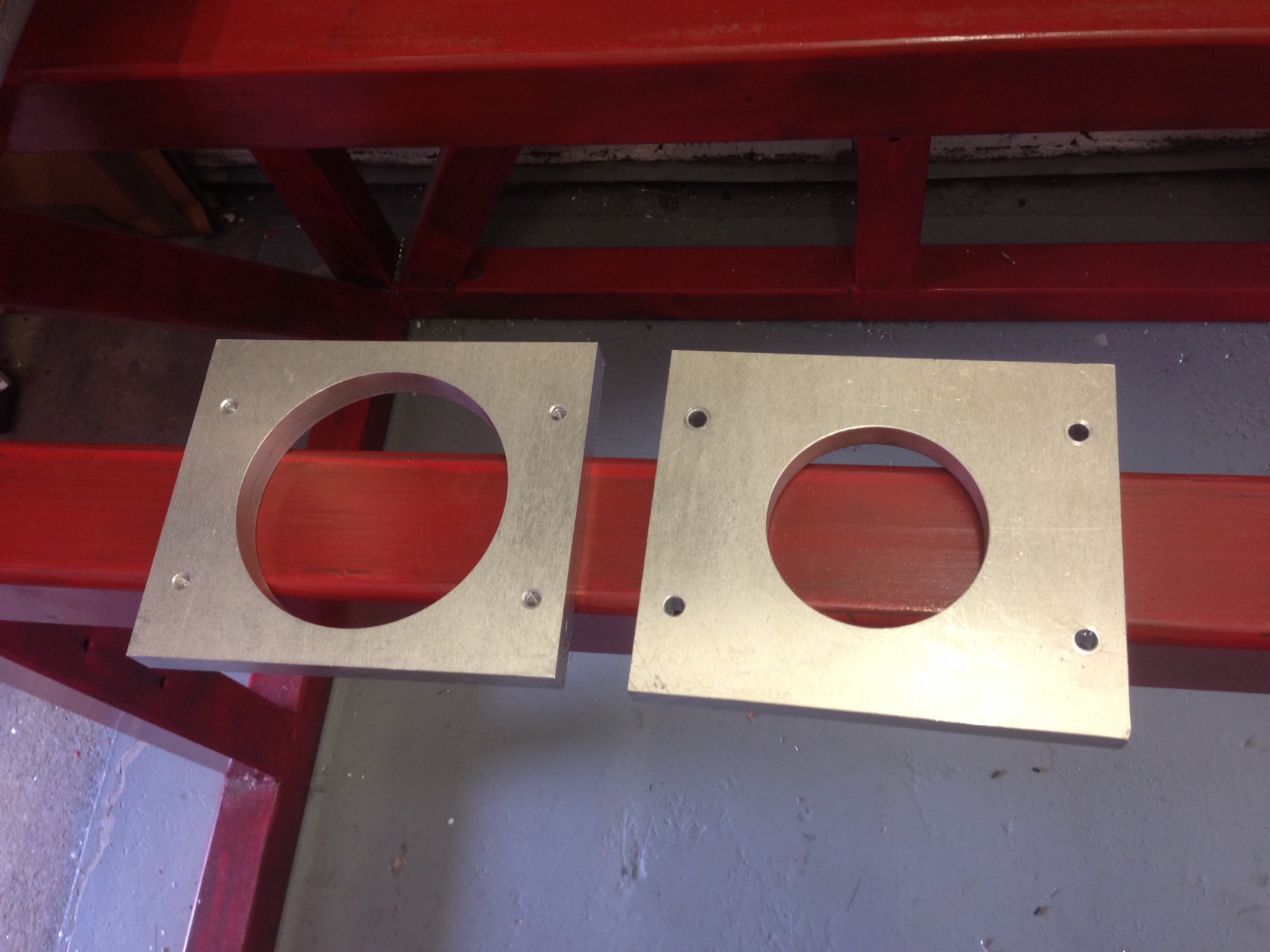

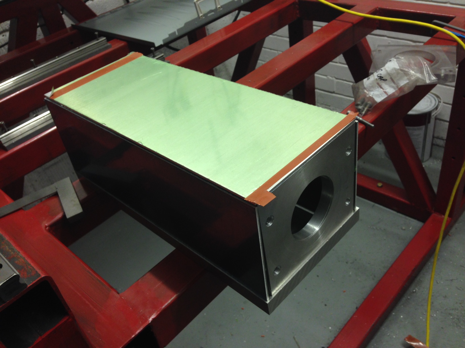

    So I spent yesterday dismantling the z axis as I knew there were a few things I needed to take care of before I was happy to say that was done. One of them being some proper mounts for the spindle being as the ones on there were temporary polycarb ones.
    I have drilled the plates for the pinch bolt just have not put the slot in it yet so I will be doing that shortly however I wanted to get all the covers made up whilst it was off the machine and easy to access.
    I have also put in place the holes for the internal pipes I am putting in for the coolant / mist / blower system - more on this to come but there will be 4 small heads which will direct the air/mist relevant to the path of the cut as the machine moves around. Similar to the datron system Dean pointed out earlier in the thread. Currently waiting on some solenoid valves to turn up for this so I thought I would prep the pieces ready.

    Francis is that a cover your putting over the spindle. If so why.? . . . . Covering the whole Z axis is a good idea as it keeps debris out of screws and rails etc but I wouldn't cover spindle as it traps in heat causng cooling/pump to work harder and potential for heat expansion.
  6. #266
    Especially true if you forget to switch on the pump or if hardwired like mine, it switches off for some reason and you don't see it. I have made a habit to check temp with hand.

    Thanks for the advice once again. My intention is that the top section above the spindle is going to house the "controls" for the cooling/misting system. There will be vents in the housing once finished covered with a mesh to allow air in and out but due to the "other" bits in there I wanted to try and keep it clean.
    I will however keep an eye on it all and monitor the temp of the unit. I was already planning a digital temp readout on the control panel so one for the spindle is no additional problem.
