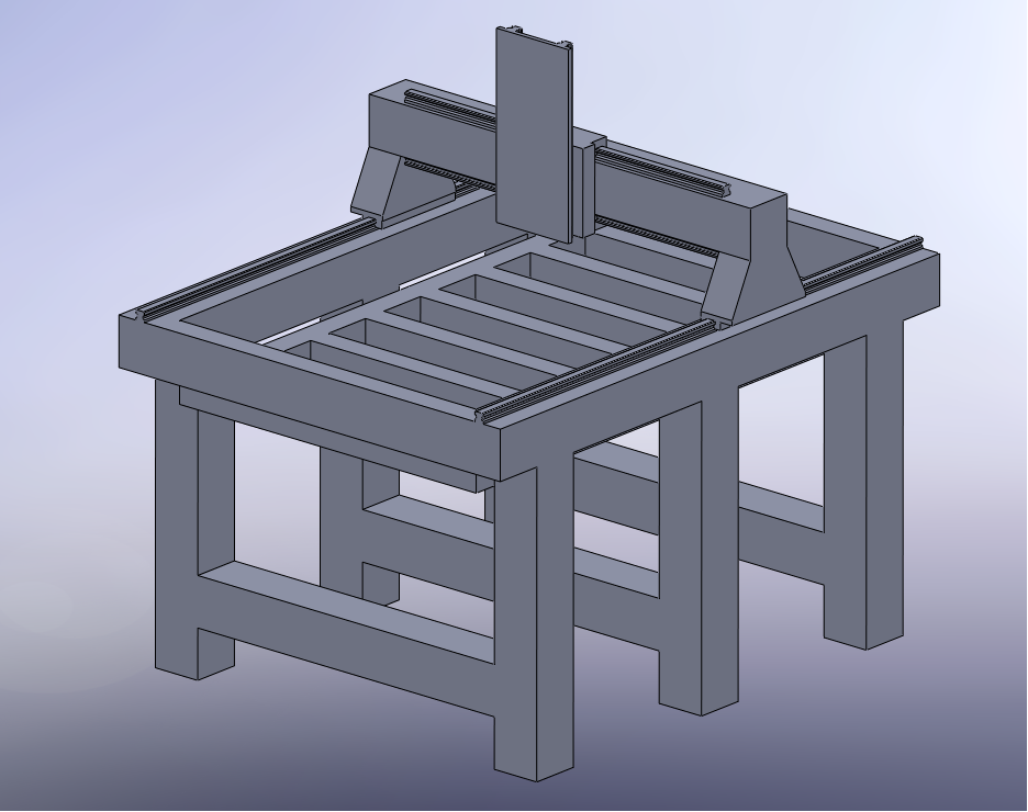

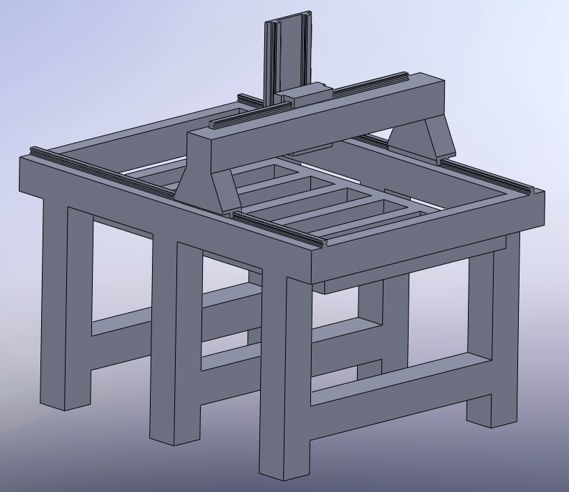

    Ok I'm going with profile rails on all x,y & z 4 blocks on each rail.
    My thoughts are going towards a low level gantry eg minimum deflection in relation to the x axis with the adjustability of the bed. I have access to a fair bit of 100mmx100mm off cuts and was thinking of using this as the base for the machine. Would this be too extreme for the gantry?
  8. #18
    Quote Originally Posted by fvfdrums View Post
    Excellent. Nothing's too extreme. The worst that will happen is you might need bigger motors, or have to accept lower feedrates (which is irrelevant for aluminium cutting). Design the machine then select the electrics to suit. Don't start trying to make things lighter to optimise the feedrate since a rigid slower machine is much better than a fast weak one.
  9. #19
    Completely 100% agree on both counts. . . . If you then filled it with concrete you still wouldn't be extreme, Infact if you mainly intend cutting Aluminium I recommend you do exactly that has it makes a big difference to resonance and quality of finish.!!
  10. #20
    Right I have had an hour to play in solidworks so this is not very detailed its just an outline of the idea I am thinking of once I have ironed out any potential problems I will go in a bit more detail.
    So once again 1200mm x 800mm bed current z axis 200mm ? good bad ugly?
    z axis is based on 4 blocks sitting on a 200mm square footprint eg one on each corner of a 200mm square.
    Adjustable bed for altering depths of material / things to machine.
    twin ballscrew on the x axis, single on the y and z
    concrete/ sand etc in the box section taken on board I will give that a go.
