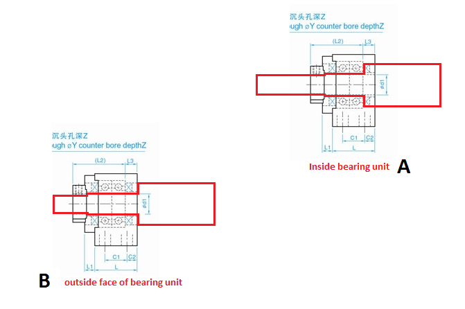

    If I am not mistaken it is more like B but there is a little spacer at each end of the bearing so that the ball screw does not squash the rubber seals. Be in mind that you will have a bit of free movement at the BF end as the bearing can float in it, say about 3mm. ..Clive
    You're not mistaken :)
    Thanks for the replies, I also had one from Chai and confirmed the same thing I am actually planning on using the bk12 on both ends so wanted to make sure where the ball screw ended in relation to the placement of the bearing blocks.

    There's two reason to use angular contact bearings (bk12) on both ends of the screw. One reason is it increases the axial stiffness of the screw, since you have twice the number of bearings supporting it. The other reason is it raises the critical speed of the screw, so you can spin it faster without it whipping. For the vast majority of DIY builds, the stiffness of the screw is at least an order of magnitude greater than other parts in the axis, so you're unlikely to see a tangible gain from doing so. The critical speed however is important, but for the 1610 screw you've chosen you'll be able to get good feedrates so long as the screw is no longer than 1500mm. According to an earlier post ('1200x900 footprint area with approx 1000 x 800 cutting area'), your machine is well below this length so using two BK supports on each screw will only increase cost with no useful gain.
    (Search on google for 'Ballscrew stiffness calculation' and 'ballscrew critical speed calculator' if you want a reference for the above.)
