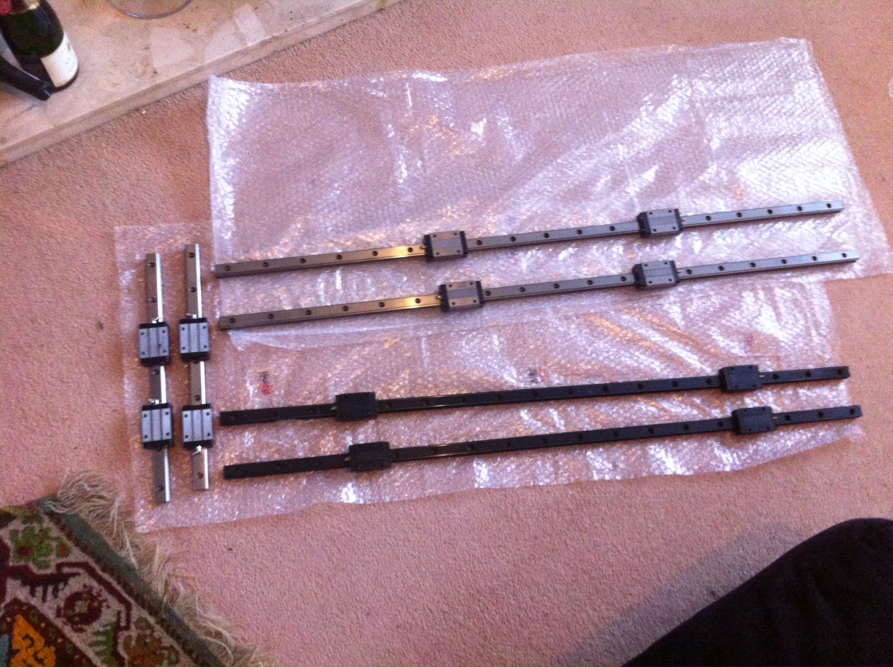

    Ok, so today started with me making a 5 mile trek with these linear bearings on my shoulders all the way across nottingham becuase the other half has the car and is away for a week and there was no one around to grab a lift from (I know I could have got a taxi but that would have been some of the cnc fund ;) ) Anyway I would not recommend it.
    Having said all that when I finally got back home and inspected the package it was extremely well packaged and I would not hesitate from ordering from FA Systems from ebay again or recommending them. They were extremely easy to deal with even had a bit of negotitations with them for a better deal on price and postage and they arrived in 5 days from Korea. I got stung for a little Import duty but overall it was a great deal.
    The bearings themselves hardly look used, they are well greased and run smoothly up and down the rails which also are mark free so all in all very happy indeed.
    @ Mike - Thanks for the offer but I have just placed an order with Chai so I already have these parts on the way otherwise I would have been in touch. I look forward to seeing your build come together.
    So due to the dimensions of the rails it has meant we have a slightly different sized machine now, its 1130 x 1060 with a cutting area of 940 x 940. The redesign of the machine is going well and even though I would have rather had the original files to work from its bee refreshing to tackle the design from the ground up and incorporate some of the great ideas people have come up with over the last year since I put the original together.
