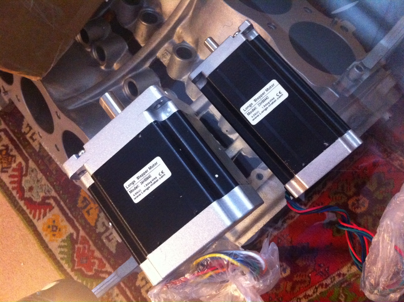

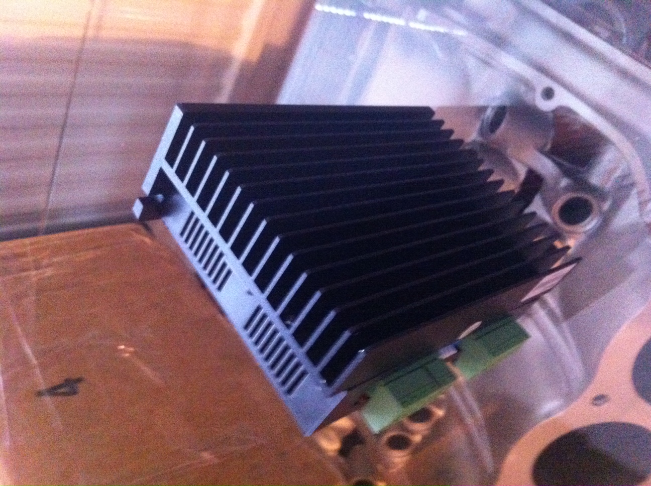

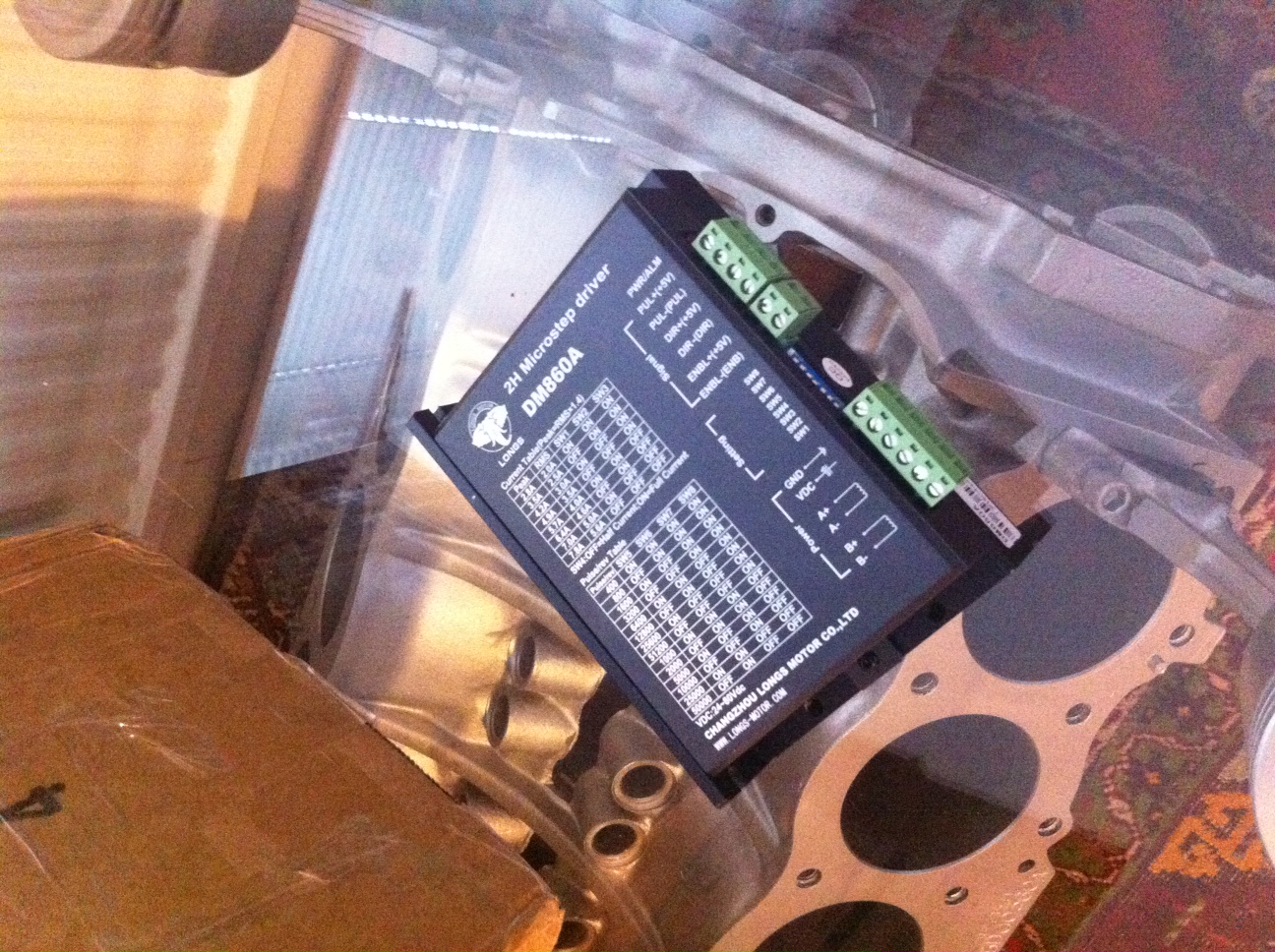

    Motors and Drivers have just arrived. Well packaged and look good so one more package to come from Chai and I can start on the Gantry. I would just rather have the parts with me to measure from before I start drilling and cutting.
    How long does Chai generally take to get things machined etc once the order has been placed? I know it takes 1-2 weeks to ship.

  11. #80
    Quote Originally Posted by fvfdrums View Post
    Can't tell you that but Usually arrive between 9-12 days from placing order. Often any delays comes from UK end.!!
    24T will work fine.
